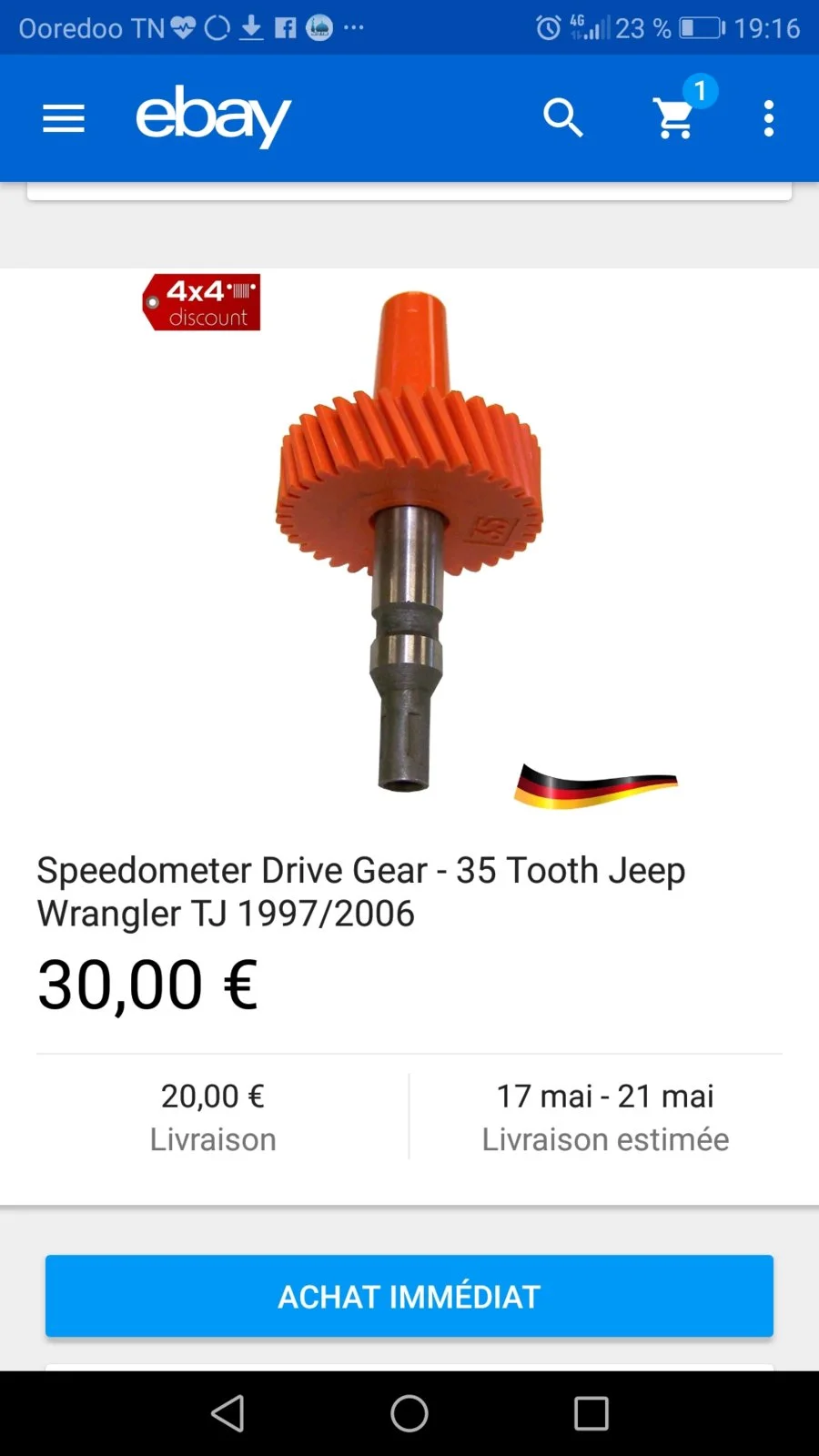

Thanks you again Jerry ...
Just to be sûre that I am not wrong... It's the orange speedo gear with 35 teeth for the rear axle... ? And for the front axle it should be the same...?
Thanks

For 33's and 4.10 gearing, you want a 36 tooth speedometer gear, not 35. The speedometer gear chart at http://www.4x4xplor.com/speedo.html is GPS verified and accurate. Yes the front and rear axles must be geared the same. Which includes the 4.10/4.11 combination the front and rear axles will end up with. The front and rear axle ratios are usually .01 apart due to the different ring gear diameters used in the front and rear axles. Only Rubicons with matching f/r Dana 44 axles have f/r axle ratios that match exactly.
I have your exact same setup. I put on 33”s, did an axle swap and put on 4.10 gears in the back. I got the orange 35 tooth speedo gear and everything is perfect. Did a SYE while I was at it.
I’m not sure how accurate my phone GPS speedometer app is, but my Jeep speed and GPS speed match no matter how fast I’m going.
