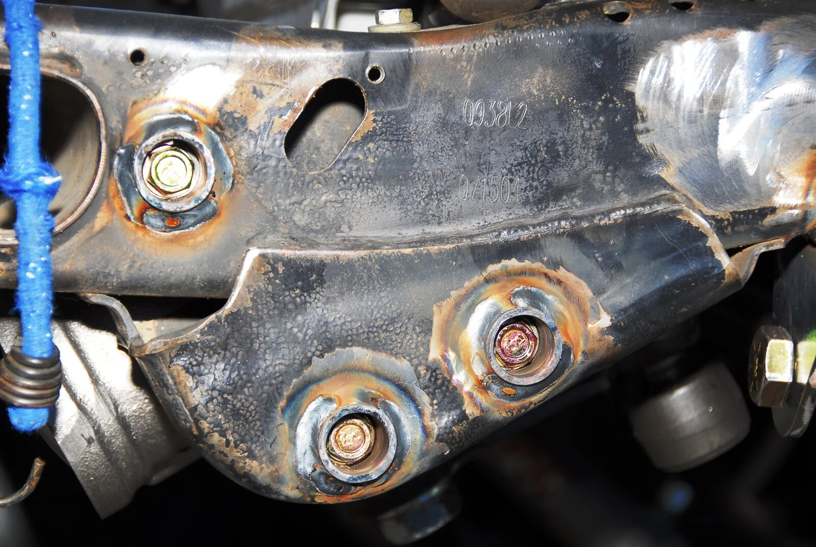

Seriously though, I just took a look at mine. I think the issue is the inner arm clearing the mounting bolts for the steering gear. After a quick measurement it looks like it would just clear, but my guess is that any side pressure on the arm would cause it to hit.
My feelings as well.
I already had plans on getting new stickers from Steve if it was possible. :)
MrBlaine's recessed steering bolts came to mind as I remember reading that thread.
Reactions: NashvilleTJ
Fair enough. I guess that only leaves the upside down logo as a problem….:)
If you remove the sticker then there is no upside down logo.
What was the reason you recessed the bolts there, Blaine?
We have had many issues with destroying the front AR arms in 3/8" thickness under high articulation. The solution was a stiffer arm in the 3/4" thickness out of aluminum they have for the rear AR. The reason they come in 3/8" is to clear the steering gear bolt heads. If the bolt heads are not in the way, you can run a thicker arm.

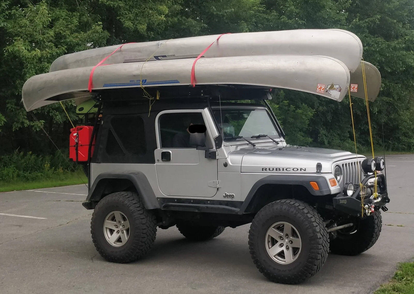

I have also had all three, and I concur with the above. I wish I had gone straight to the Swayloc when I added a lift instead of the Antirock.
Even with three 70 lb canoes, another 100 lbs of other gear on the roof rack, full gas cans, a full rear cargo rack, gear shoved in every crevice, and 4 adult passengers, it helps minimize body roll especially on the freeway.
I will caution you that it will not stop you from lifting the front left tire on tight turns, but it will reduce how far up it goes.
I do also have airbags in all four coils which also makes a significant impact, but more so on the weight squat and braking/acceleration dive than roll.
What brand of rack is that?
