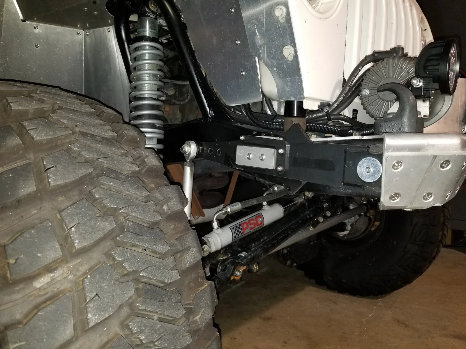

Well thanks to the great feedback here I have a Swayloc midway through installl on my Jeep. All I have to do is setup the end links and make a little space between the two passenger arms. I was not thinking and jammed those two guys up good and tight against each other rather than leaving a little space between them.
But back to the endlinks… I just removed an Antirock that if I remember right came with instructions to set the arms so that they have a slight upward bias (maybe 10-15 degrees?) and it worked well for my needs. It seems logical that the same approach would be the route to take for the Swayloc.
Anyone care to share their experience or thoughts on the matter?
The typical install has them parallel with the ground at the travel midpoint (same as the Antirock). As you likely already know, you just don't want the arms to be able to invert with down travel.
However I put mine up a bit to gain some clearance when stuffed and turning.

this is how mrblaine set up my SwayLOC

You aren't in control of that space. That is controlled by the width of the notches on the ends of the two torsion bars and the width of the tube that goes through the frame that the bars sit in. The two sets of arms need to be roughly flush with the end of each torsion bar. If that leaves a small gap between the inner and outer arm on the right side, that's fine, if it doesn't, that is fine as well.

As stated, roughly parallel to the ground to start, move up if they can invert under full droop, but not so high that they run into something above the frame like the grill or inner fender.

You won’t regret it, you’ll be amazed at how well it corners now. I have mine set slightly angled up a couple of degrees at the softest setting (furthest end link hole) and it’s still very firmly planted in the corners.

This part of the install manual is what got me thinking about it:
Note the gap present between the inner and outer arms in Figure 7, this gap is necessary to ensure the torsion bar can move freely. Failure to have this gap will result in the arms making contact and possibly failing the torsion bar. Now, finish the installation following the install manual provided. If there is not a gap as shown between the two arms, then loosen the inner torsion bar hub (outer bolt) on the dual hub arm, remove the 5/16 bolt and large flat washer, install the smaller 5/16 flat washer under the large flat washer and reinstall. This will shift the torsion bar the thickness of the washer towards the opposite sideto allow the gap. Tighten the 3/8 bolts as necessary.”
When I was putting on the inner passenger arm I could not get it quite flush. I stopped cranking on it when the thick washer on the install tool started to bend.

The width of the tube in the frame determines the relationship of the arms to each other. If you want to adjust that gap, you need to pull the bars out of the frame with the bushing on at least one side and grind the end of the tube closer to the frame so the overall stack width is enough to allow the gap. Done correctly if there was an actual concern that there would be any detrimental effect from the two arm faces rubbing against each other when the latch is disconnected in offroad mode, then there would be a thin flat washer of the appropriate size in a slippery material like UHMW or nylon to act as a bearing surface. If your sensibilities require that, then we can likely dig up some 1/16" UHMW to punch a washer out of.
I completed the install this morning and my wife and I took it for a spin. We drove the the local burger stand and the difference in handling was significant. Just for my own comparison I flipped the lever while I was in the drive-thru line. When I made the hard right onto the boulevard it was right back to feeling like my AntiRock. What surprised me and maybe is was just my imagination was the effect the cross wind had on the handling when it was in the “off road” mode.
