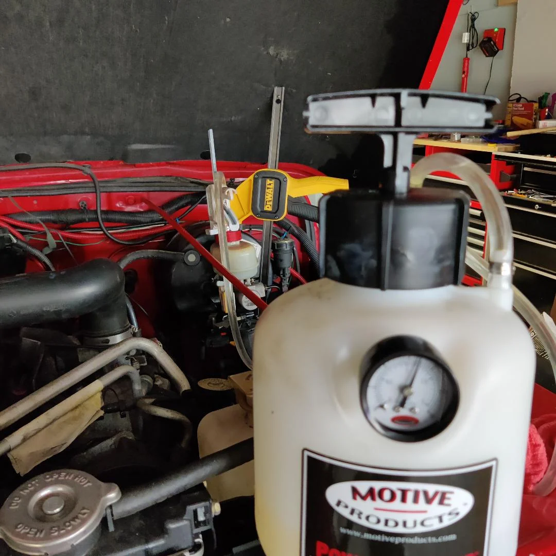

I picked up a pressure bleeder to bleed the brakes, and I ran into an issue with the rear calipers. The fronts flow perfectly but the rear calipers are dripping out like a drip a minute. My forum research tells me that the shutter valve (combination block) may be stuck, but I cannot find how to rectify this situation? Is there a fix to this? Or do I need to remove the Master Cyl and bench bleed that, and also remove the combination block to inspect?

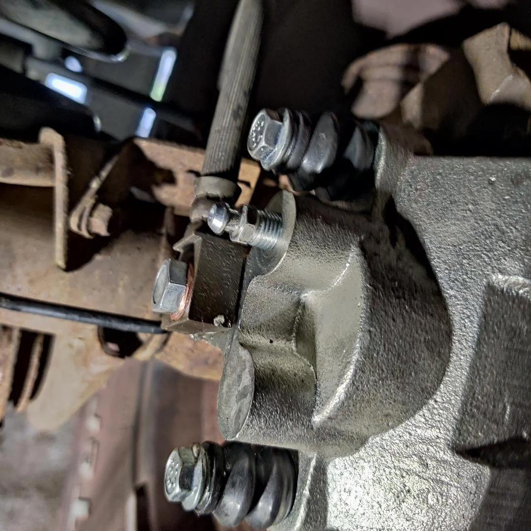

Test drove the car, brakes work fine - no mushy pedal, but there is no brake fluid flow from the rear calipers, so there is some issue there. My pressure bleeder is holding 16 PSI without any leaks. Do you see anything wrong here? The brake light is not on, unless I pull the e-brake, so that is working as it should be.

3) Bled breaks using the pressure bleeder, and now I have a hard pedal, but still only droplets of fluid flowing from the rear calipers, and front calipers flowing very well. Pressure Bleed holds 16psi.
Post 6 shows the caliper's open valve and nothing coming out, and the pressure bleeder holding that 16psi.

I would start with the stock rubber flex hose if it still exists and still has the clamp on it that holds it to the upper control arm. If you live where it rusts, that clamp will rust around the hose and squeeze it shut. That will explain both your old problem of the parts on fire because they couldn't release and the new problem where no fluid comes out. Start there.

Thank you for this, and I do live in rust country so yeah, that could be the issue.

I think it was that rubber flex hose....I just grabbed it and pretended I was a 13-year old boy who just discovered masterbation. I got some flow from the rear passenger caliper!!! I actually have a replacement part for that hose, so I guess I should change that part and see how it goes. Thank you!!!
