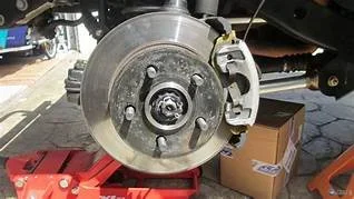

I did mine using the components from a 98 ZJ which was easy to source and was pleased with the results however most will tell you that there is no braking improvement over a properly maintained drum setup, but I will take the E-brake performance over the drum setup any day. My disc install is in over 2 years now and I have yet to re-adjust the E-brake since the day it was installed. I used the old calipers as a core for new ones and replaced the rotors. All said and done the conversion cost me about $150.

It’s well worth it, and cheap enough that why wouldn’t you do it? Like mentioned above, you won’t gain any stopping power, but the e-Brake works so much better and changing brakes becomes much easier as well, since drums are usually always harder to change than discs.

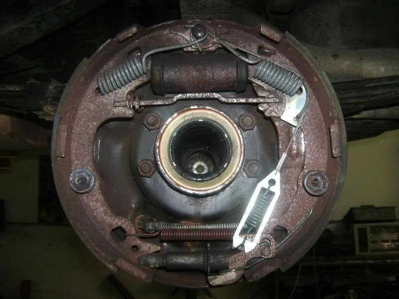

In my mind, it would be opposite. The disc brake set-up (at least on any rear disc vehicle I've worked on) uses a small drum for the parking brake. The Standard drum uses the vehicle motive brakes as a parking brake. All else being equal, the larger surface area and diameter of the standard drum means that it will be a more powerful parking brake...

It's really a matter of the drum type shoes being dual purpose and in constant use to stop the Jeep VS the shoes on the disc setup which are dedicated to the E-brake that see no wear and remain in constant adjustment.
Well a lot of owners comment on the performance of the disc conversion e-brake vs the drum setup so either they do not use their brakes in reverse enough for the adjuster to work properly or the disc setup works better.
