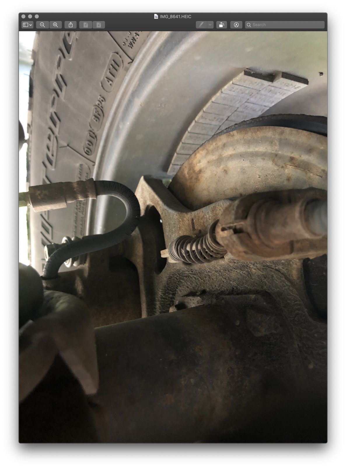

My TJ has a Dana 44 with discs on the back. The conversion was done before I purchased it.
Now the pads are worn out. Can anyone ID the donor for this conversion from the pic so I can pick up pads before I tear it down?

Maybe @mrblaine, the brake guru can identify and sell you some great brake pads!
Hard to say but 90's era Ford Explorer disk brakes were a popular conversion.
Sort of. The caliper, rotor, pads, and a few other parts are very similar and will bolt up in place of each other. The part that won't bolt up is the backing plate itself that you hang everything on. The bolt pattern is different between the Dana 44 and Ford 8.8.
What confuses stuff further is folks like Tera have built a backing plate using the parts from the 8.8 and used the Dana 44 bolt pattern.
Now the pads are worn out. Can anyone ID the donor for this conversion from the pic so I can pick up pads before I tear it down?View attachment 90128
The only things I can tell from that is you took a pic of the left side from the front over the top of the axle and you have a non standard install of a disc brake set up with that oddly placed flex hose.

The dust shield says that it is not 8.8 but could be TJ/KJ or ZJ. The next thing to know is whether the pistons are phenolic or steel. Need to know if the sliders have abutment clips on them.
Ok thanks for the info. I'll have to pull the wheel this weekend (since it's going to rain until then) and get some pics.
