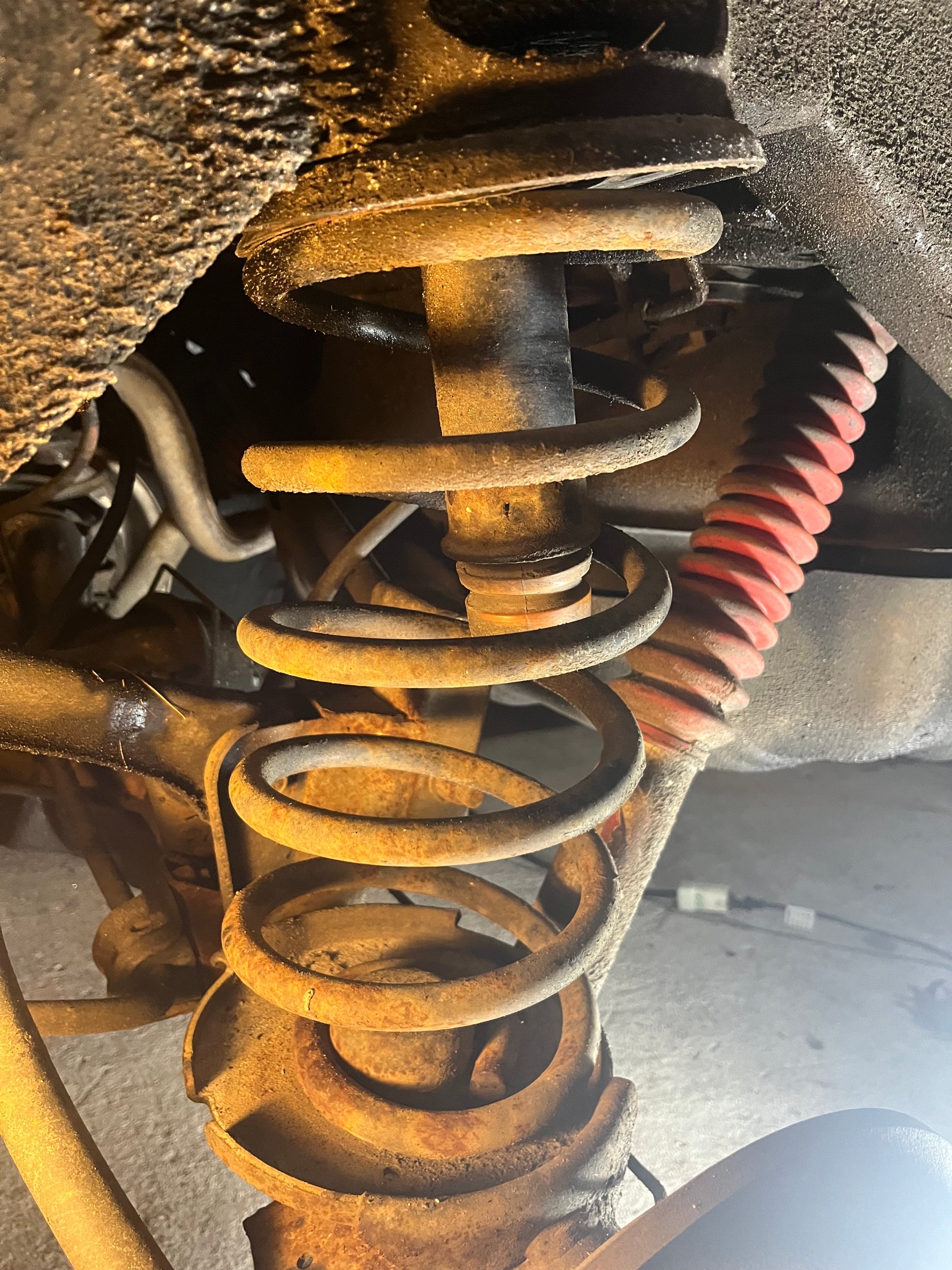

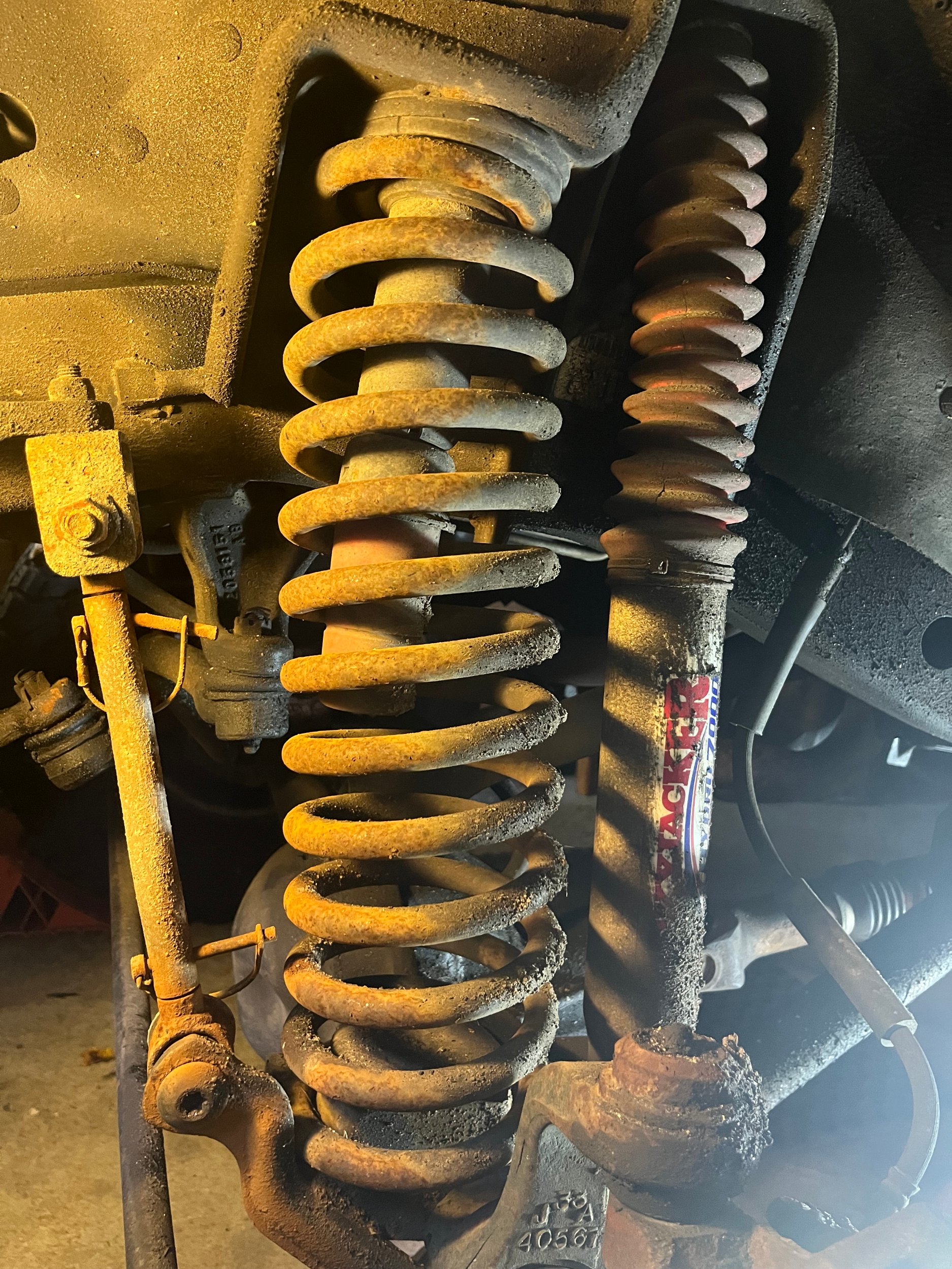

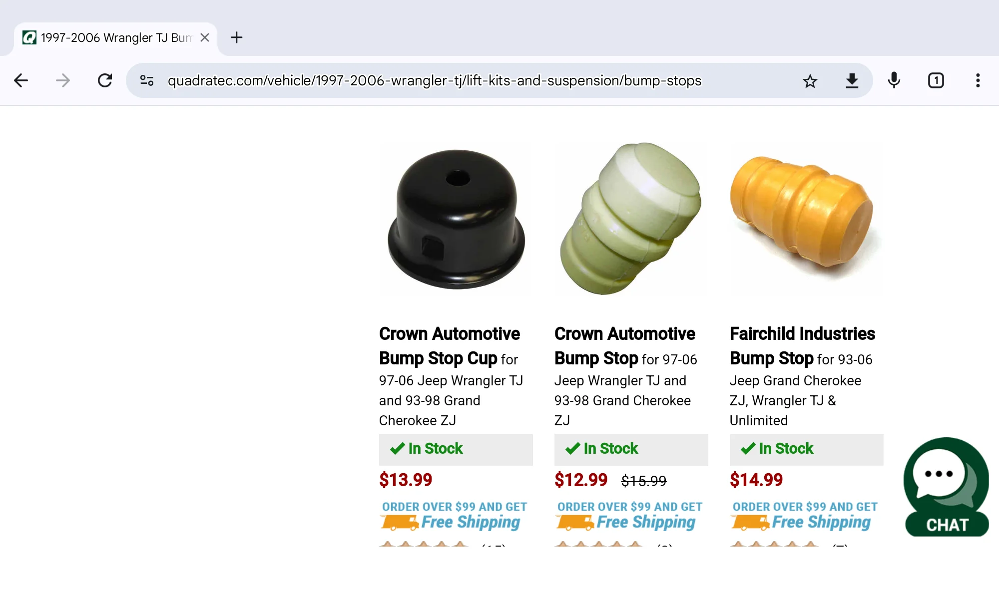

A pic of my front Bump stop--this i figure will just need a swap to stock bump stop size replacement

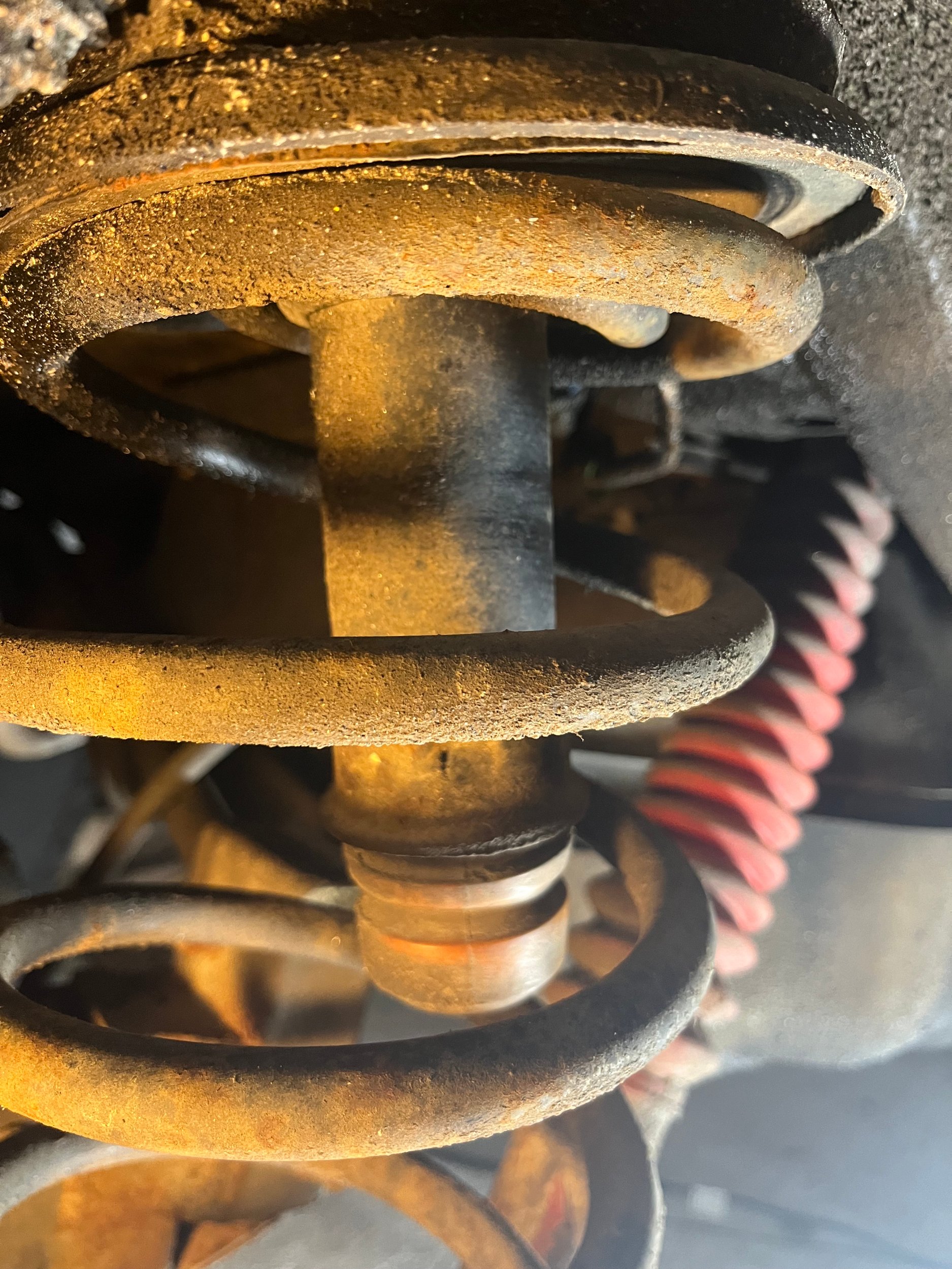

The rear 4inch springs on it now with bump stops

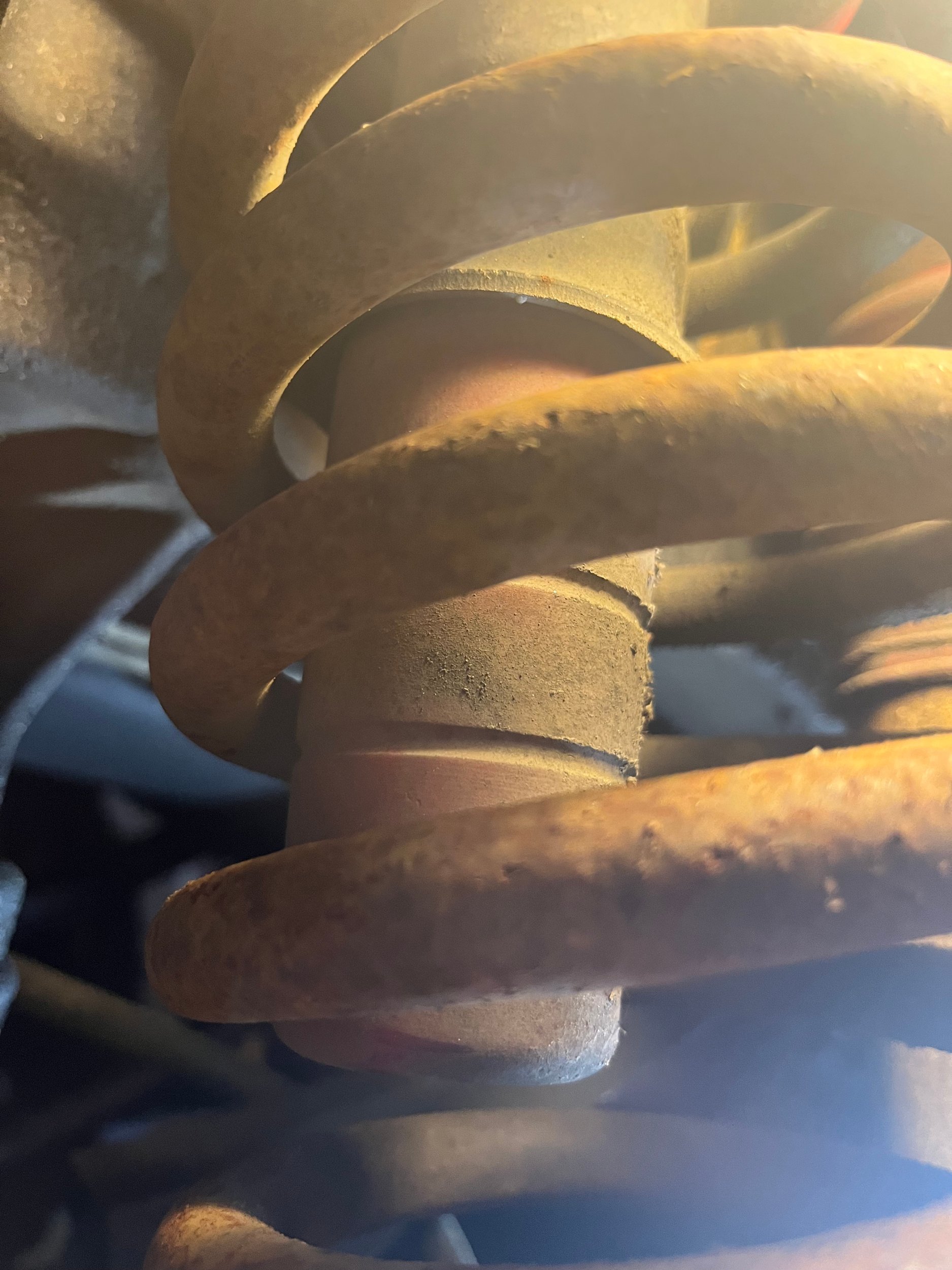

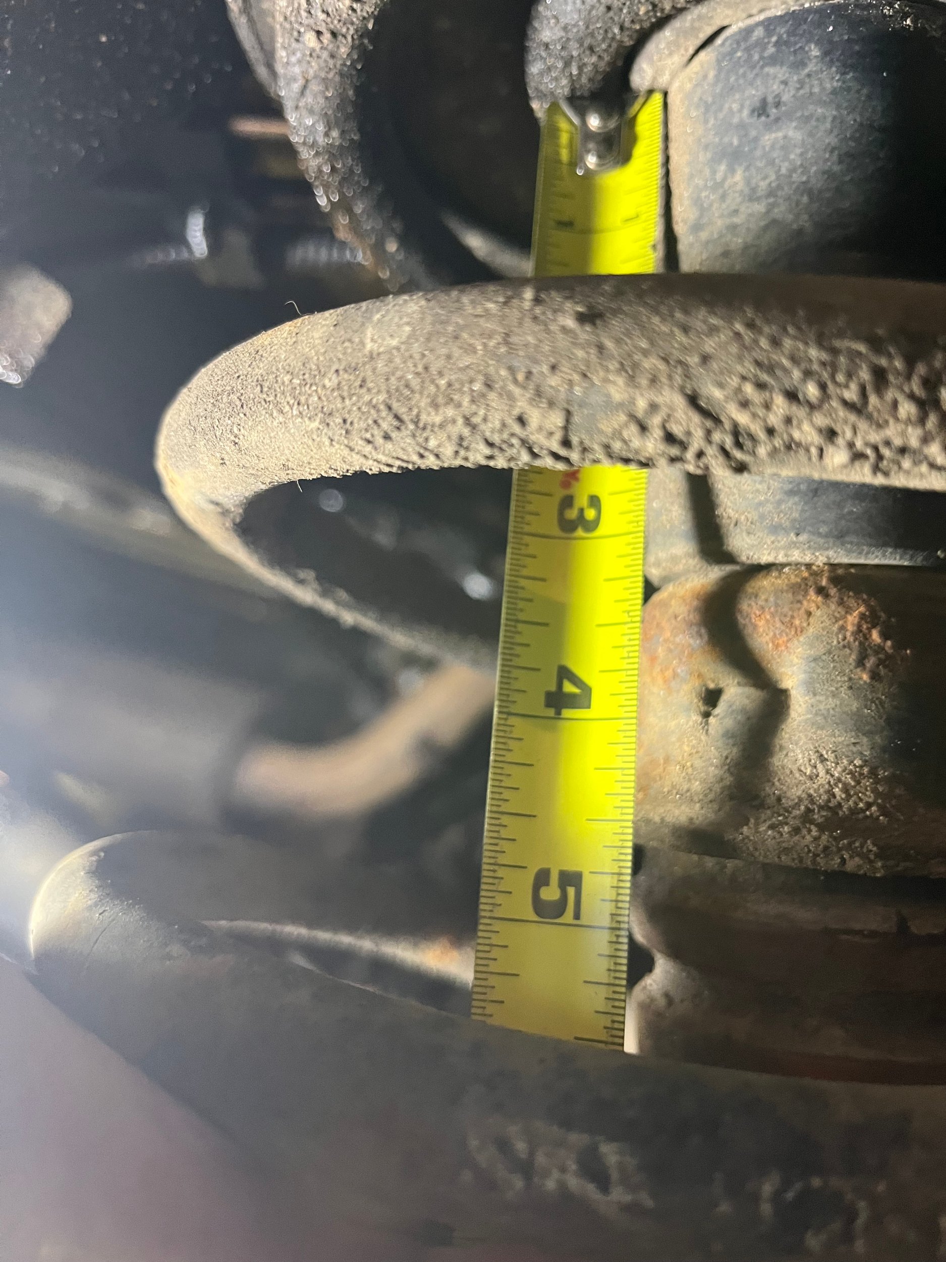

Im confused as to what im changing out on the bump stop assembly

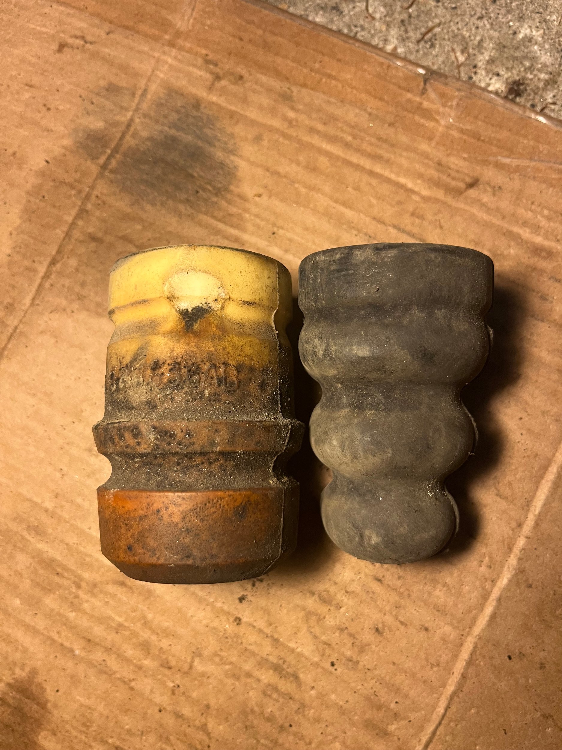

pic of original and one in the drivers rear now I have 2 original
am i correct in assuming that when i remove the cups the 3inch tube will come off? then the cup only gets bolted back?
im buying all new cups
What is best brand Bump stops to buy? and where A link to buy the correct size for front and back would be a big help and appreciated

All you need to do is after the springs is removed , remove the rubber bumpstop and unbolt the bumpstop cup to remove the spacer that is on top of the bumpstop cup . Reassemble without the spacer and install a new rubber bumpstop .

the rear has a tube that i "THINK" doesnt belong there so assuming a longer bolt is now in there
so from what im gathering i need 2 bump stops and two Cup Bolts
