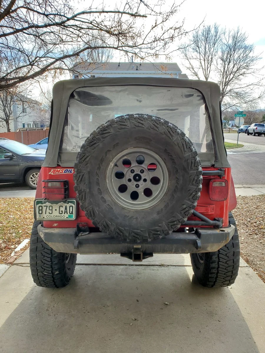

I'm looking to replace my rear bumper. My tire carrier is causing issues and rattles. Looking for something that has a place to mount reverse lights as well.
What ya got?

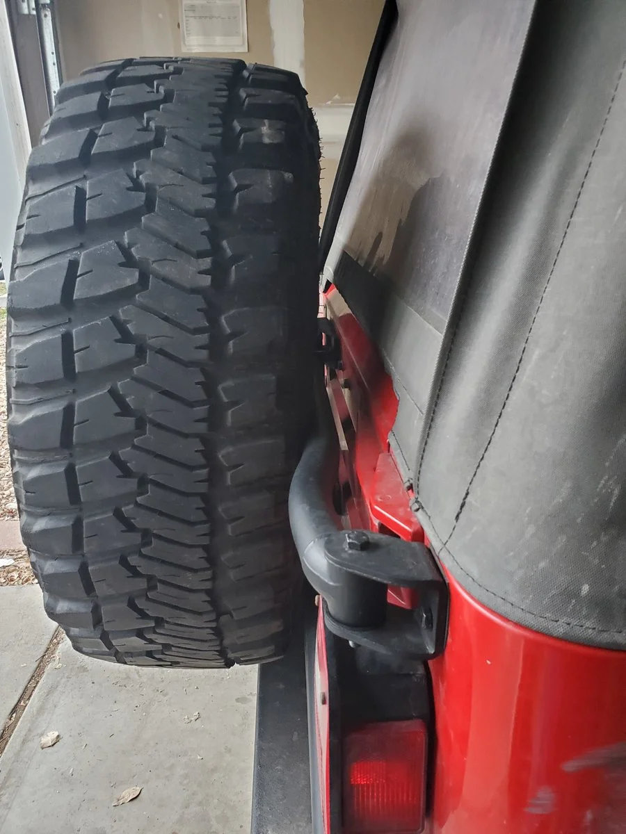

I'm not sure I like the look of those. While I'm not a huge fan of opening an extra latch to get in the tailgate, I would be a bit nervous hanging a 35 off my tailgate. My current system has the tub cracking a bit. I gotta do something. Looking seriously at the DirtWorx. Also like the JCR Offroad. Those be heavy eh?

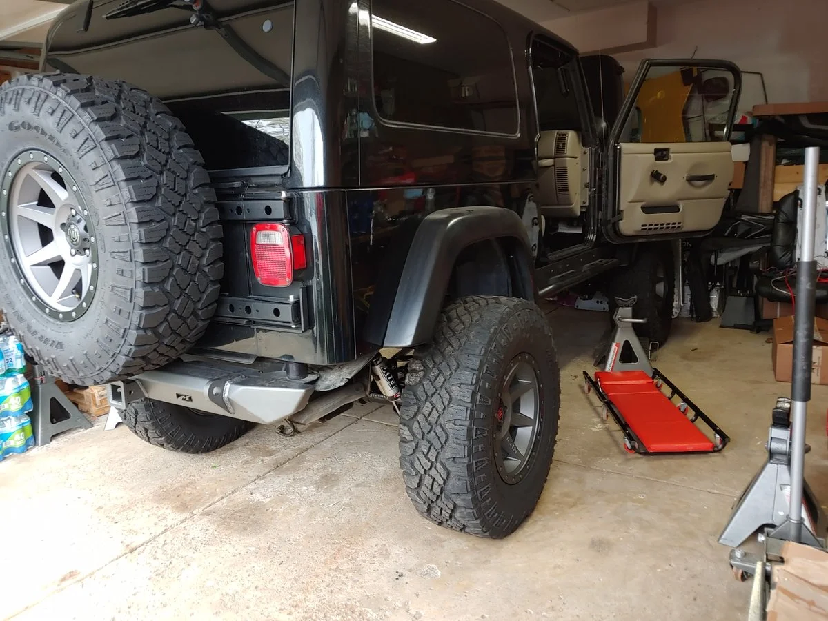

I've been using the MorRyde for a year now carrying a 35x12.5x17 Duratrac load range e. No issues. No sag, no rattle, no problem. And I wheel my rig too. Just make sure the tire is tight against all the snubbers and you'll be fine.

I used to think it was the perfect solution. After seeing that @jscherb had his tub basically crushed at the body mount from the extra weight over time I am starting to wonder how these things are going to hold up long term. There does seem to be some smarts to putting the load directly on the frame. I guess time will tell.
My tub damage is because of slamming down off ledges on trails - the sides of the trailer hitch under the frame slam down onto the rocks and that flexes the frame, which flexes the rear body mounts of the tub. The flexing of the rear body mounts caused slight deformation of the sheet metal near the body mount on the driver side. There was no damage on the passenger side where the Exogate mounts. The damage was unrelated to the Exogate.
The damage was caused by the extra weight in the tub. You are in denial if you think the weight you added wasn't a contributing factor. If you think the weight of the tire is centered anywhere in relation to the mount and not it's center of mass well, that's wrong.
I do carry extra weight on the drivers side - my Trail Kitchen + fridge and the fridge battery are all on the driver's side of the Jeep. So yes, that weight likely contributed to the damage, which was on the drivers side.
