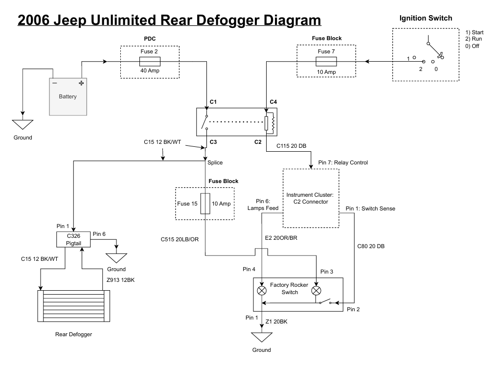

Schematics:

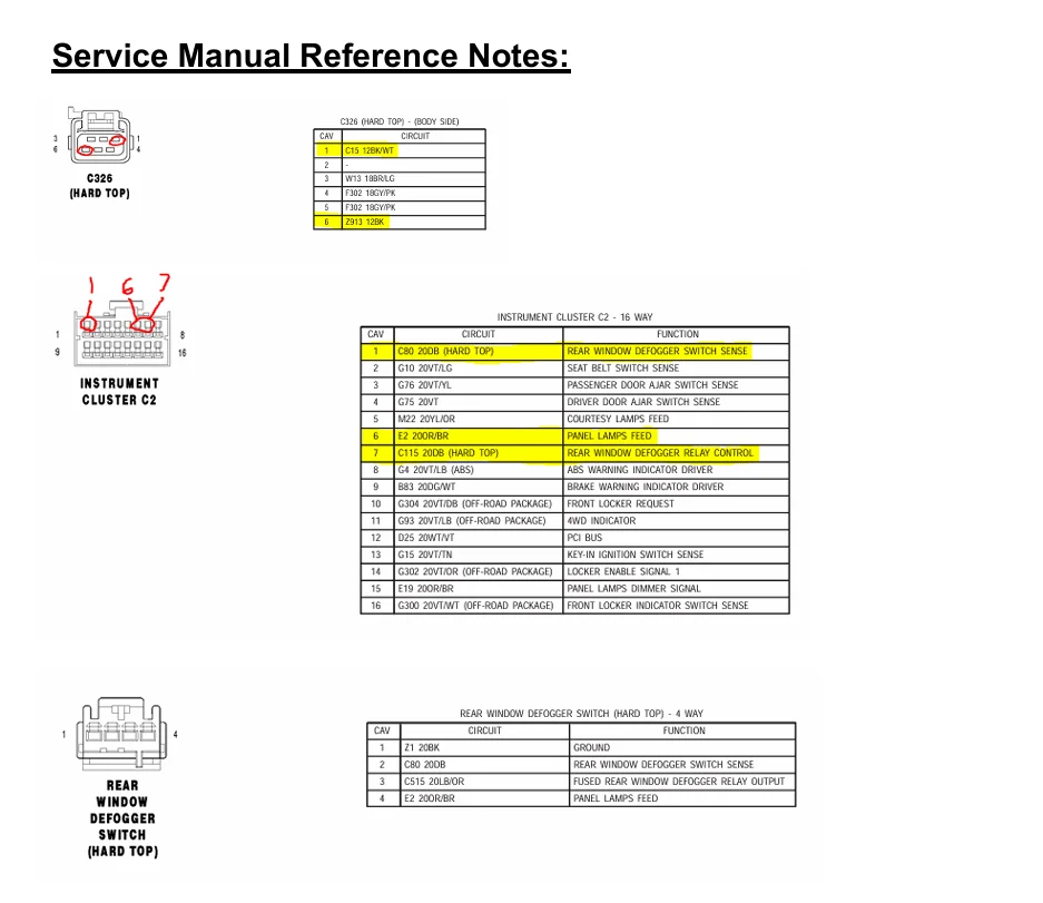

The first step to tackling this project was studying the wiring schematics. Personally, I highly recommend you download the service manual for your jeep from here and save them to dropbox, or whichever cloud storage solution you prefer for quick reference on your phone/computer. For this project, I'll be referencing the 2006 service manual. While I am an engineer, it did take me some time to logic my way through the schematics, so luckily for you I did all the leg work. Here is a general list of different components you will be dealing with in the circuit.
There is a lot of information to understand in the service manual, so here is my "watered" down schematic below. I've attached a PDF as well.

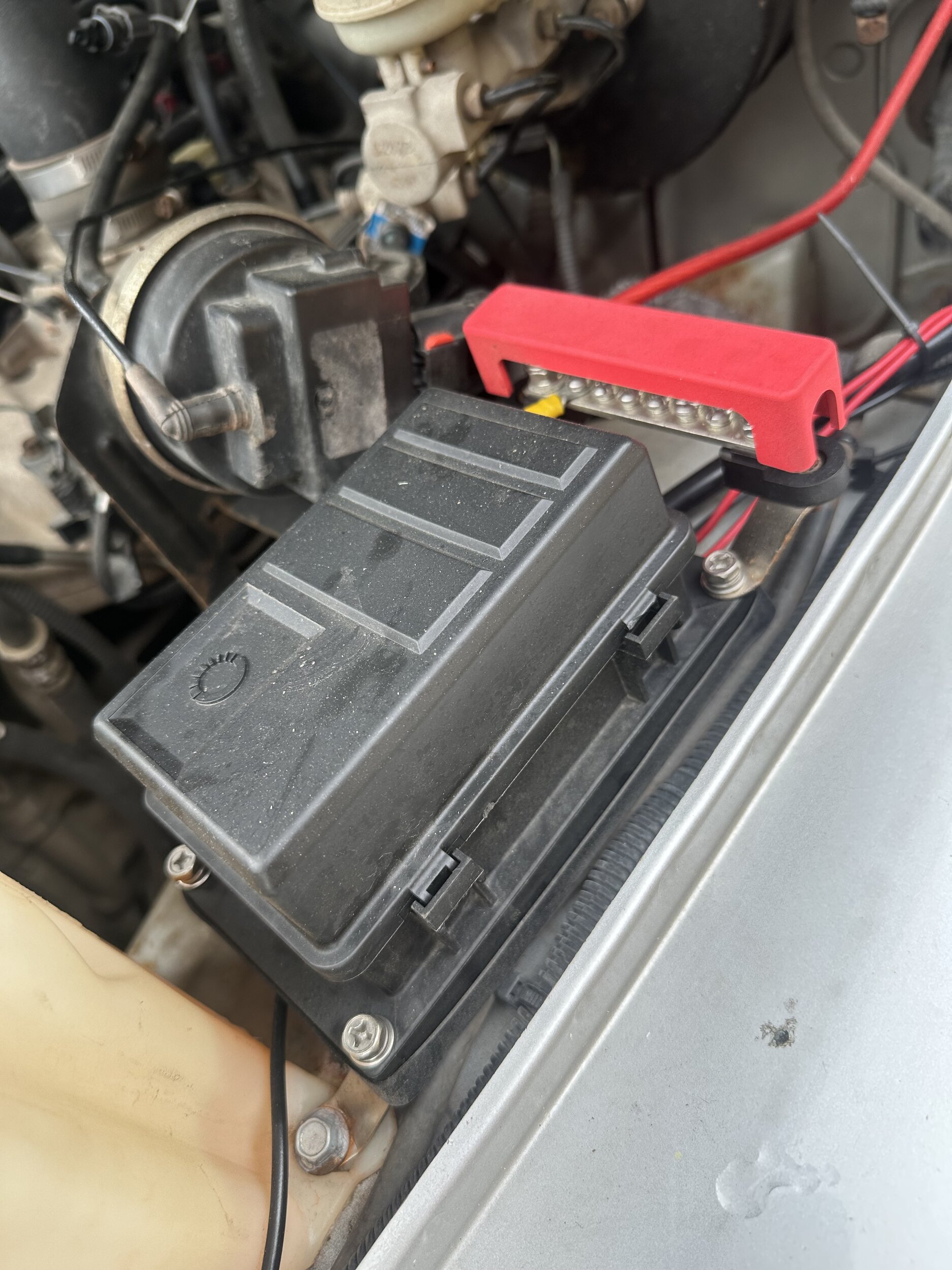

- I purchased and built my own relay/fuse box.

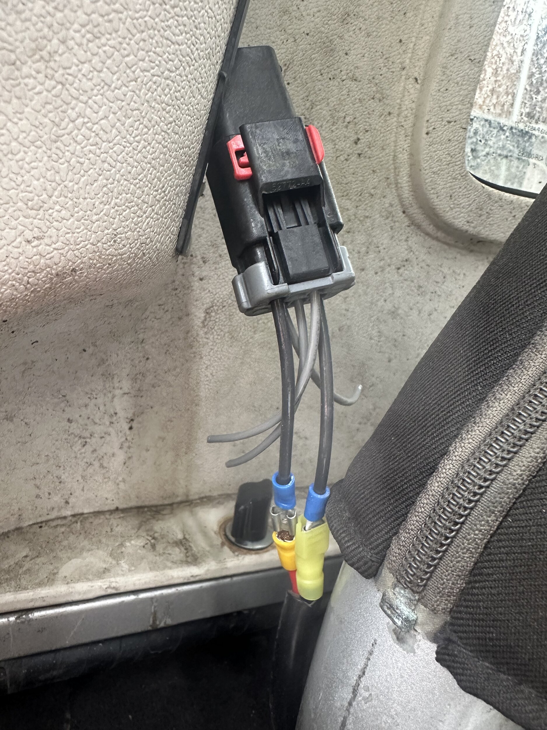

- Jeep Wrangler Hard Top Harness Pigtail Adapter 1997-2002 JEEP to 2003-2006 TOP
The hardtop pigtail was bought since I don't have the body side of the harness. I simply cut the adapter in half and took what I needed.
Schematics:
- Main Battery Connection
- Accessory Power
- Relay/Fuse Box
- Defrost Switch
- Integrated Defrost Timer (In Dash)
- Rear Defrost Pigtail
- I noted where the original fuse locations were for reference. I moved them all to my own custom relay/fuse box.

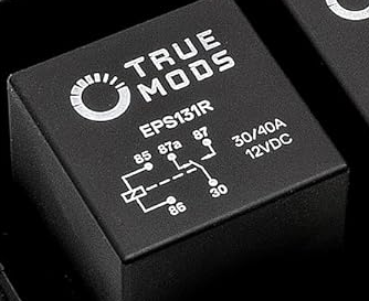

- The relay is a 5 pin, which comes with the True Mods kit:
- C1 = Pin 30
- C2 = Pin 85
- C3 = Pin 87a
- C4 = Pin 86
- Pin 87 is not used.

True Mods Relay/Fuse Wiring:
- Wire internal connections between relay and fuses in True Mods fuse/relay box.
- Wire 8 gauge wire from battery to power terminal block, wire connection between terminal block and "Fuse 2" 40 Amp fuse in True Mods fuse/relay box.
- Connect wire to "Fuse 7" 10 Amp fuse, run it through firewall, and splice into running/ accessory power. I used the cigarette lighter accessory power for this.
Instrument Cluster C2 Splicing/Pinning:
- Splice instrument cluster C2 lamps feed Pin 6, then wire it into defogger factory switch Pin 4.
- Splice instrument cluster C2 switch sense Pin 1, then wire it into defogger factory switch Pin 2.
- Splice/ or pin into instrument cluster C2 pin 7, then wire it into relay pin 85 location in the True Mods relay box. If you already have this factory wire you can simply splice into it. If you need to pin it, like I did, you have to get creative. The kit I ordered happened to have a circular pin with a diameter small enough to snuggly fit around the cluster pin.
- Ground switch Pin 1 - I spliced into cigarette lighter accessory ground.
- Pins 2 and 4 were completed in previous step.
- Connect pin 3 to "Fuse 15" 10 Amp fuse in the True Mods fuse/relay box.

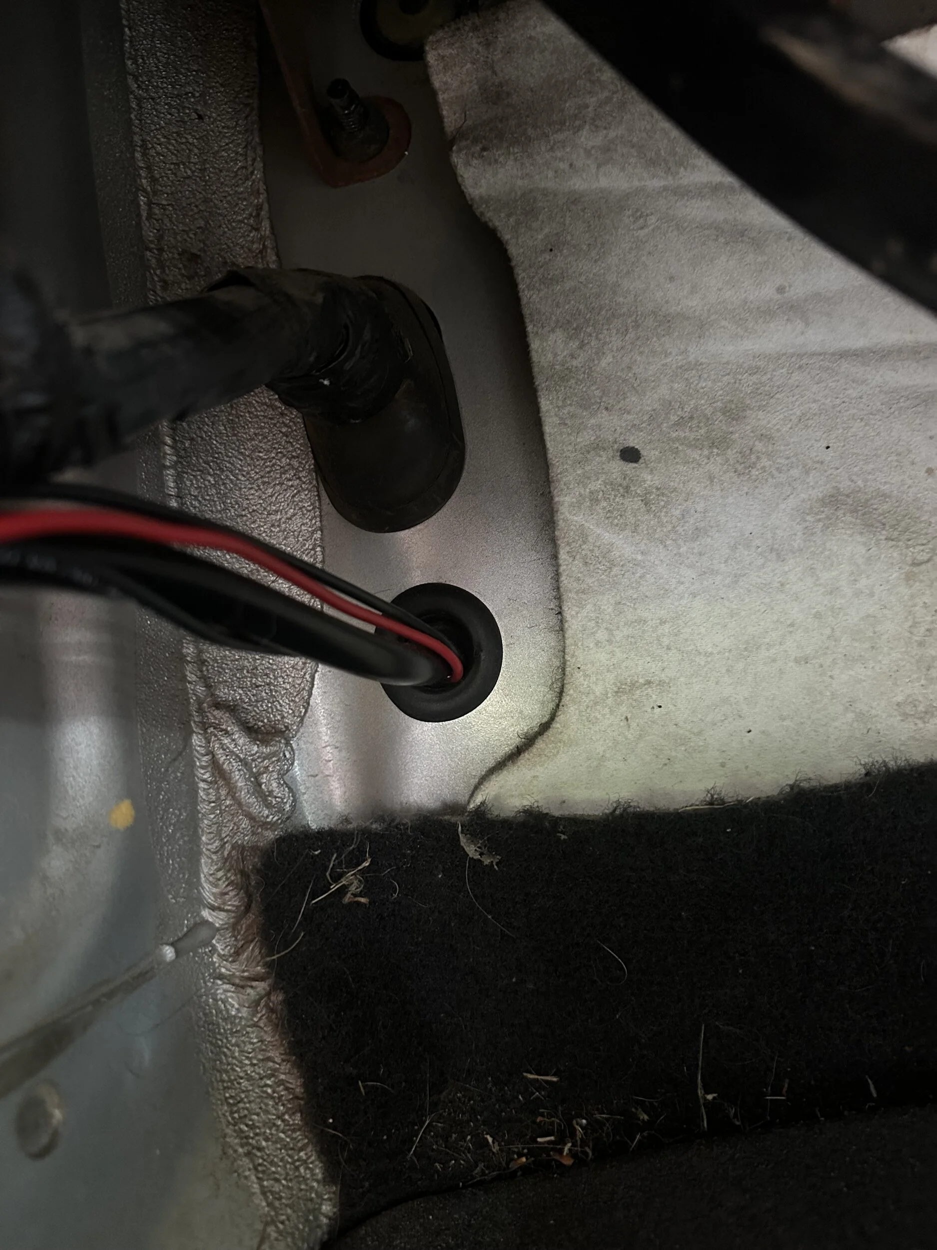

- Run the insulated hot/ground wire through the fire wall following the factory harness back to the hardtop connection point.
- Connect the hot/ground wires to the body hard top pigtail, being wires that connect to Pins 1 and 6 on the pigtail.
- I used existing mounting points from the windshield wiper fluid reservoir and cruise control bracket to attached the box to the fender. I then used the two remaining angled brackets to mount the terminal block to the box.
