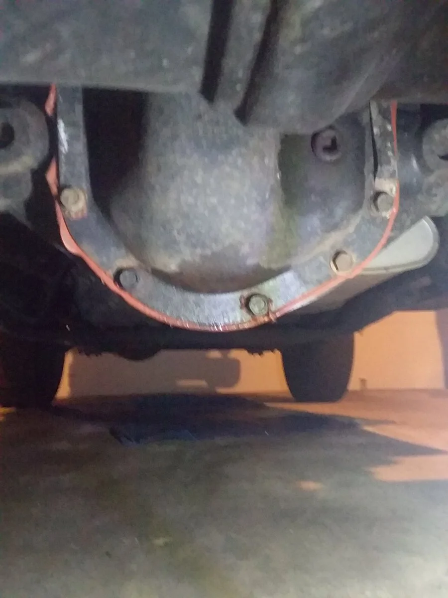

Looks like it is leaking from the differential cover. Could be from a bad sealant job, or from a nick, or even just the sealant going bad. I don't think a dealership would fix this under warranty, though it may not hurt to ask.
If you're capable of turning a wrench and doing an oil change, you can easily DIY this repair for about $30. A gasket is maybe 10 bucks, and oil maybe 20 bucks depending upon what you buy.
Look up instructions on how to change your differential fluid. You'll be removing those bolts, prying the cover off, draining the fluid, eliminating the old gasket, laying a new gasket, bolting it back up, and refilling. Should take 2-3 hours for someone with little experience. Most of that time will be spent cleaning off the old gasket.
I recommend getting a preformed gasket like a Fel-Pro or even a reusable gasket like a Lube Locker. RTV sealant is cheaper but is a little more tricky to work with.

I'll call them and give it a try. It still does bother me a little though. If they don't help I am capable of doing a differential fluid change. I did one in my younger days. I'll just prepare to get messy. The leak doesn't look horrible yet so I won't have to rush into it.

Posting a pic from under the diff (belly) and the pinion may help some “internet troubleshooting.” The pinion could be leaking and due to driving, the oil can run down the underside of the center section and make it appear that its the diff cover that is leaking.
Also, it’s common for the diff to start leaking from the cover if the differential breather is plugged. Check the breather as well. With all pressure building, and the breather being plugged, it can cause the diff cover gasket to leak.

Drain the oil, remove the bolts and cover. Clean and reseal with Permatex Gear Oil RTV Sealant. Give it the 24 hours it calls for to set up and refill with oil. It will not leak again. I like Permatex Gear Oil RTV because it does not leak. Later I hate it if I have to remove the cover, takes some effort to break the bond.
