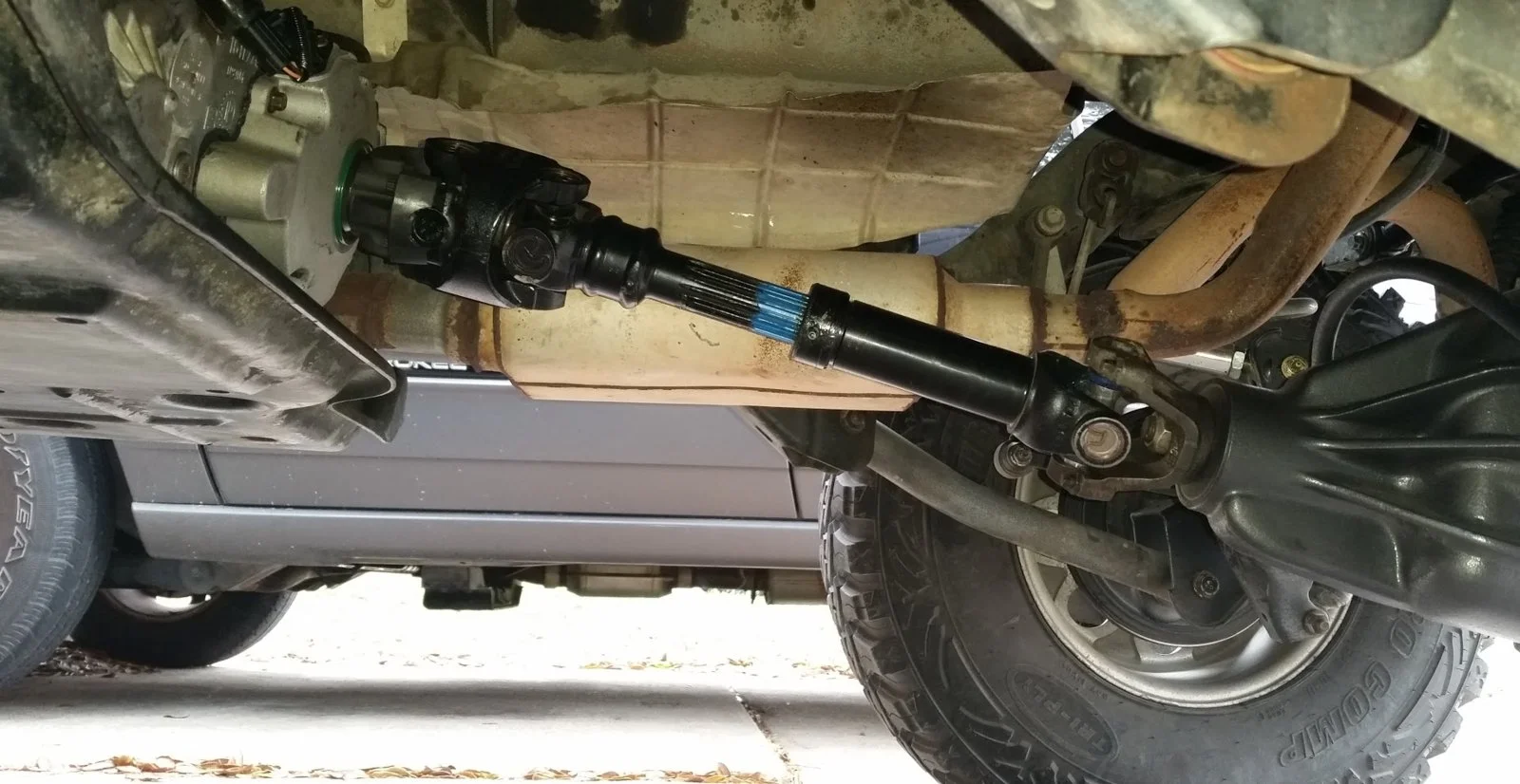

I changed my sye to a JB conversions shorty sye and that gave me the room I needed. My driveshaft is a 1/2" longer than what it was and seems good. Been driving it as round for a few days with no vibration.
Here's a pic of my new set-up. Loving the new gearing in the Dana 44!

Did you break the u-joint or did they shipped the driveshaft with a damaged u-joint in it?
Had to order a 1310x1330 u joint for the new diffs. Thought I would put grease in it and it broke pulling the hose off! I have some small extractors I can probably use to get the threads out and screw in a new one. Wish they were a sealed u joint like the 1310's that came with the driveshaft
Gently tap one in there that is small enough. Once they break off, they aren't torqued against the shoulder and will generally screw right out with just your fingers.
