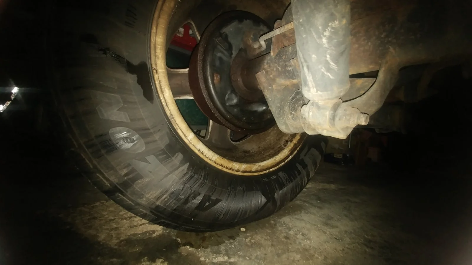

I am wondering about this drum. It is dripping brake fluid slowly from what appears to be the the rear wheel cylinder and the drum. I noticed it leaking earlier (pedal pressure got low) and I was able to tighten the line nut. But now it appears to be coming between the cylinder and drum? Maybe it's just slowed down so it just APPEARS to be coming there and is actually leaking. BTW, I tried the line wrenches and they don't fit. It appears like I have some sort of ovoid nut or the last guy balled it. Wound up tightening with needle nose vice grips.... But it still could be leaking at the brake line nut.... Any advice would be helpful.
Yep, sounds like the cylinder may be leaking. I'd pull it apart and inspect it.
