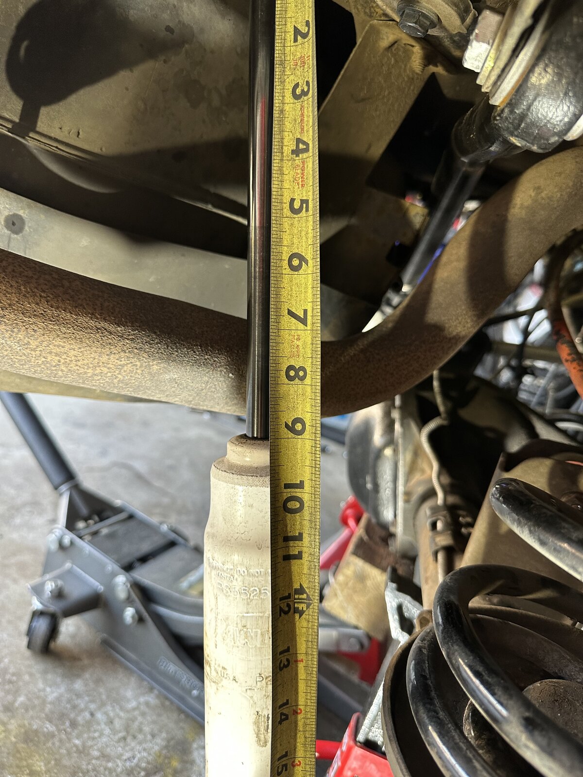

Now what is the length of the fully extended shaft?
About 9 1/4
Are those Rancho’s the right ones? If not what do you suggest? And nothing adjustable I’m confused enough as it is
You know all that talk about 50/50 shock travel that happens around here? We are trying to figure out how close you are to that. 😉
It seems odd that you need 5" of bump stop extension to make that shock fit.
I would think it should be more like 2"; maybe 3" with the shock relocation bracket?
Are you sure you have 4 inches of spring lift?
100%…..took the oem springs off put these on and final measurement was 4 1/4 taller (probably due to sag in the old springs)…..that’s one of the problems I don’t know how long a bump stop to use. I’m not sure how to fit the shock I’m just trying to get some answers with the posts I’m doing
Do you know if and/or how much that jounce bumper compresses?
Trying to get my rear jounces centered under my bump stops...is it that critical to have it centered?
No, it's not critical.
Even if they were centered when both sides are compressed, they wouldn't hit in the same place when one side is compressed during articulation.
The bump stop length is what it is. Whatever it takes to keep the tire out of the fender or anything else from hitting something it shouldn't.
