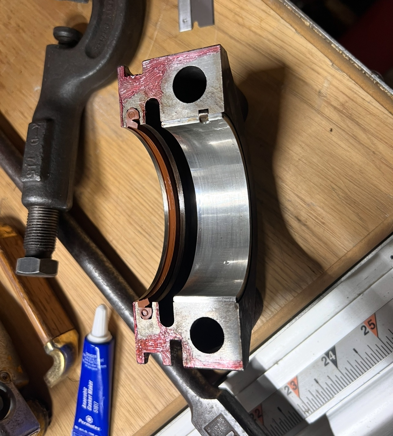

When u applied anoreobic sealant is it just the 2 little lines of it all you did? The shop manual has 2 steps for where to apply it but the diagram only shows the 2 lines of it
I direct messaged the OP. His reply is below. I followed this thread to a "T" when I did my rear main seal in April. So far it's held up.
"Hi Rancho LJ,
I didn't put any on the cylinder block, just a bit more on the bearing cap to compensate. So it was probably closer to a 5mm bead.
Good luck!
Ps. My RMS is still bone dry to this day 😁."

Got it. I will just do the same then. Makes sense to only put it on the bearing cap because of gravity. What did you use to clean the upper seal location? I’m worried a blue shop towel will rip as I thread it through

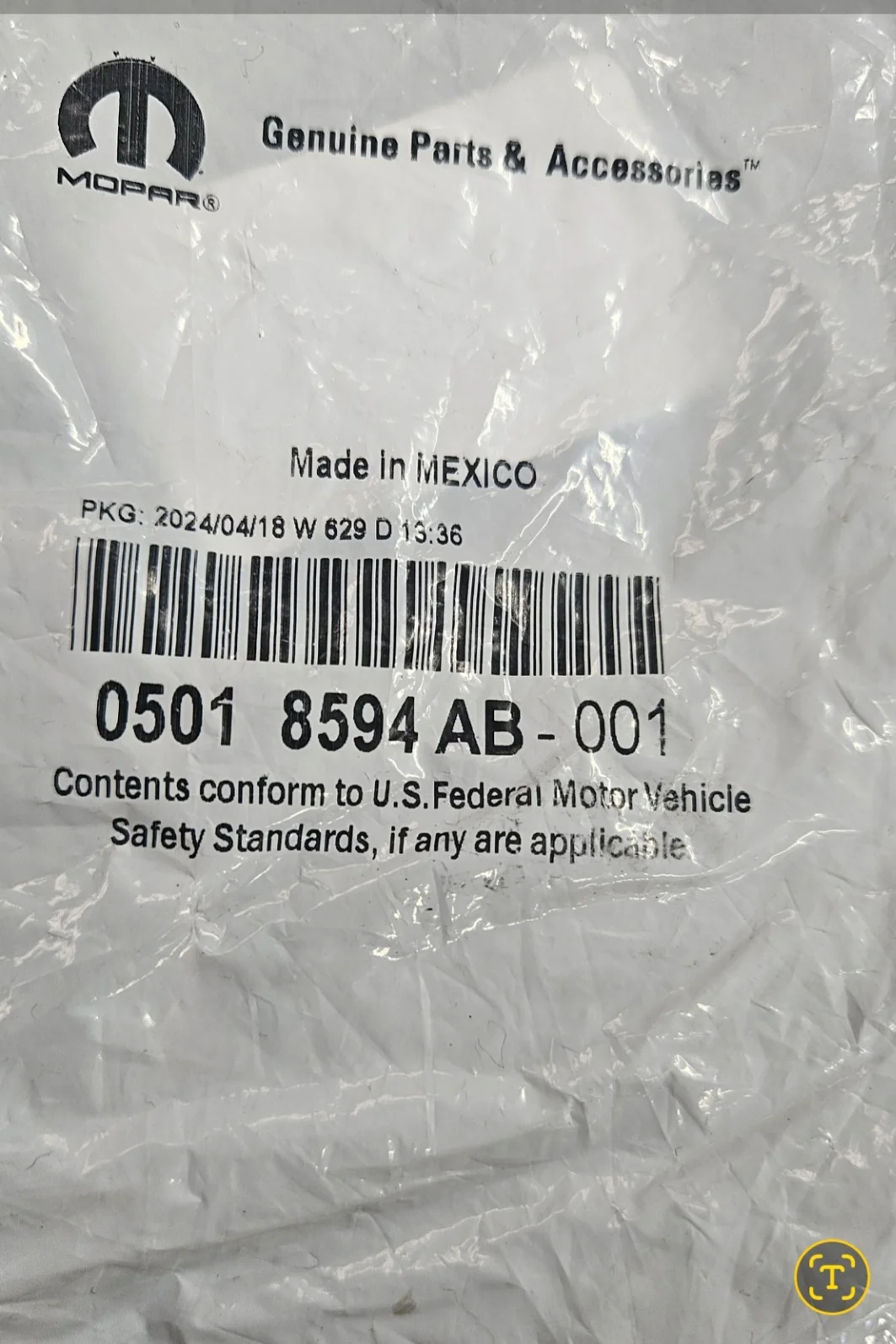

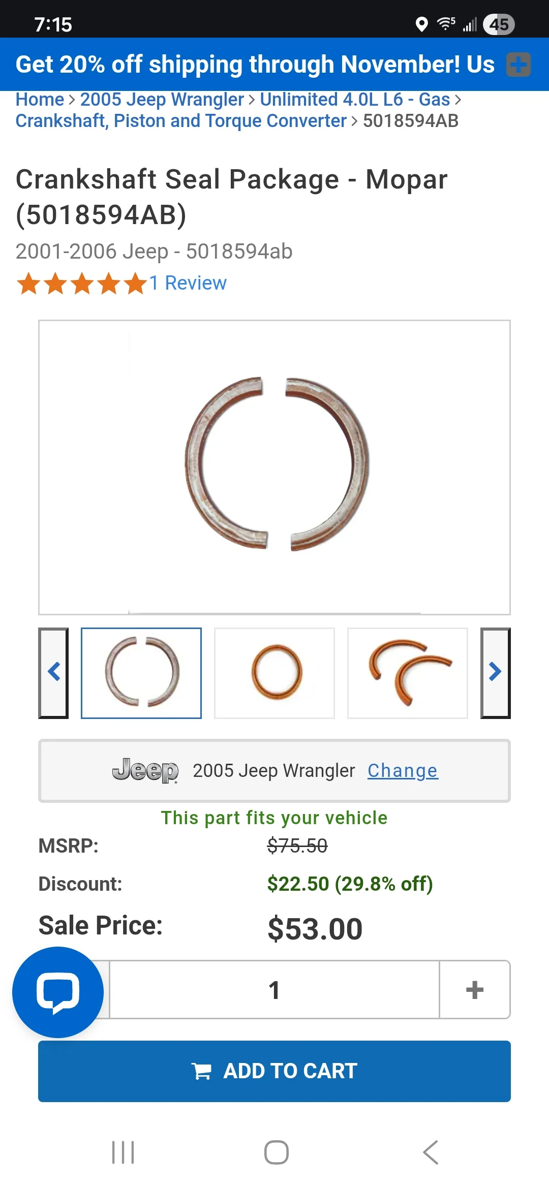

What is the MOPAR part number?
Dan,
I know you're asking the op, but I don't know if he posts here often. He did respond to my DM back in April.
Search for "Crankshaft Seal Package". It may not pop up right away if you search for rear main seal. I originally bought a Felpro gasket and decided to go with the Mopar instead. I'm 99% sure this is the correct part. Since I picked it up from the dealer I don't have a record of it anymore. I think I paid about $80 because needed it quick.

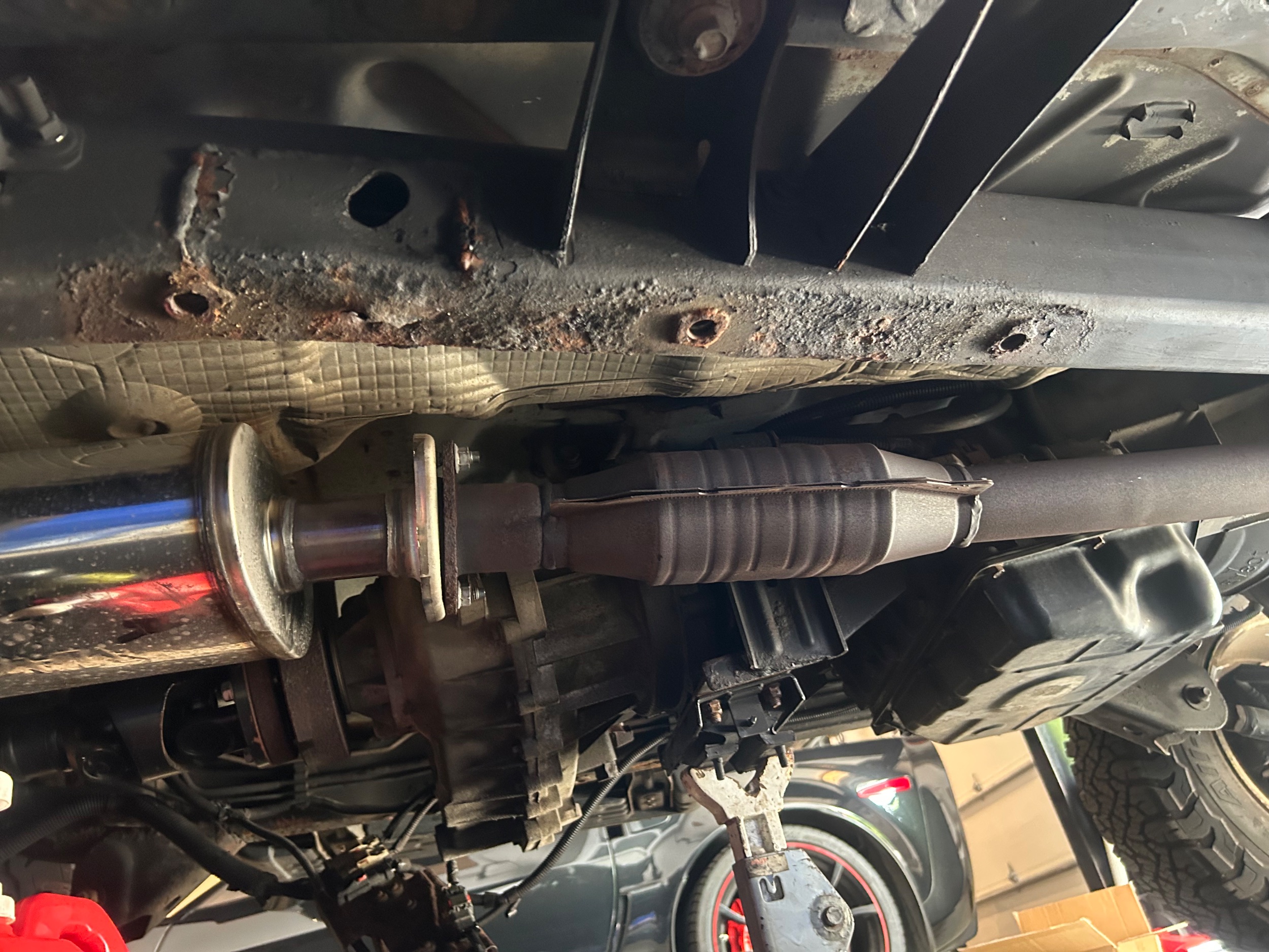

For what it's worth, the toughest part for me was reattaching the exhaust to the exhaust manifold. You need a super long extension for the back side from underneath. Trying to start the bolt from the bottom while the retaining clip/nut (sorry I don't know what they're called) moved was a p i t a. Make sure you have someone to assist you with that part. They can hang on to that clip from the top side while you start the bolt.

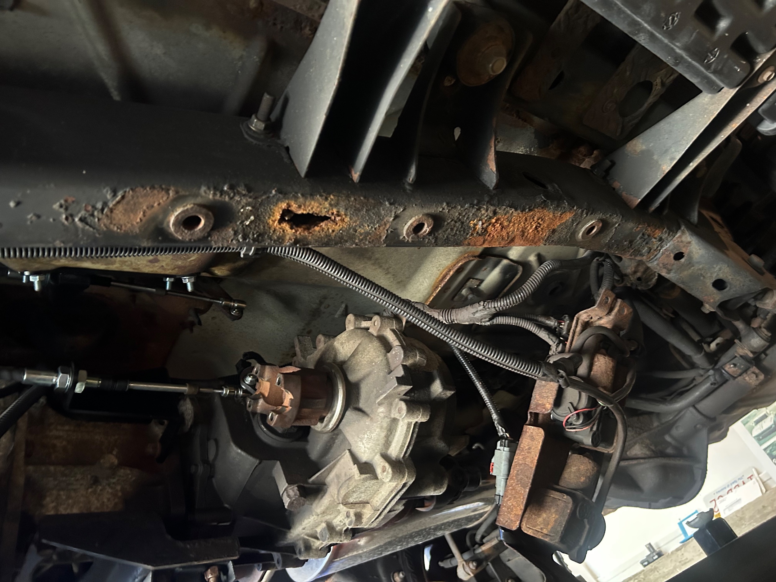

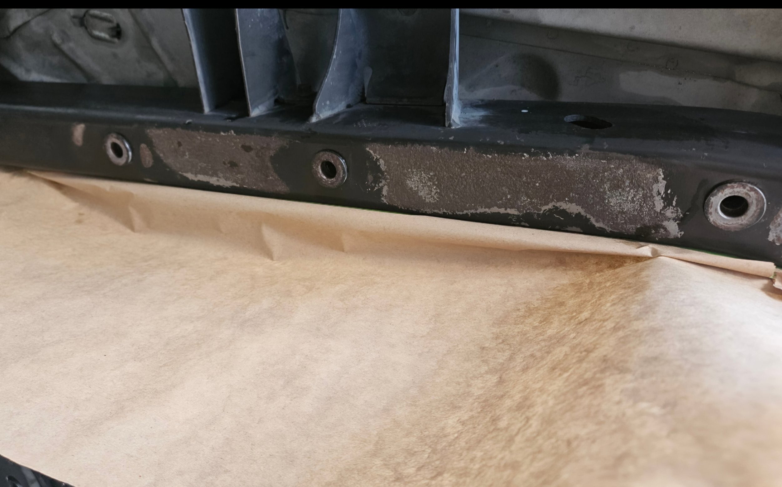

Also, when I dropped my transmission skid plate, there was a bit of rust between the skid plate and frame rails. It was a bit of a surprise since it's a California Jeep with low miles that's always been garaged. I wire wheeled away the rust, refinished it, and I installed it with a couple of half inch washers between each mounting bolt so there's no water retention there.

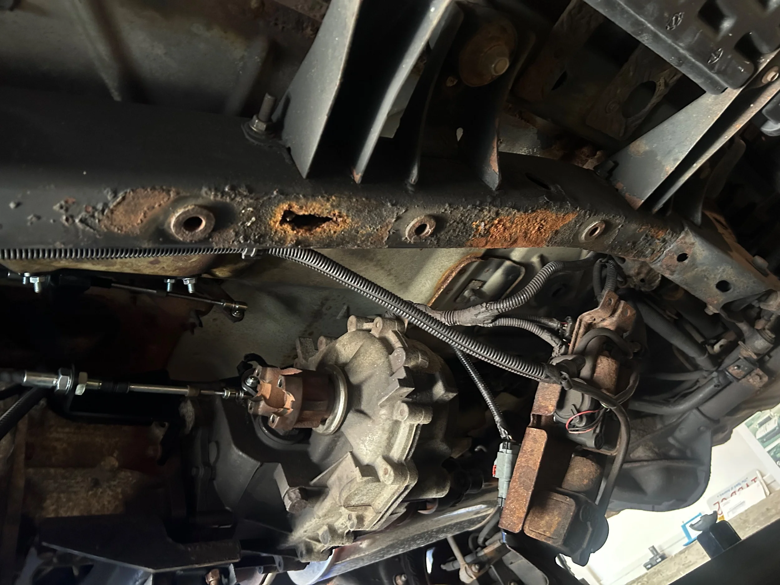

That’s nothing. Mine looked way worse when I pulled the skid plate off last summer to replace my transmission mount, install savvy shift linkage and front driveshaft removal. If I was you I’d spray some wool wax or apply grease prior to reinstalling the skid plate
