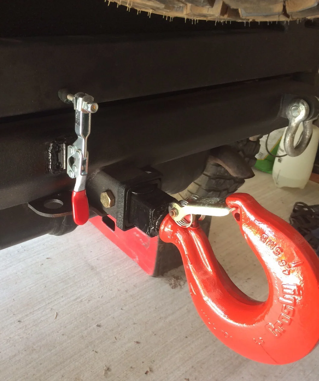

A 4.75 ton rated shackle in a 1.75 ton rated receiver hitch.

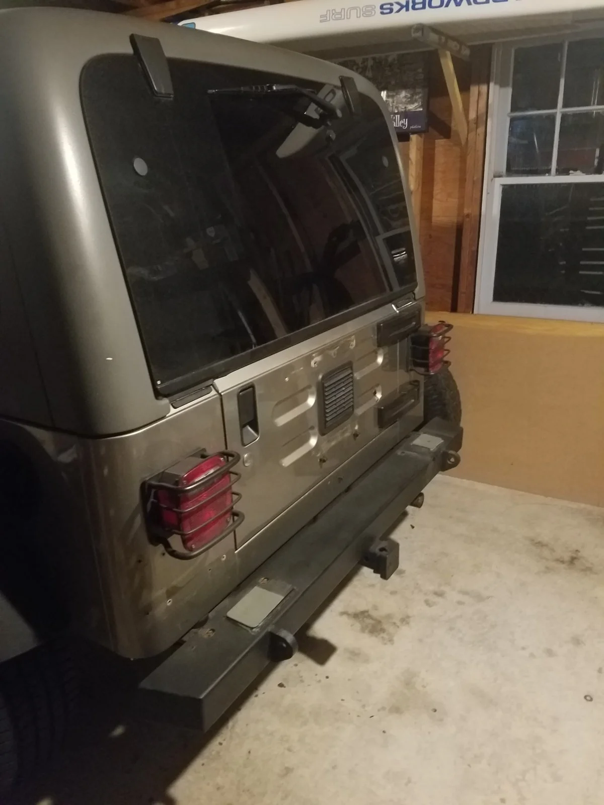

Are the bumpers that have both the recovery points for d ring shackles and the hitch built any differently? My bumper has the tabs for the shackels but I’ve always used the hitch because I felt it was a stronger mounting point.
The gray spots are from the swing out tire carrier. I hated the additional step and space needed to open it so I took a grinder to it and went with a stock tire mount.
How can you tell whether or not the tabs are legit or if they are for show?
That depends on the bumper design. My Dirtworx bumper shows the tabs having been through-welded on both the front and rear sides of the bumper. I'd be surprised if yours weren't through-welded too so long as it was commercially made and not from someone's garage.
Thanks Jerry. I'm fairly certain it's a Barricade. Im a bit confused though. The bumper is rated for recovery and doesn't carry a tow rating but the website describes the hitch as a recovery point. Wouldn't a recovery put far more stress than towing a trailer?
Manufacturers became very reluctant to continue rating bumpers for towing strictly for liability reasons. Some bumpers previously rated for towing no longer are for that reason.

Unfortunate reality of the times. I thought it was odd when it didn’t have the tow chain tabs. Now that I know to use the tabs, what do you think a recovery hitch means?
Bad idea for recovery, too much potential leverage against the receiver and its drawbar.
