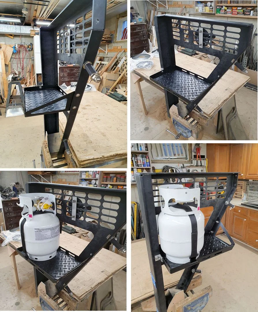

The MORryde JK Overland Rack will easily fit up to 37" tires under the rack basket.
In fact with my 32's there enough room under there that I recently designed and built a propane tank/ammo can tray option for the rack. Only one leg of the rack is shown in the photos below; that's all I needed in the workshop while I was fabricating the new tray.
The TJ rack shown earlier in this thread is independent of the tire size - because the accessories (cargo basket, bike rack, jerry can/Rotopax carriers) are mounted in receivers, they can be set in the receivers at whatever height is appropriate for the size of the spare. BTW the rack shown on the TJ also works on the JK; I have the receivers on both my LJ and my JKU and regularly use them to carry bicycles.

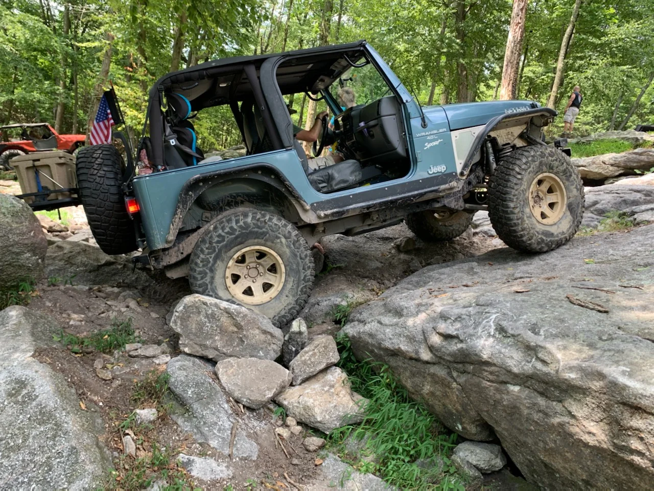

Yes I think it is. I used the heck out of that rack and even have a nice dent in mine from running into something.
The only thing I did was drill out the hole that holds the pin and put a bolt thru it because my rack would rattle.
I've found mine to be incredibly useful as well. I backed into a clay bank one time which gave the rack an "alignment job". I had to rebuild the square tube receiver to bring it back to level. I wasn't the only one in my crew to pull off that exact same move. The trail became affectionately known as "Cooler Crusher". :ROFLMAO:
I don't love the extra attention it requires in tight situations but find it necessary to bring a decent cooler on the longer days with 2 kids in the back. It is what it is...

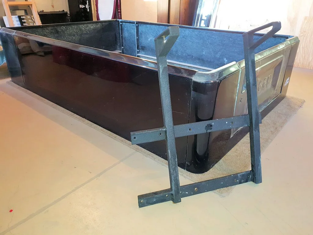

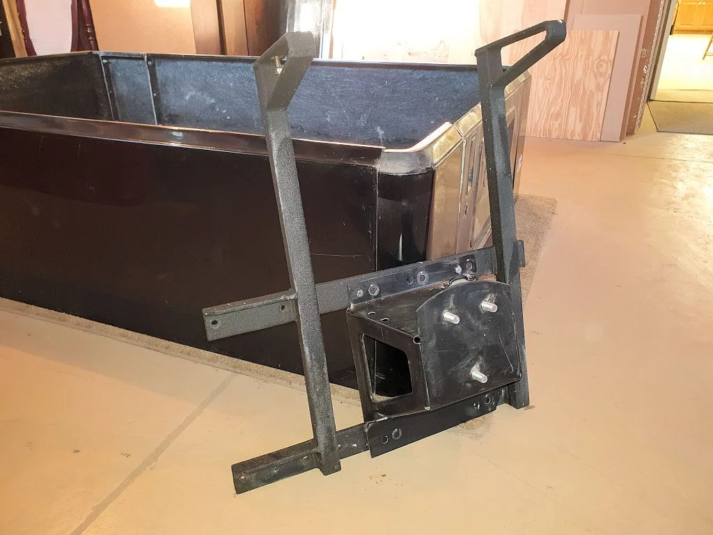

A few years ago I picked up a used Garvin rack I found on Craigslist and the guy threw this unidentified tailgate rack in. It's very sturdy and attaches using the spare carrier bolts. If you're close enough to come and get it you're welcome to it.
This would bolt right up to the v1 Exogate; for the current version Exogate or MORryde reinforcement spacers would be required for it to clear the lip on the reinforcement frame.
You could bolt almost any basket to it, probably this one from Bestop could be made to work: https://www.quadratec.com/products/12034_900_07.htm
