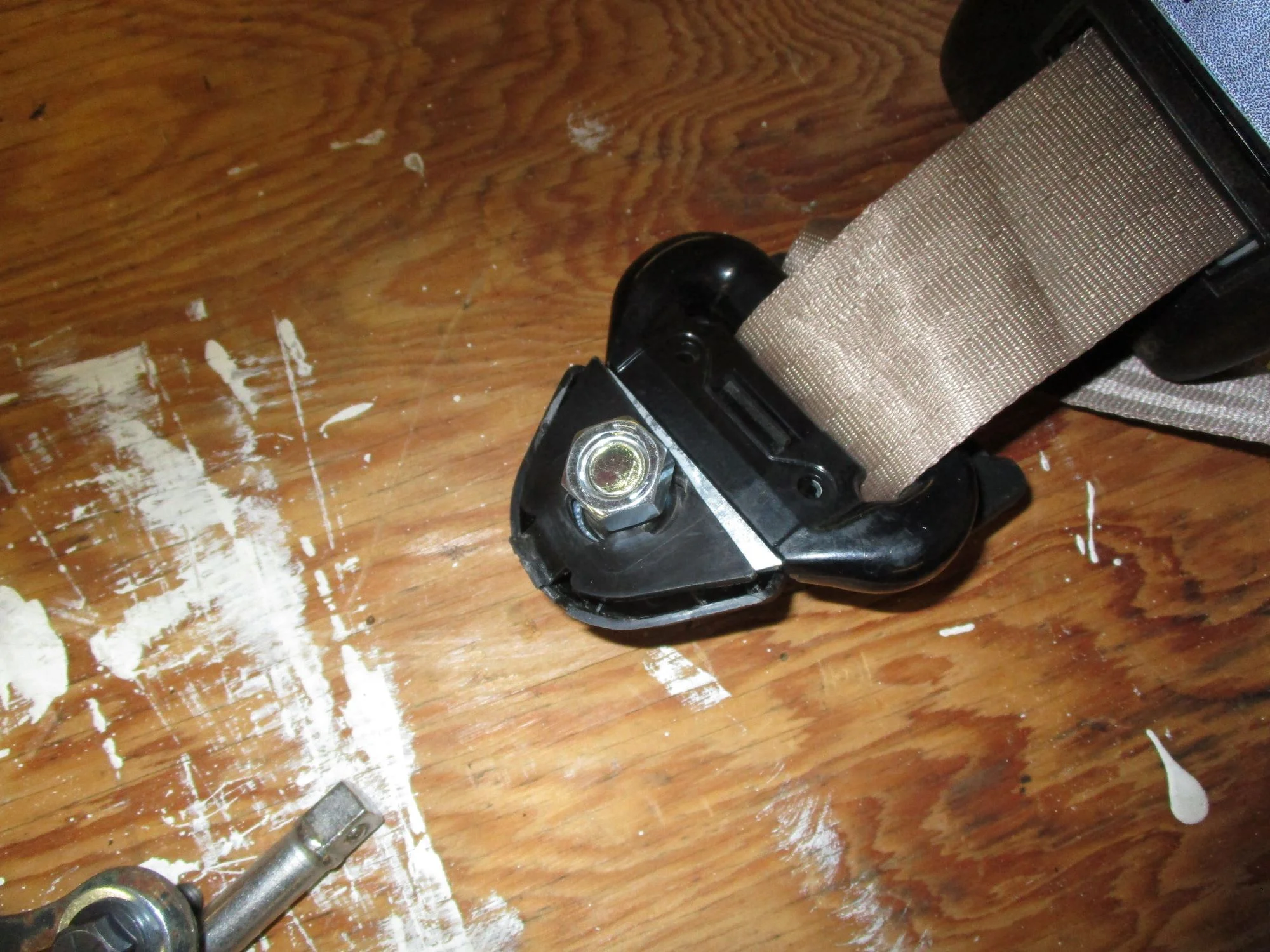

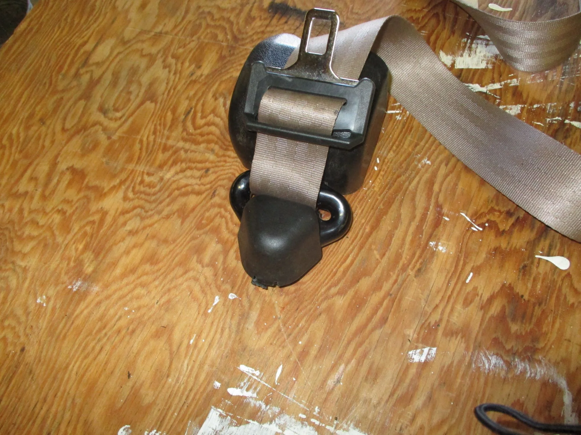

Jim_n_Tx New Member Original poster Joined Apr 14, 2024 Messages 8 Location Texas Gulf Coast Jul 3, 2024 #1 How are the rear seat belt retractor covers secured? How to get them off.
hear Can't type Lifetime Supporting Member Joined Oct 18, 2020 Messages 6,081 Location Prosper, TX Jul 3, 2024 #2 I’m pretty sure the bolt passes through the hidden side of the cover, so you have to unbolt the thing to remove the cover.
TCJ New Member Joined May 24, 2024 Messages 19 Location Ellensburg Jul 3, 2024 #3 The head of the bolt that screws into the upper fitting on the roll bar is under the plastic cover. Pry it up with a screw driver so you can get a socket on it. I put the nut on the bolt just to keep the parts together while the belts are out.

Jim_n_Tx New Member Original poster Joined Apr 14, 2024 Messages 8 Location Texas Gulf Coast Jul 5, 2024 #5 Got it - torx bolt inside of doghouse cover -torqued to 10,000 lbs.
