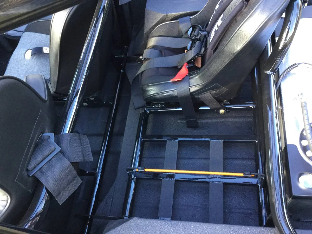

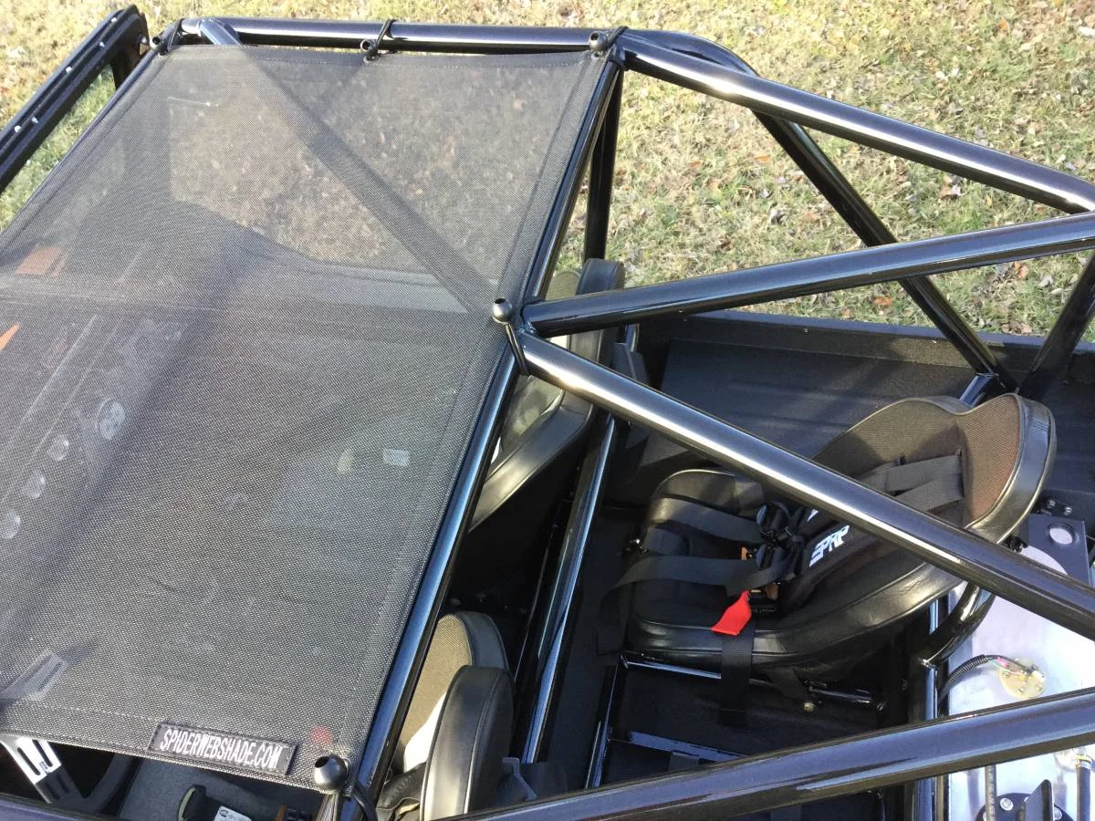

Anybody had a custom bracket made to support two bucket seats in the back?
The aftermarket sest companies support headrest and bucket style seating.

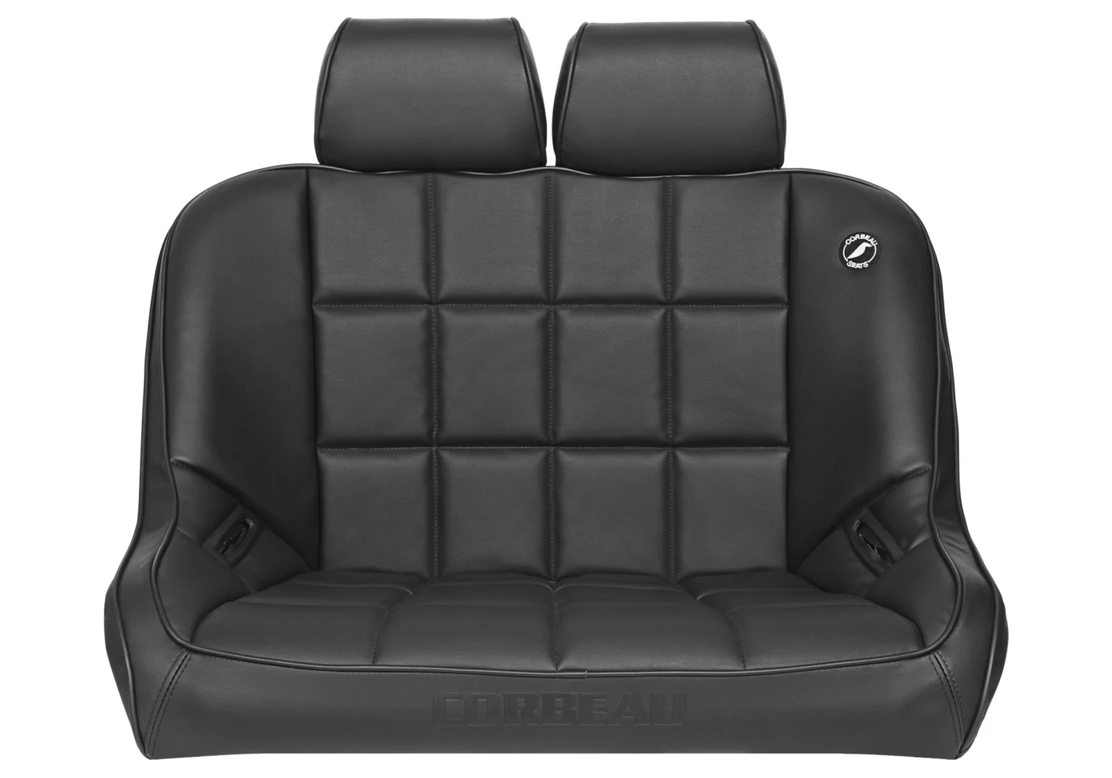

Opps didnt see the part about not buying anothet seat. But I believe you only have two real options. One, have a professional upholster add headrest the correct way to the factory seat. Two, purchase a rear aftermarkey bench seat that has headrest in them that will bolt to the original mounting points therefore, retaining the proper geometry for your factory seatbelts.
I'm sure just about any professional upholsterer could make a headrest look great.
I'm not so sure they could ensure that any headrest will stop whiplash.
I'm not saying the headrests of the seat Chris posted won't do the job, but who really knows.
