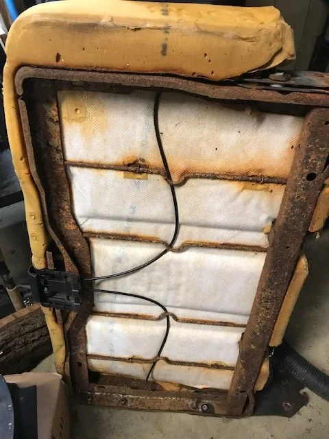

But this is the right side of the seat back ( I separated the back and bottom) First pic is the seat back with the padding

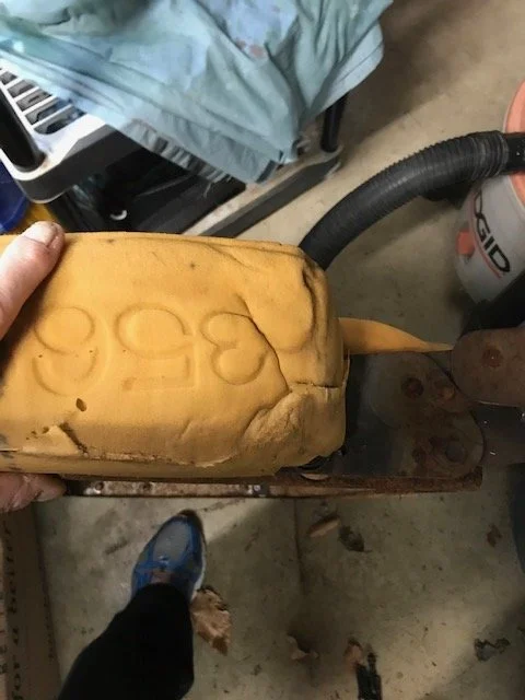

2nd pic is the padding pulled back showing the release mechanism (brighter silver piece)

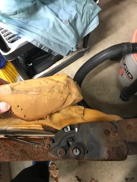

3rd pic is a close up

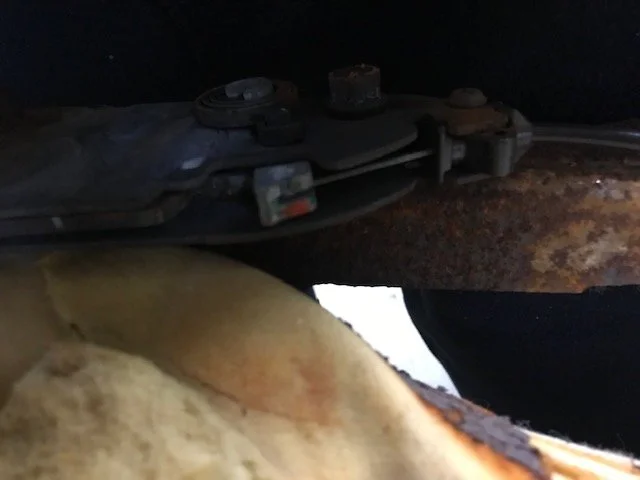

4th pic is a top view of the mechanism. If you pull the mechanism toward the cable stop, it will release the seat back

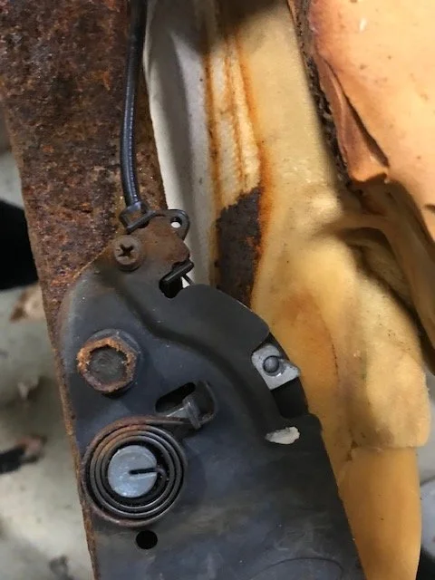

5th pic is the seat back with cable placement.

That's interesting and helpful. I had assumed it was rigged to release when you push the seat back forward but it looks like the hooks should release when you pull the handle. Definitely will need to check and lubricate the cables. Hopefully will find less rust!
