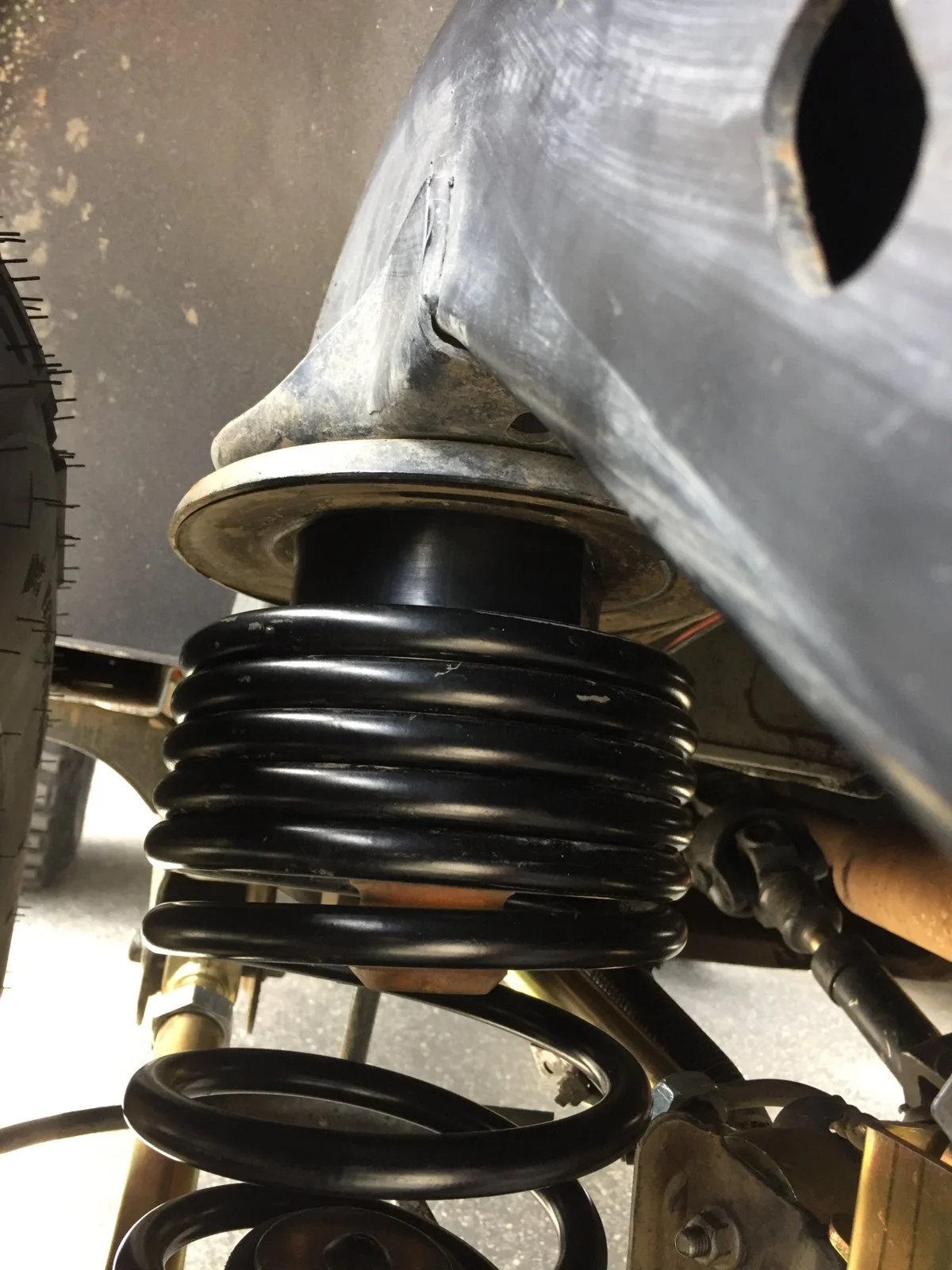

The the butt of my TJ sags slightly and I just put a new Metalcloak 3.5"short arm long travel suspension on it. I also nabbed a pair or Teraflex 1.25" rear coil spacers. They looked a little small and once installed it looks like the spring is balancing on the spacer. I called Teraflex and Daystar and they both said, "yup, thats how they look."
Looking at the JK spacers, the spacers are the same size as the buckets. Why are these not the same size as the Tj buckets. Anyone have any experience, advice or explanation as to why they are like this.
Rough Country makes a 10 degree angle bucket I am considering replacing the spacers with because it fits the bucket and straightens out the spring.
Purely cosmetics. They function just fine like that, but they do look odd, I agree.
So even at full flex the spring wont slide? That is more what Im worried about. At least with the bucket there is a lip.
I don't think the spring will slide at full flex as long as you have your bump stops adjusted accordingly and everything.

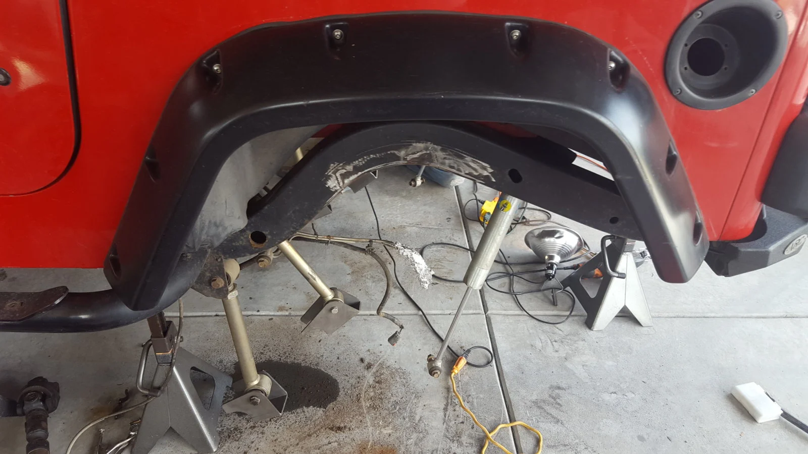

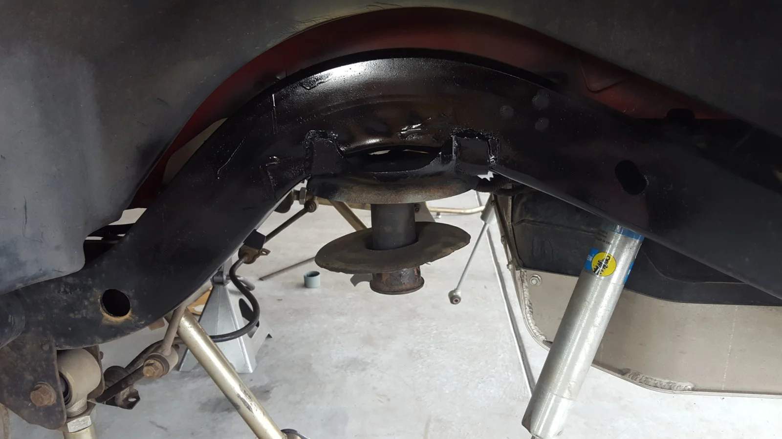

Its cheaper to cut your upper perch to move it in the center of the frame arch, then weld it back into place.
Reactions: JeepZilla380
Just moving the upper spring seats won't do much to change the ride. If anything it will stiffen the coil a tiny bit. The real purpose in doing so is to get the bump stops to line up again after a sizable spring lift combined with a tummy tuck.
Most people move the springs when they outboard the rear shocks. That can create a dramatic improvement in many areas, mostly because it involves upgrading to a nicer shock in a better location and a significant increase in travel.
Here are mine with a spacer at full droop. Nothing is going anywhere because there is nowhere to go.
Awesome! Thanks for the info and photo. It really helps.
