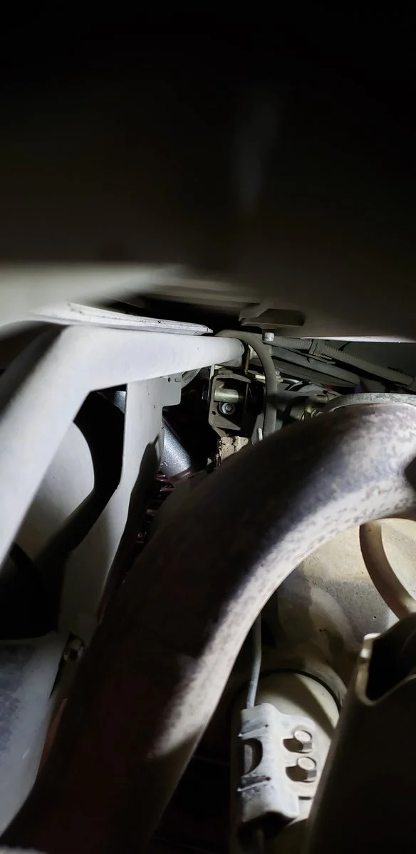

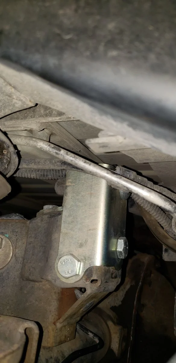

I am currently trying to eliminate as much of my rear bump stop as possible. I have been running 2" and I am hoping that I can reduce that to 1". My issue is that the rear track bar is hitting the tub when cycling the suspension. I currently have the OME track bar relocation bracket installed which raises the track bar by at least an inch. Will an adjustable track bar allow me to regain the extra inch of travel?

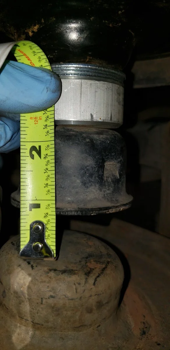

I removed the body lift that I had been running. I may install a 1" body lift in the future. My shocks are Rancho and have a compressed length of 13.75. With .75" of bump stop I have about a 1/4" of travel before they bottom out. This was measured on the passengers side.
OME recommends 1" bumps for the rear so the track bar relocation bracket will not hit the tub at stuff and damage the wiring harness going to the fuel pump. Are you running Rancho RS55241's in the rear?

Years ago when I had the old OME shocks (and a rear track bar) I had exactly 1" of rear bump stop to protect the shocks. With a 1" body lift, there was plenty of room for the relocation bracket.
