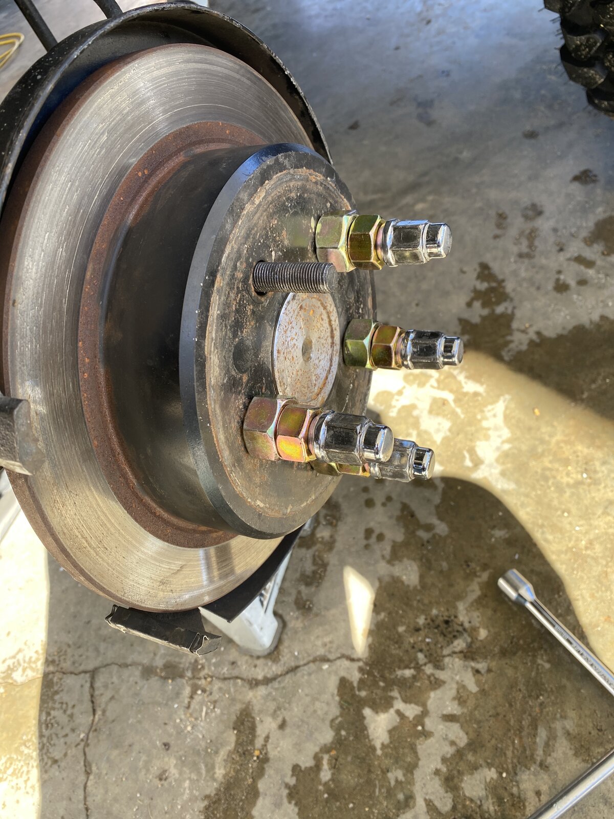

About to remove the caliper and router

You have to lock the rotor in place with the lugnuts if they are deep enough or regular if they aren't.
Oh ok. I’ll try that too. Here is the axle flange and its tracking Straight as a board .

Couple things . 1.I have a striped out lug nut
2. After Tightening down 4 Lugnuts with spacers it’s still wobbling
