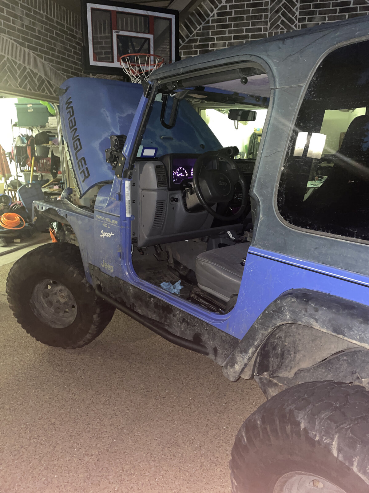

Ok y’all. First things first, we got the AW4 put back together this afternoon. Had some high stress moments around the valvebody but a little brain usage did the trick.
Then we got to mine. Dropped the skid, drained the fluid into a bucket yet again. Then dropped the pan, keeping what felt like at least a quart maybe more in the pan. Lowered the filter (it had 3 miles on it, I’m reusing it). Didnt spill a drop. Considering the bloodbath I normally have under there, this is a momentous achievement.
While I was trying to find the 11mm socket, XJ buddy yells from under the jeep “unless the torque spec is TWO I think this might be your problem!” Yeah, I not only never torqued them, I never even introduced them to a wrench. Also: my valve body has “always” been missing one bolt. I had the missing one in a different spot from before, I corrected that. I also forgot that I ended up with an extra valve body/transfer plate screw. I now recall that I could not get it threaded in the hole, and I never went back to deal with it. We got it in this time. Dunno to what extent those last two things are a factor, but at the very least it’s now bolted up how it always was, and properly torqued.
Filled it back up (tightened the pan bolt this time), skid back on, test drive…..
Flawless. If this were Reddit, I would give it a 5/7; a perfect score. Every shift is where it’s supposed to be, lockdowns, lockups, slow speed downshifts. We’re good.
I’m still a little bit concerned about the temperature. It was around 185 just now but it’s hot out and I was driving it pretty hard. Put it into park and it crept up to 200 and stabilized. Tomorrow I’m gonna take it on a longer run and see what the temp does. I want to fully understand the current sitch before I plumb in the cooler.
And since I’ve been all words and no pics for a while now, I’ll give you an evening shot of Big Juicy, having once again driven & parked under her own power.
