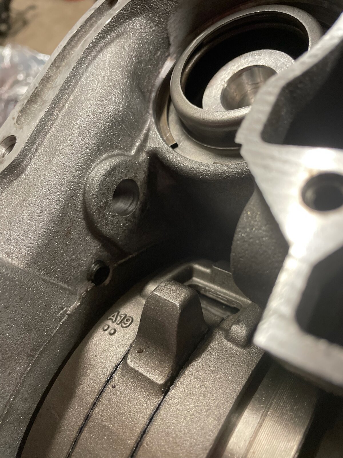

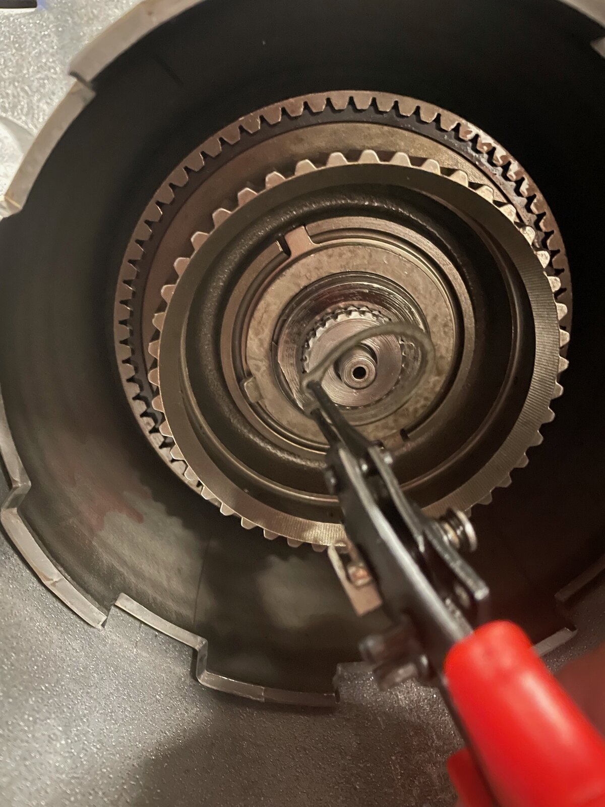

Man, I really thought it had them in right, but the amount I'm off is roughly the length of a tab on the planetary thrust washers. I did not disassemble the planetary sets, but the one that slides out of the driving shell did come out. Both of those had tabbed washers on the backside but I'm pretty confident I had them seated. And yes, they're fun when they fall off when you tip them down.

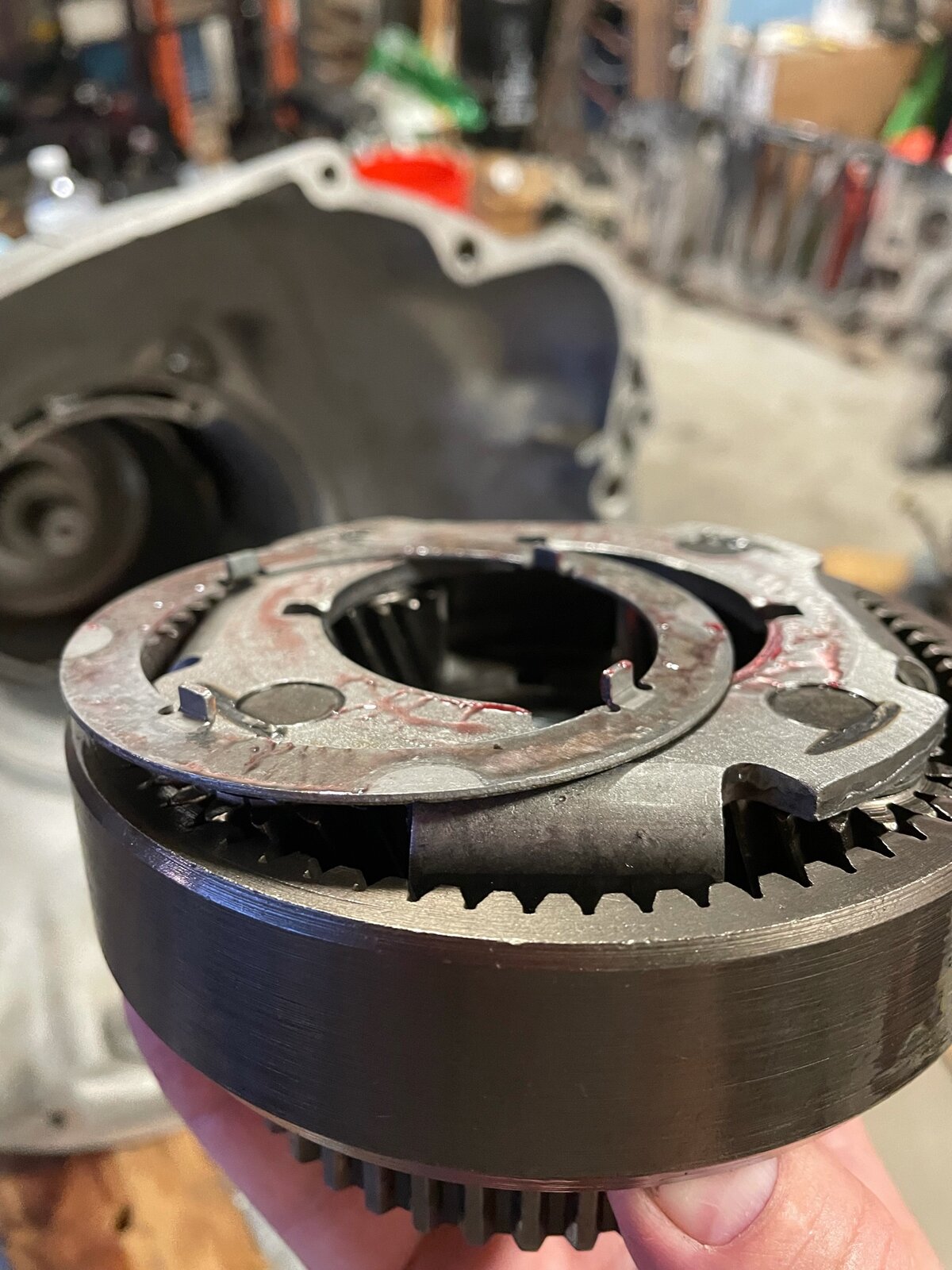

Ok, I resolve that issue. Turns out the tabbed thrust washer on the planetary set that goes inside the low/reverse drum had not been seated correctly. That tab width was just about the amount I was off by, and sure enough when I seated it correctly everything sat down nicely.
More explicitly, each planetary set has a tabbed thrust washer, this is the "outermost" one which drives the sun gear attached to the driving shell. I have it upside down and offset for your viewing pleasure. It has to go into those notches on the back of the planetary. If you assemble it upright, those like to fall off. You can use grease to hold it in place, but I actually found that assembling everything up to the first clutch drum to be easier if I did it at about a 20 degree angle above horizontal. It helped keep stuff in place as you slide things on.

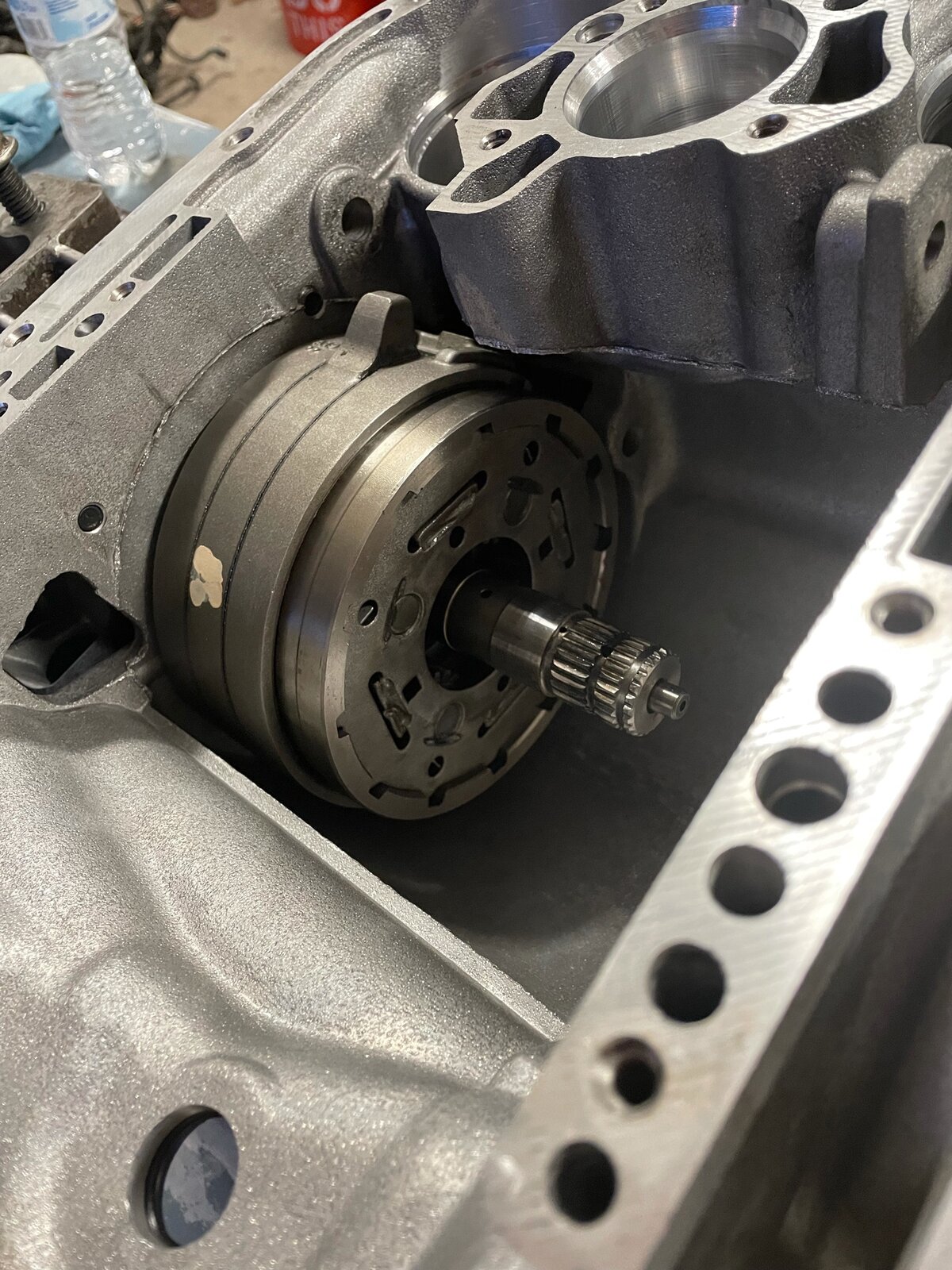

Here is the sun gear on the back of the driving shell which fits into another planetary set which itself splines into the low/reverse drum. Note the tabbed washer is "stuck" to the sun gear, but it needs to be on the planetary below it.
Here is the rearmost planetary, the one that goes into the low/reverse drum. This planetary ALSO has a tabbed washer on the other side. I don't have a picture of it pulled out, so you'll have to trust me. It was there, and it was misaligned. You can see here it is recessed slightly into that drum; while the washer was misaligned that planetary was pretty much flush with the drum (not pictured). I took all these piece apart several times trying to identify the gap, but I never went all the way to the bottom because it looked it fit ok. Lesson learned I guess.
With everything fit together nicely, the groove for the c-clip was visible and easy to install.

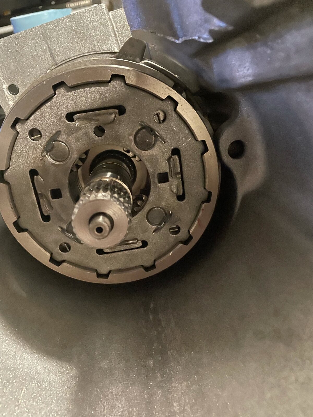

I'll get to the rest of the install pics from tonight in a bit, but for now let's talk about the play in the input shaft. I've got the (new!) kickdown band tight to hold the front drum in place, but I don't love how the rear clutch drum is free to wobble. I'm pretty sure all the clutches are engaged, and I I'm also pretty sure the thrust washers stayed in place (I had the same "keyed 3 tab" washer as you, @U8MYDZT ). Now the clutches are free to slide laterally in the drum, so the only thing really keeping that drum in place is the little nub that the thrust washers center over, and the whole thing rides on the end surface of the output shaft, near as I can tell...which means this sort of play at this stage is ok? It feels weird, given how positively everything else fits together up to this point.
Thoughts?
Thoughts?
Pretty sure you're fine. As long as you have all the clips and thrust washers installed it will all tighten up as you put everything together
I’m sure you’re right. I wish there was a way to see that particular alignment, but it is what it is.

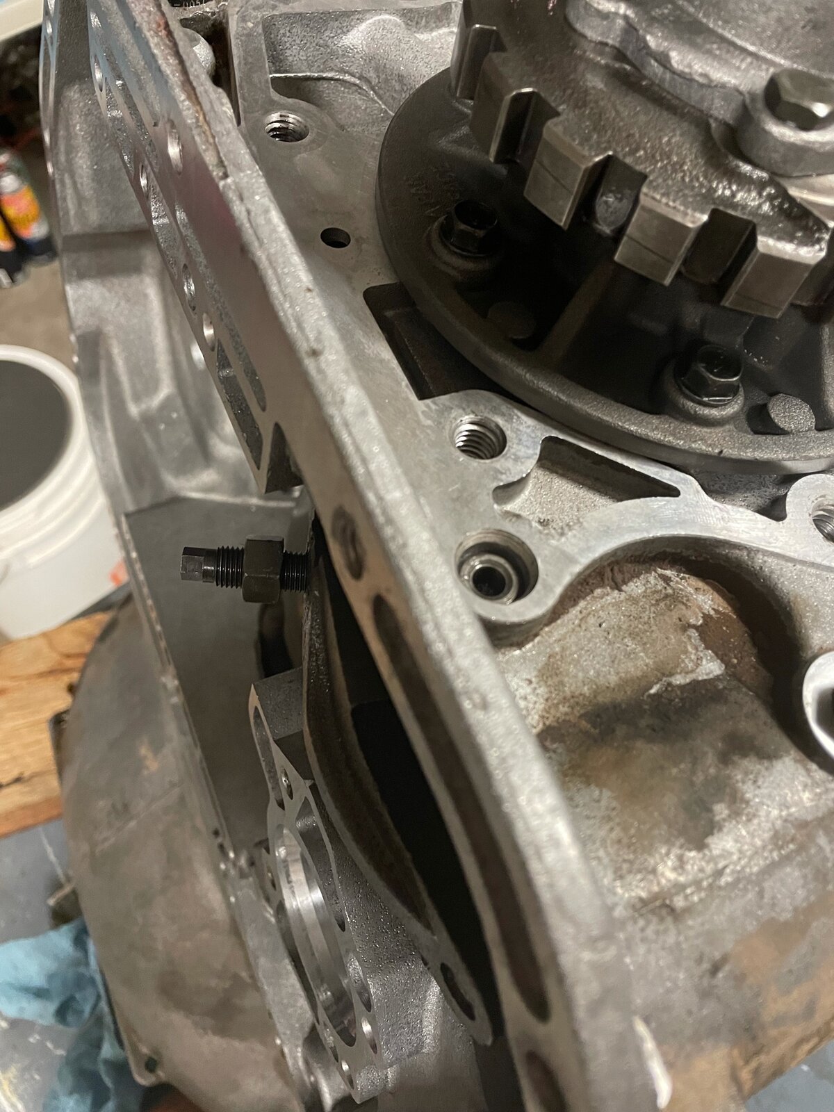

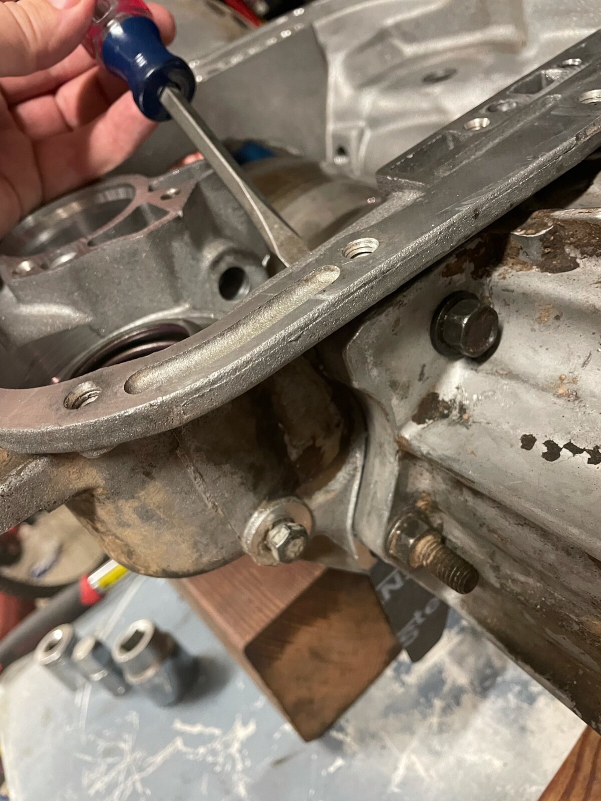

Let me tell you, I was close. I was nearly convinced it was an issue with how well I seated the output shaft & governor assembly, but to inspect it meant I would have to take the extension housing back off. But if it wasn't in far enough then just giving it a little tap tap taparoo with a BFH should seat it the rest of the way right? And then not have to hassle with taking off the housing, right?
Turns out I had to take the housing off anyway because the low/reverse servo has a pivot rod, and the opening that rod goes into is hidden behind the gasket & extension housing.
That recessed black plug looking thing is the exterior end of the servo pivot. It just slides in & has 2 o-rings on it to seal. The extension housing gasket covers it up, and then the extension housing itself lays flat over top of that. I'm usually one of the people who replies on the "help me with my transmission leak" threads, but having gotten neck deep in this thing I'm now realizing just how many places a transmission could leak. Even the extension housing bolts...the holes they thread into on the case are open to the interior of the trans. FSM doesn't say anything about RTV or teflon tape....I never leaked from that spot before but I'm expecting to in a few days. But I digress.
The pivot rod is behind that corner flange on the extension housing. The tip of the screwdriver is on the other end of the opening. Note that the stud bolt is in the wrong location here, it goes on the other side.

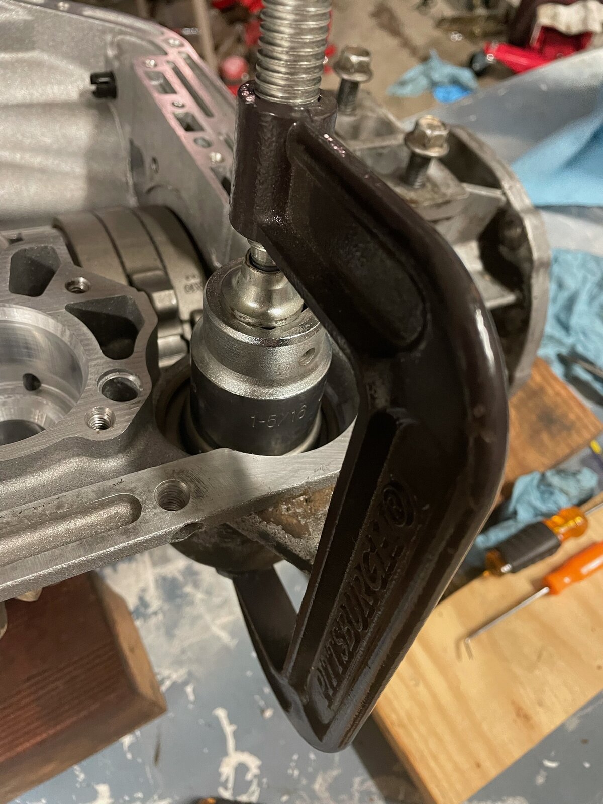

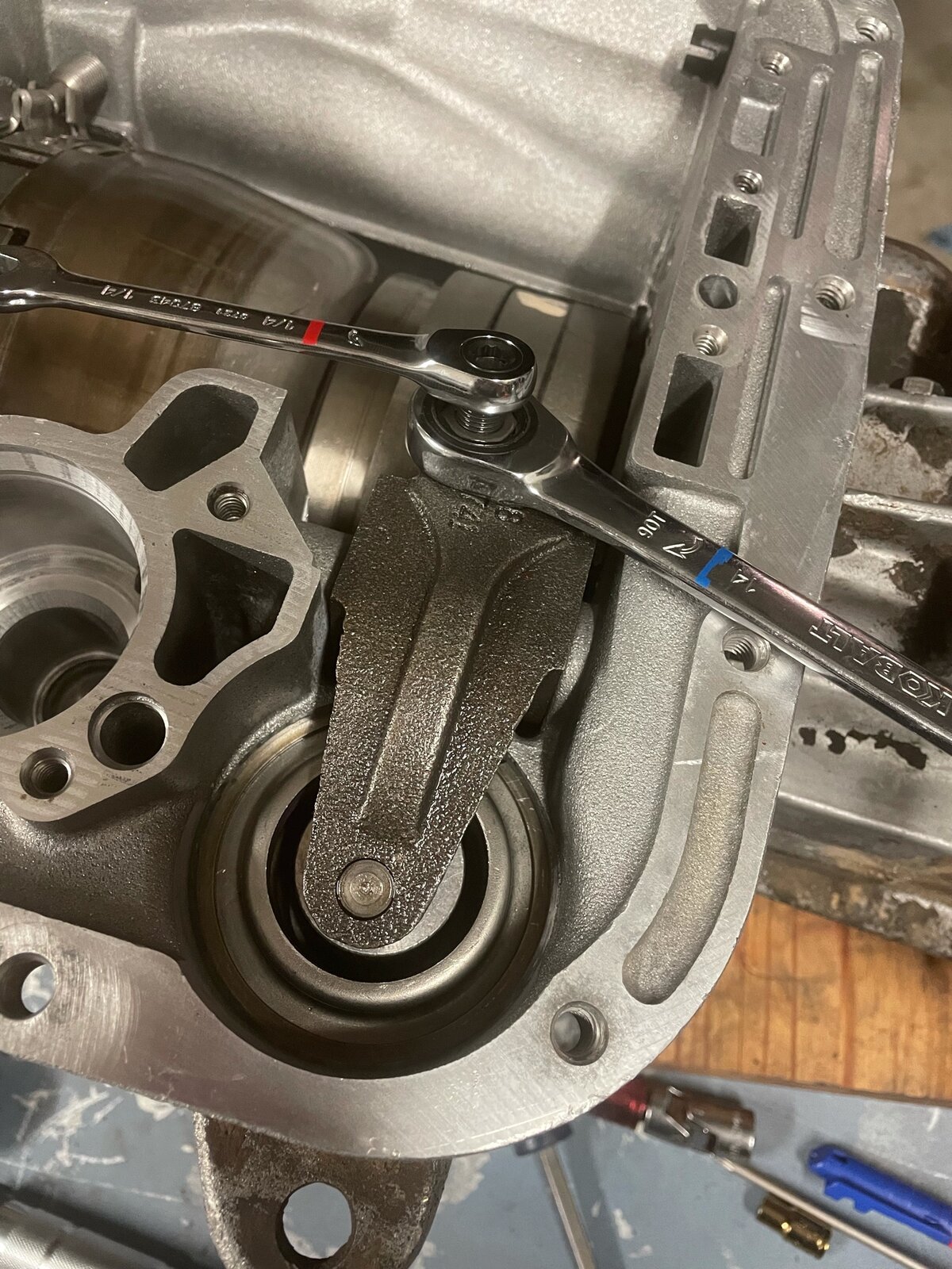

Reassembling the servos turned out to not be that big of a deal, although the lock rings are kind of a pain. The biggest trick is compressing the pistons enough to expose the lock ring groove. On the rear servo there is no solid surface to compress onto. Luckily I have a 1-5/16" socket which fits on the lip of the spring retainer, allowing me to compress the spring. If I had this to do again, I would likely use some large fender washers instead of the socket. That socket put the clamp at the very end of it's travel and it didn't want to seat well on the socket face. Washers (as I used on the front servo) are probably a better choice in hindsight.

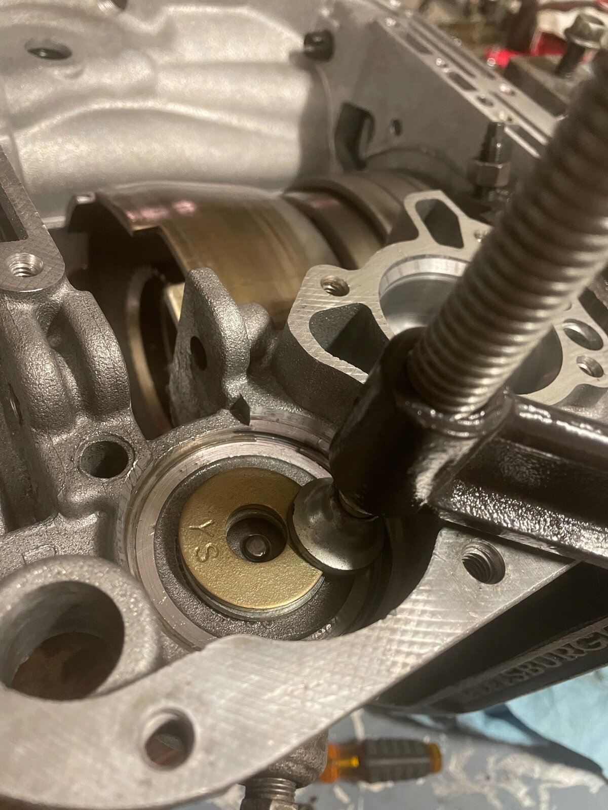

I figured I'd do the low/reverse band adjustment while I was here. The process for the 32RH is to back off the hold down nut and then tighten the screw to 72 inch-lbs, then back off the screw 4 turns, then tighten the hold down nut to 25 ft-lbs. Consult YOUR factory service manual for specifics on your transmission. My FSM also said it was a 5/16" screw but it was actually 1/4". I set the torque on the screw, then put a sharpie mark on one corner of the screw (it has a hex head) and backed it off 4 revolutions. The hold down bolt was 14mm, and I used my ratcheting wrenches to allow me to hold the screw stationary while tightening the hold down, and allowing me to verify the orientation of the adjuster screw during the process. Interestingly, when I did the teardown, the hold down nut was backed way off so the adjuster screw was free to move. I don't know if it did, but it was certainly able to.
The front servo is a different challenge. You have a solid surface to press down against, but there is a piston rod that pokes through from underneath, and you need to compress the upper piston slightly past the point where the rod comes through. Meaning that if you use a c-clamp on the center of the piston it will end up fighting the rod. I put some washers over it to provide enough clearance. Remember to not compress the spring past the lock ring groove; you don't want to scratch up the piston bore putting in the lock ring. (I have the clamp slid off to the side so you can see what I'm talking about).

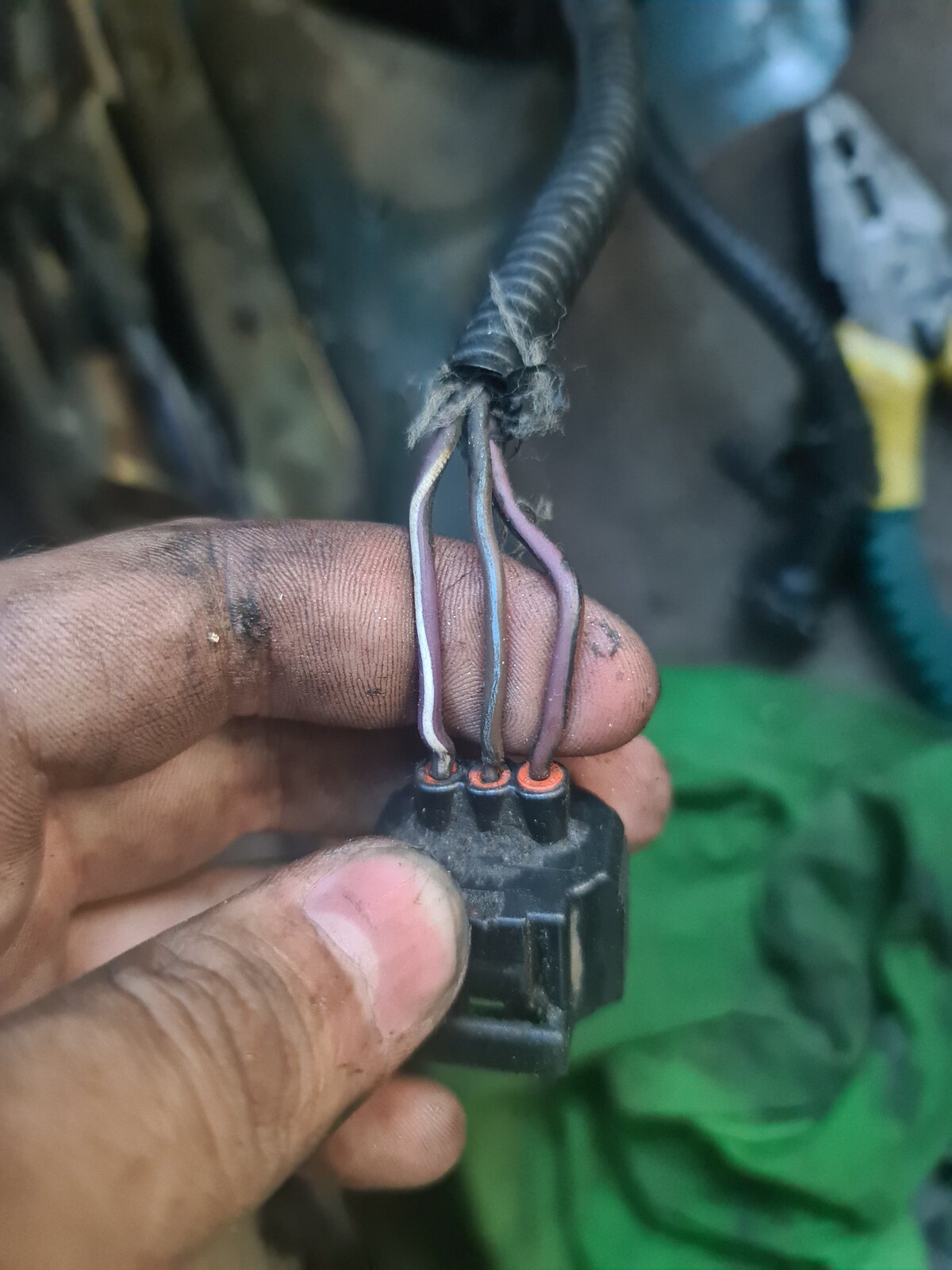

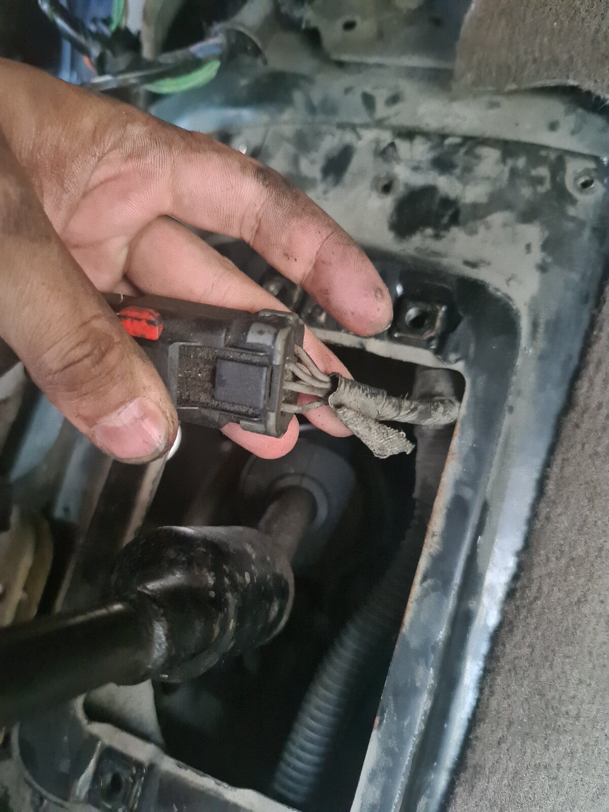

Sorry for hijacking the thread. But i need a help. I throwed away my 32rh after it died. I already installed the ax15 with all other manual things. Now i need to wire so the engine can start. Also rear lights should work. Here is the nss wires. Which ones should i connect to each other(nss bypass???) And which ones should be connected to rear lights sensor on tranny.
All writeups about tranny swap wiring are made with aw 4 and etc they have different wirings. I am not an electrician so ye can use plain language
