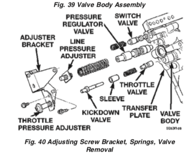

Ok, we may be on to something but I'm going to need help from the gallery regarding the assembly order of the throttle/kickdown valve. The FSM and the ATSG manual show two conflicting ways of sequencing the kickdown/throttle valves. Since I'm having trouble with the shift points & kick downs, this seems like it might be relevant to our interests. I know some versions of the FSM have the switch valve flipped (thanks @U8MYDZT), and I've already proven that the ATSG has at least one torque spec WRONG (not just wrong), so neither document are infallible.
Here is the sequencing according to the FSM. Note the sleeve goes on the kickdown valve, and the sleeve contacts the spring. The sleeve fits differently depending on which way it faces, which matters with this sequencing. I rewatched my assembly video, and this is how I did it.
However the ATSG manual has it with this sequencing, with the kickdown valve pointing the opposite direction and the sleeve (aka kickdown detent?) on the outside facing edge.
Seems like the FSM way will only allow a certain depth of valve travel, but I'm not sure how the sleeve plays into it. The ATSG way seems to allow for more valve travel, but I'm still not sure how the sleeve plays into it. Knowing that they call it a kickdown sleeve here makes me obviously think it controls kickdown somehow. And now I feel less sure about which way that sleeve goes on. Pretty sure it makes a big difference now.
I'm hoping somebody here *knows* the right sequence, or else I'm going to troll 904 valve body disassemblies on youtube until I catch a few frames of how these valves fall out.

Draining the fluid yet again. My calendar is wide open today, plan to pull the valve body & rearrange the valve in question. While it's all dripping down I'm going to compare the FSM & ATSG on the remaining valves, and then double check against my videos to make sure I've got them installed correctly.
My #1 fear here is that it's going to be a pain to get the park rod back into position while upside down & with fluid dripping into my eyes.

This shift point thing was starting to wear on me, but knowing that valve has minimal travel due to the bogus installation instructions has renewed my vigor. The only other actual problem I ran into was just a rookie install mistake of not lubing up a seal prior to install. I guess it remains to be seen, but I'm confident that we're going to be fully operational by the end of the day. So I was one lubed seal away from nailing it on the first try.

Can it even go together the wrong way? I don't think the valve assembly will even fit in with the bushing by the spring.
Oh but it did. It looked pretty correct once fully assembled & inserted. I’ll be sure to take a pic before I take it apart. Interestingly, I take a LONG pause in my assembly video on this valve because I don’t feel like it’s in the right order before it goes into the bore. But I trusted ye olde FSM.

Here’s how it exists currently. You can see that with no throttle there is a large gap between the throttle “applicator?” And the end of the valve sticking out. So I can give it a lot of gas before the valve sees any movement.
The larger flange on the valve is more or less flush with the edge of the bore… it *looks* like it could be right as I have it so this is a somewhat easy mistake to make I think.
