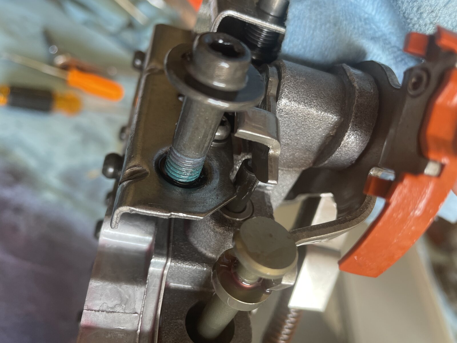

There must be fluid pressure pushing the throttle valve back out when the thing is operating. I can get the valve to slide out to the point where it ALMOST contacts the "throttle applicator" (the part that rotates & presses in on the valve when you hit the gas) when I have zero (virtual) throttle applied. The kickdown detent sleeve also slides out part way and is stopped by the bracket. I'm guessing that fluid pressure pushes that detent out, so when you give it enough gas the detent gets pushed in as well and then magic happens. I think I may do the initial TV cable adjust with the pan off so I can better see what all is happening inside. There are still some bits of the geometry that doesn't make sense to me.
Also can you confirm that my throttle pressure screw/bracket/"throttle applicator" is all assembled correctly in post #205? You can put it back together such that the throttle applicator cam is behind the bracket, but I don't believe that is the correct way.

You have it correct. The throttle pressure adjustment screw's flange acts like an end stop for the little cam. Thats why the flag is there on the cam. I believe when everything is installed correctly you should have about 1/8" (don't quote me on this it's just something I read and not verified) between the cam and rod with the cam pulled against the adjustment screw.
