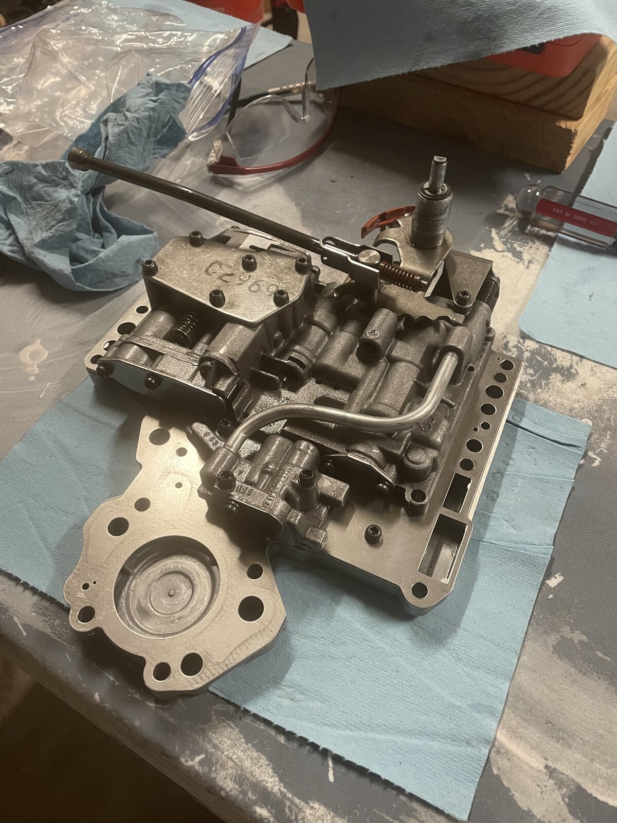

Cleaned & re-assembled the valve body. A few steps are tricky and sometimes a 3rd hand would be helpful, but it’s all doable by amateur hands. I’ve actually reassembled it 3 times now and can pretty much do it from memory.
Torque spec on these screws looks to be 35 in-lbs, so basically hand tight with a screwdriver. I happened to have a T-25 screwdriver which proved to be very helpful, rather then using a torx socket & ratchet. Some of the screws are hard to get started as you’re trying to hold all the springs in etc. The torx screwdriver made it a lot easier.
For cleaning, I sprayed everything with brake cleaner and then hit them with compressed air. On install, I lubed all the bores and the valves with ATF before I replaced them. Not sure how much that really matters, this whole thing is going to be bathing in ATF before long.
Very happy to have my first subassembly overhauled and back together. It should be much easier from this point on.

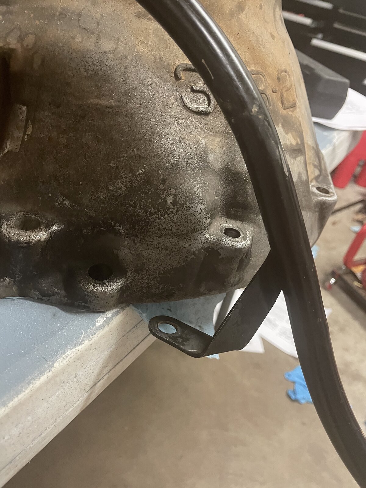

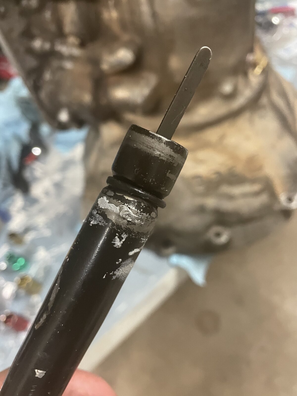

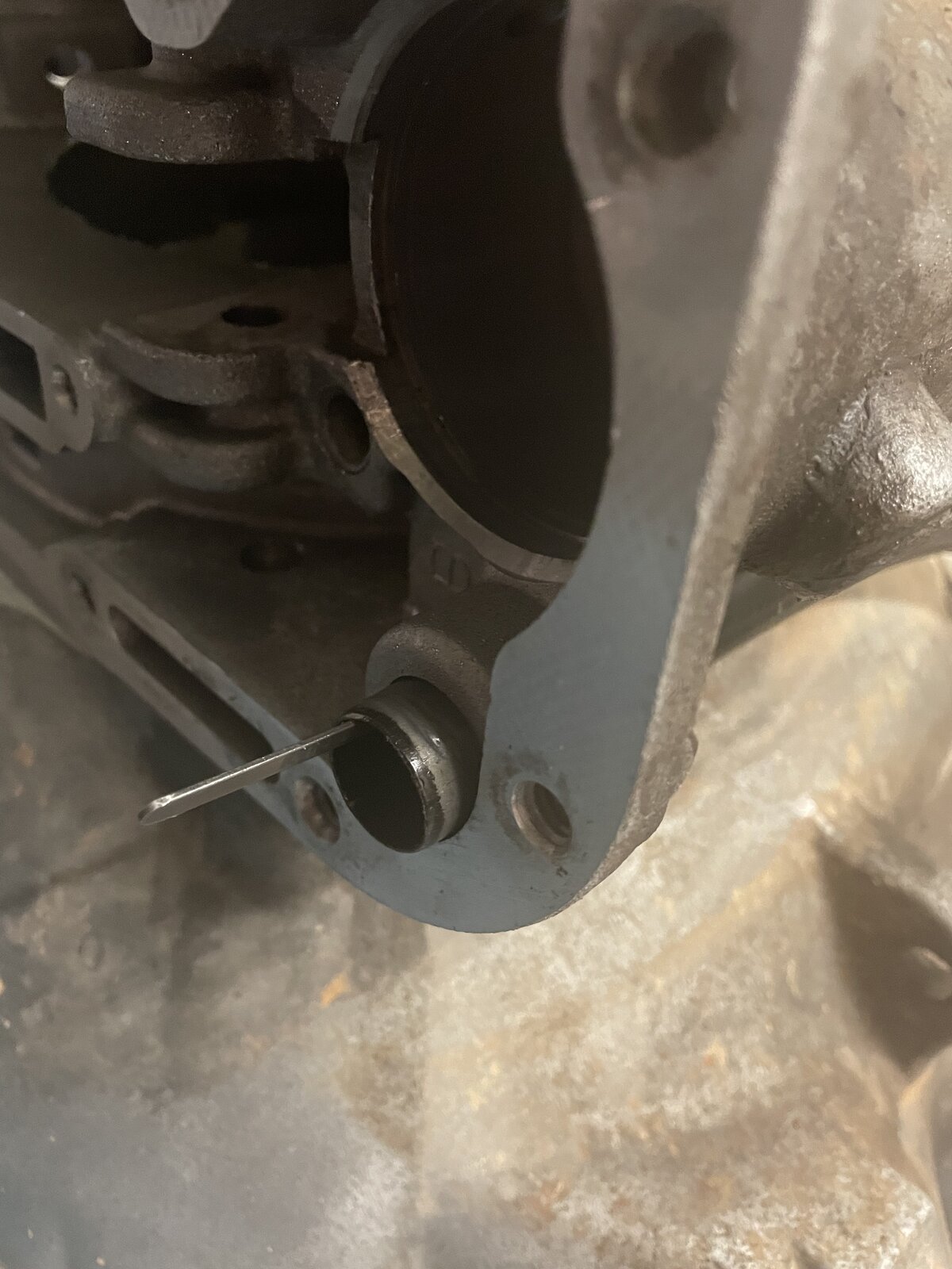

On the topic of ye olde dipstick…
Ever since I dropped my trans last summer the dipstick has been a thorn in my side. When I dropped the thing, I definitely unbolted the bracket on the dipstick tube from somewhere on the bell housing. Where? I wish we knew.
When I went to reinstall it, the only way I can make it bolt back to the bell housing is by having the other end of it barely in the hole. So much so that it leaked like a sieve. So I shoved it in further and didn’t attach it to the bell housing. It still leaked, but less. I finally resolved it with a little bit of The Right Stuff. It didn’t leak, but it had some wobble to it that I really don’t like. So I want to fix it right now that it’s out of the jeep.
You can see with how far it’s in that it can’t reach either hole. There’s no way it can go in far enough to reach the next lower hole on the bell housing, and for it to reach the “nearest” hole it would require bending the tube and the bracket.
This USED to fit fine, would love guidance on how to get this squared away.
The FSM seems to suggest a different bracket than what I have, or maybe it's just a bad perspective.

Ok, I can see that now, although I'm not convinced it's going to seal well based on past experience. Getting the bracket lined up with the bolt hole puts the bottom edge of the dipstick pretty much flush with the opening on the inside of the case. That seems like how it was probably designed. I know Mr. Blaine has used some sort of grommet in addition to (or instead of) the O-ring, but I was not able to figure out how to make that work. And the '97 FSM just says there's an o-ring. I had a box of 5 of those grommets but of course now I can't find them. I wouldn't mind trying them again.
U8MYDZT
Wrong guy to follow
Sep 24, 2019
586
North San Jose
Mine did the same, I had to bend the bracket around to get everything to line up. It will work, just don't be afraid to move the little tab as needed to get things right.

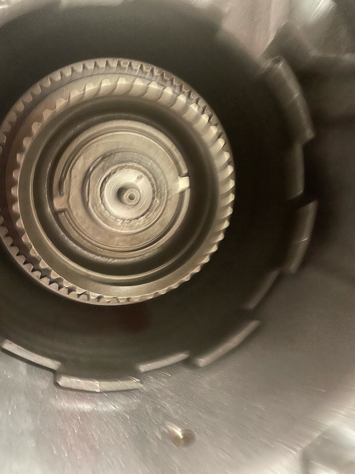

Today is re-assemble day. I have opted to not fully disassemble everything. There are some sub-assemblies that look fantastic (further evidence that this was recently rebuilt?) and it just doesn't seem necessary. If I had more time and a larger workspace I might consider it. It's just more of the same; lock rings and thrust washers, but it will expand the number of pieces on the work table by about 5x. And then obviously the risk of not putting it back together right, but also I'm a little scared to introduce new parts that could change my clearances. My components all look completely new, actually.
Two other areas I'm not touching: The brass bushings. Mine look GREAT. The other area is the front drum piston, because I don't have the tool to compress the spring. I bought one off Amazon, but it was a piece of crap and wouldn't even fit. I'm comfortable not touching this spot based on the condition of the rest of the transmission. Obviously the kickdown band was trashed, but I found no evidence of debris anywhere else. When I put the new clutches in and check the clearance, if the clearance isn't within spec then I'll go ahead and solve for the tool and overhaul the rest of the unit.
So if you're keeping score at home, this is all I really will have ended up doing:
  • disassembled drivetrain to the sub-assembly level
  • replace kickdown band
  • polished front drum
  • replace low/reverse band
  • replace clutches
  • disassembled/cleaned valve body
  • thoroughly cleaned the inside of the case & extension housing
Hopefully not going the remaining miles is not a mistake.

It may have been rebuilt, or not. It isn't unusual to find some or all of the clutches with minimal to no wear on a non-slipping or non-flaring unit. I saw that at the dealer. The best example was when I pulled down the TH400 (leaky) in my old 68 DeVille all of the clutches still had the GM part numbers printed on them. I replaced all the soft seals and put it right back together and into the car.
Good call on leaving the bushings alone. Some of those set endplay and really don't need messed with unless you have to due to wear or damage.
I'm interested about your theory for the band failure.
I'm not a trans tech per se, but have had a few apart. Usually the failure becomes evident as you start inspecting things.

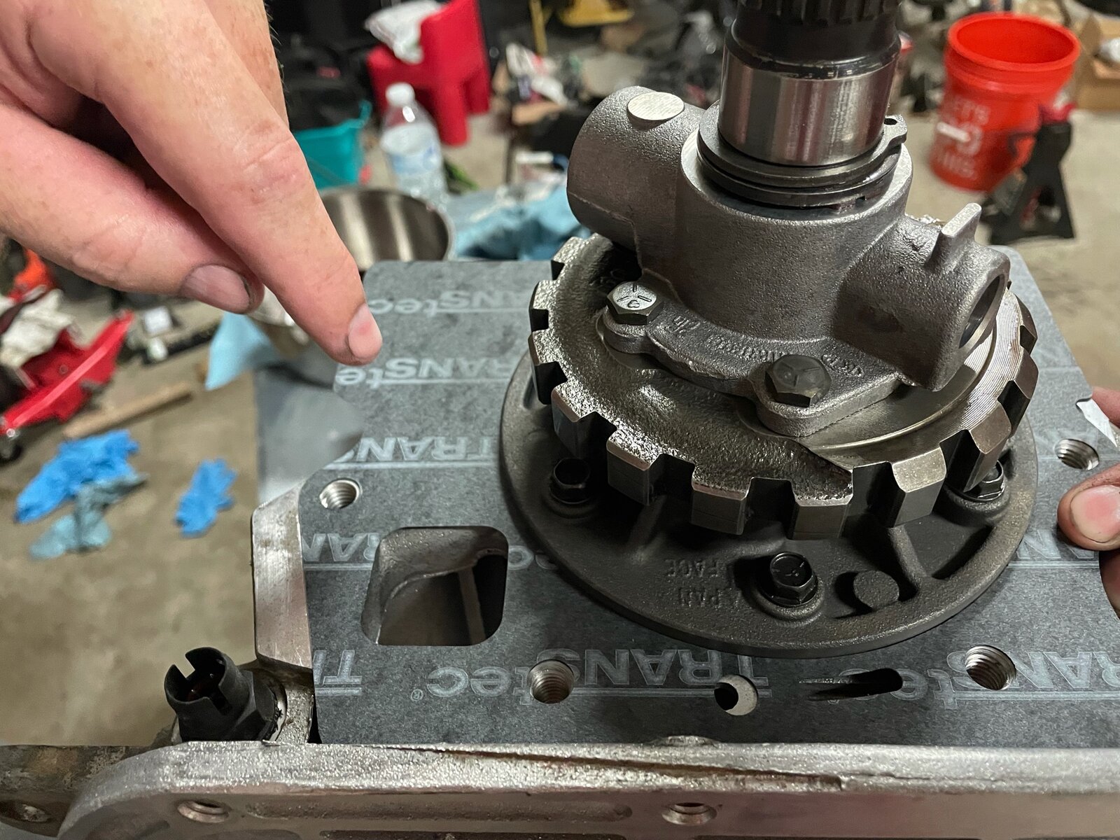

Hit my first real setback tonight: I can't get the snap ring on the end of the output shaft, I'm taking about the one pictured here, or at least it would be pictured here if I could get everything seated enough to see the groove the clip would sit in. And it looks like the picture came out blurry, but this is the spot.
I have the governor & output shaft install, which I did not teardown at all; I just pulled the entire assembly out. In hindsight I probably didn't even need to do that, but what's done is done. So I put that back in and re-attached the extension housing. I installed the one-way clutch (re-used the old one as the new one is plastic so I'm getting my money back on that. Then I added the new low/reverse band and installed the low/reverse drum. It has to be in far enough because it sits behind a lock ring which I was able to easily install. That rear drum looks like it's about as far bask as it can go. The planetary gears and all the stuff that build up from there are all seated well, everything spins freely. But I'm like maybe an 1/8" away from being able to see the groove for the c-clip.
the rear end of the output shaft (the part in the extension housing) does seem to have a fair amount of end play which tells me something isn't right. If I push in on the output shaft from the tail housing, it pushes out the planetary gears that sit inside the rear drum, and everything pushes out with it, so I don't gain any clearance on the other end. I feel like I got the output shaft seated well, but how can I tell?
(sorry for the vertical video, I'm old)
Also had to tweak that gasket to clear that hole a little better. But that's the least of my worries right now. I'm packing it in for the night, I guess my plan is to remove the tail housing and see if I've got a problem in there. It did seem to drop right in without a fight, so I'd be surprised if it needed to go in further.
