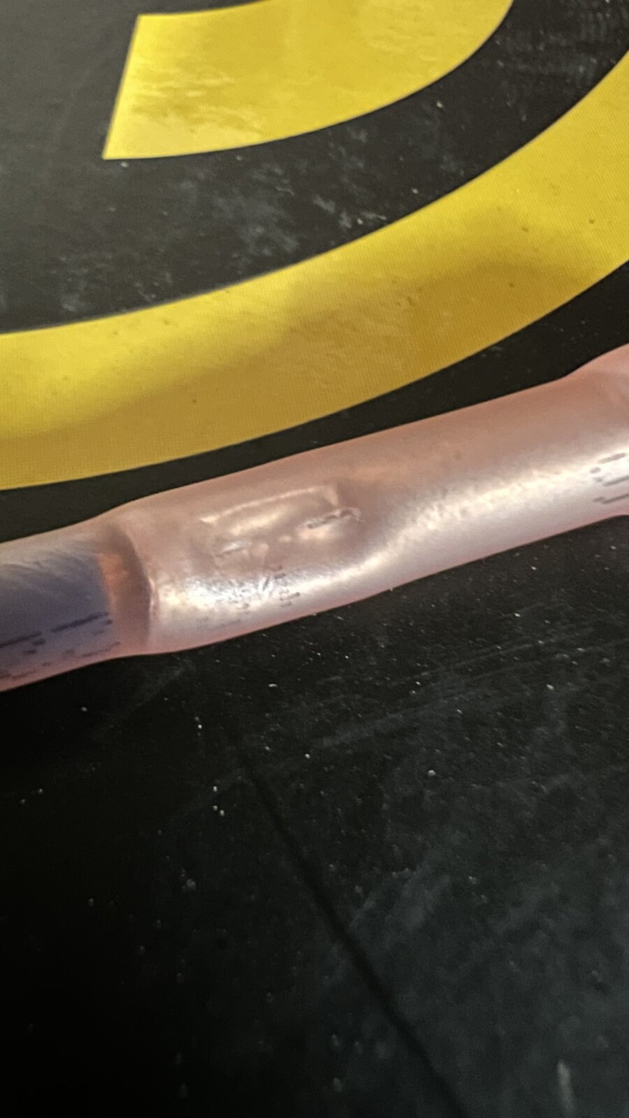

I use non insulated so I can ensure a good crimp. Heat shrink butt connectors are a thing I don’t agree with. It’s difficult to get a good crimp without compromising the heat shrink.
Use the Del City heat shrink butt connectors with the staking side of the crimp tool. Even if you manage to punch through the heat shrink, the adhesive seals the hole without any adverse damage to the connection whatsoever.
It is exactly the same crimp as a non insulated, I promise.
The crimpers i use will destroy the heat shrink but Ill try some this weekend as a test.
If you want to save some coin, browse Waytek Wire. they sell the perma seal heat shrink butt connectors for almost 1/3 the price of del city.
I don't want to save coin, I want to use heat shrink butt connectors that you can't hurt the insulation on, so I do.
They did well with the standard crimping pliers. Still far too bulky for my likings. You should try the perma seal butt connectors. I believe it’s a much thinner heat shrink.
I don't use them where I am worried about bulk. I use them where I need a sealed connection and bulk doesn't matter and I know how to stagger them in a 2-5 wire harness so they don't cause an issue. If I have a bulk problem to solve, I use uninsulated barrels and adhesive lined heat shrink.
