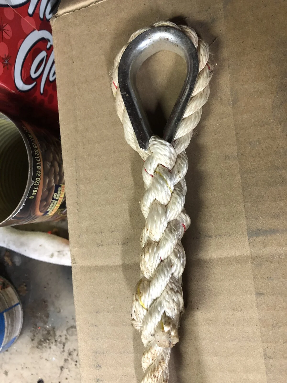

I prefer braided because for a give size and material it is stronger. The upside to twisted rope is that it is easier to splice or make an eye.
Have to disagree somewhat with a qualifier. If you are using something equivalent to what the winch lines are which is typically a 12 strand hollow braid, you can do an eye splice in a scant few minutes with little more than a barrel from a Bic Pen. I can do an eye splice in twisted, I don't know if that is a common skill folks know. Anyone can learn a buried tail eye splice in a few minutes, getting the over/under correct on twisted not so much. (don't forget the qualifier)

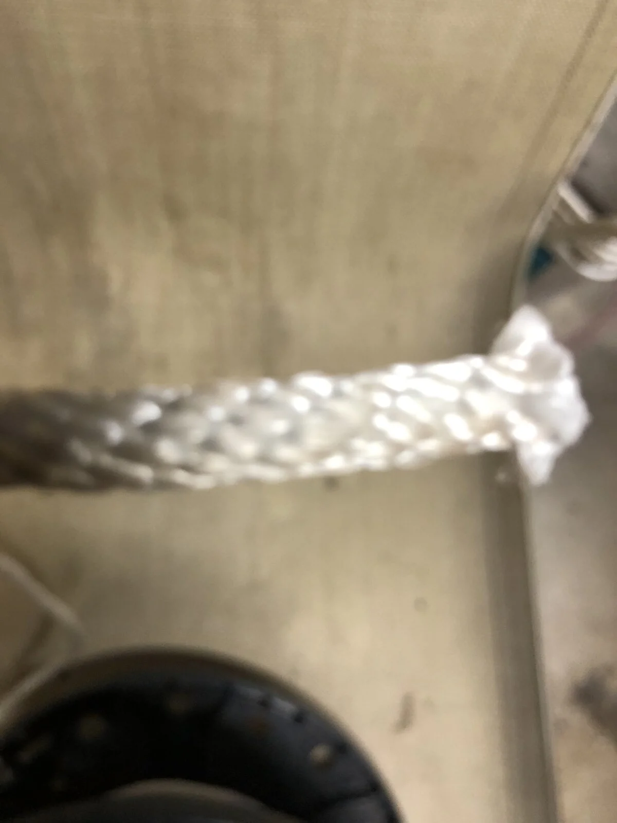

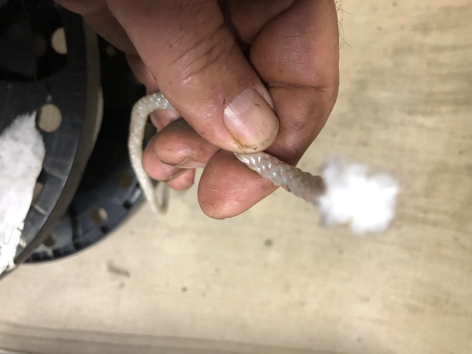

I agree with you, a hollow braided line is much easier especially if you do not taper the end. I use a piece of tv antenna witch works for large diameters. I was talking about a solid braid line like the picture below. I find that weaving a twisted line is easy once you know how to do it. Most guys were not Boy Scouts or in the Navy and do not have rope skills. It’s amazing the number of knots out there. I have several books on the subject but I’m still an amateur and have to reference them often.
The picture below is just for reference. I do melt the nylon rope ends to prevent fraying. I use wiping on larger rope but I mainly use 1/4” nylon or 5/8” truckers rope so melting works OK even though its not pretty.
