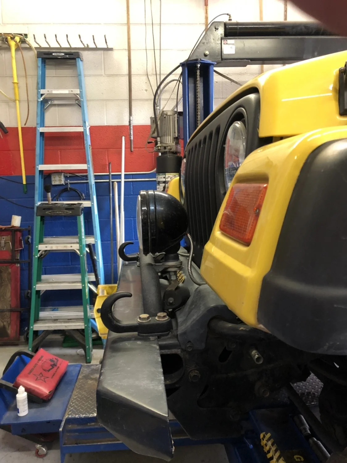

They aren’t further back. The way the bumper I had mounts makes them look further back. But they are bolted to the frame with the 2 bolts mentioned above. Those are your only option unless you get a different bumper with built in D-Ring tabs.
Like this.
You may need longer bolts, depending upon whether some were already on and then removed. Make sure to get grade 8.

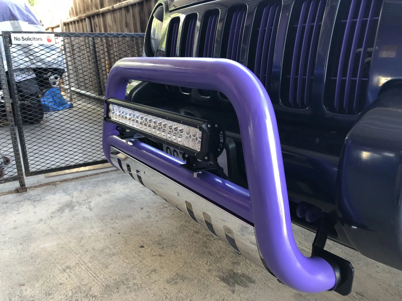

Here is the bull bar I am going to try to put on. I know it is not made for actually doing anything, but I liked the looks of it. Just don't know if I will like it on the TJ. Looked great on the Liberty. LOL

Yah, I will attach them to the bumper frame bolts. :D

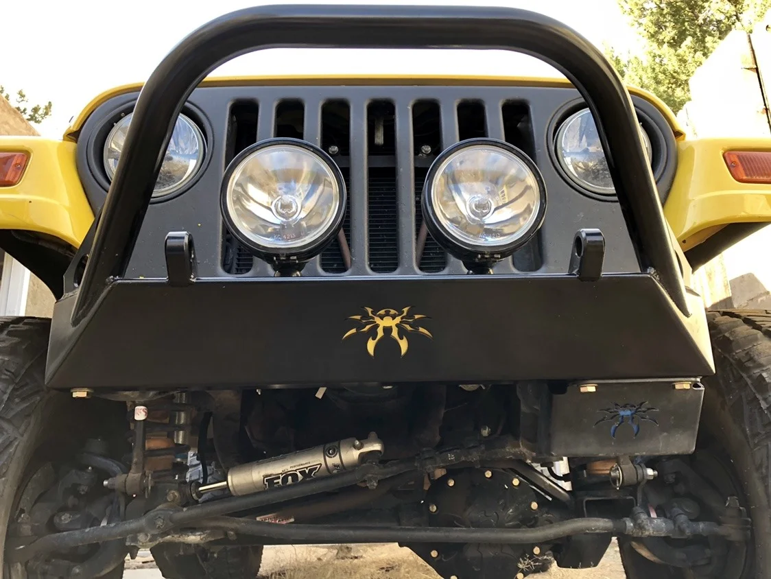

Another thought. If your bull bar doesn’t work. I would pick up a bumper with a small stinger.
Something like this.
