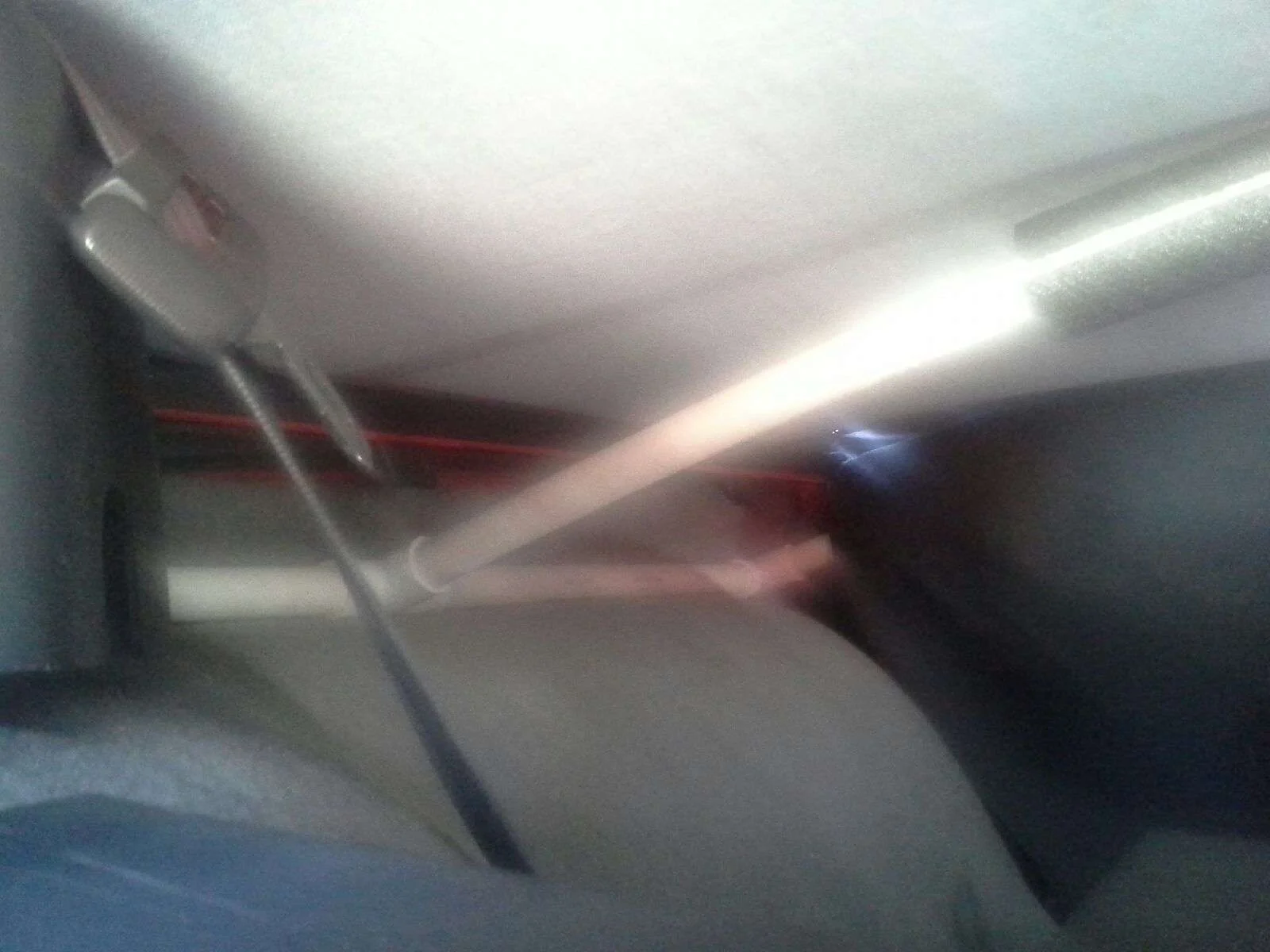

So, PVC prop. I can honestly say that for once something went according to plan/easy. Mendards already had five (5) foot sections of PVC in 1/2" diameter that I was looking for. Found four 90* elbows and two "T" connectors, some foam pipe insulation, and I was set. PVC went over the Instatrunk and through the "doggy door" of the windjammer without a hitch, plenty of room for other things I picked up, and back home I went.
Before I got busy I checked how a 5ft section would fit. Answer: not very well to be honest. This was expected as one of the write-ups on a different forum mentioned trial & error size reduction until they hit 58 1/2". So marked that on one of the pipes, cut it down, and found it did indeed fit "just right". Marked another pipe at 24" inches, cut it, had my "sides" to sit on top of the wheel wells. Attached them with a 90* elbow, and test fitted the duster (why does that thing hate the passenger side snap to the windjammer any time I glance at it?), found it fit snug, but not too snug over the prop bow (hereby referred to as just "the bow"). Success :)
Spending a few minutes looking at the fit, I decided I didn't like that the duster still sagged a bit in the middle. Measured the length of a T-connector, subtracted that from the side piece on top of the wheel well, cut it down, then in half. Attached the two halves to the T-connector, cut another 5ft. length down to 58 1/2", attached that into the T's, and have a nice bow not quite mid way of the duster... right where the water usually pools. Undid things one last time, wrapped the insulation foam around the bows, and buttoned things up again. So far I'm happy with the look, there's enough curve to help prevent water from pooling, but things aren't so tight as to stress any seams.
Here's a quick pick from under the duster, tailgate looking forward in order to give a general idea:
87267
(Gotta' clean my phone's camera lens and try that again, then replace that pic in a few days.)
After a mandatory coffee break (a good Fobbit never lets their mug run dry), I decided to tackle the dreaded door hinge busing replacement. As expected, did NOT go as easy as the instructions made it seem it would. Either the body portion of the hinge knuckles are wider on top than they are on bottom, or Quadratec's measurements are off for older model TJ's. Short of an optical fibre cam like you see in secret spy movies, nothing I used or could see would suggest I had any residual pieces of the old bushings still in the hinge knuckle. Everything was smooth as a newborn's bottom. Yet the delrin bushings would not go in further than 1/4" or so. No amount of brushing, scraping, or swearing would change that. I honestly spent over an hour on the top and bottom driver side hinges trying to figure out where I could have missed something.
It is possible that I did miss something and just can't see it. I honestly don't know. What I do know is, being me and being stubborn, I decided since I had four bushings I'd sacrifice one for an experiment doing exactly what the instructions say not to do: used a hammer. BTW, do NOT use a hammer trying to fit a delrin bushing. They break.
At this point I did what probably isn't recommended, but I don't care at the moment because it worked. I took spare bushing #2 and fired up the bench grinder. Few passes on the grinder, checked diameter and visible integrity against an uninstalled bushing, few more passes, and viola! Ground bushing required a bit of pressure by hand and slipped right into the hinge knuckle. Repeated with a second bushing, re-installed my door (tight fit if anyone reading this is wondering), forgot to remove the spring holding the dome light switch down, closed door, cursed, removed spring and was happy dent on inside of door didn't get bigger. No, I'm not going to remove the fuse because I actually find the dome light useful at night to remind me if I left a door open.
