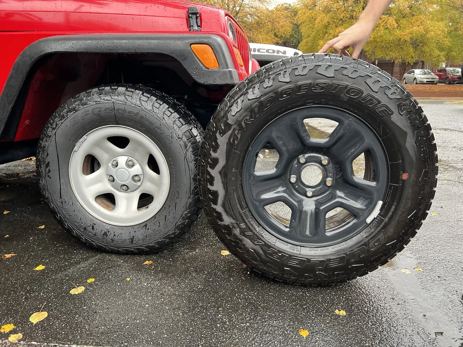

Got the Toyota lights + H4 80/100 installed, swapped my previous KC fogs instead of the knock off way too bright driving lights and spent a cold ass weekend installing new fender flares and 303ing them.

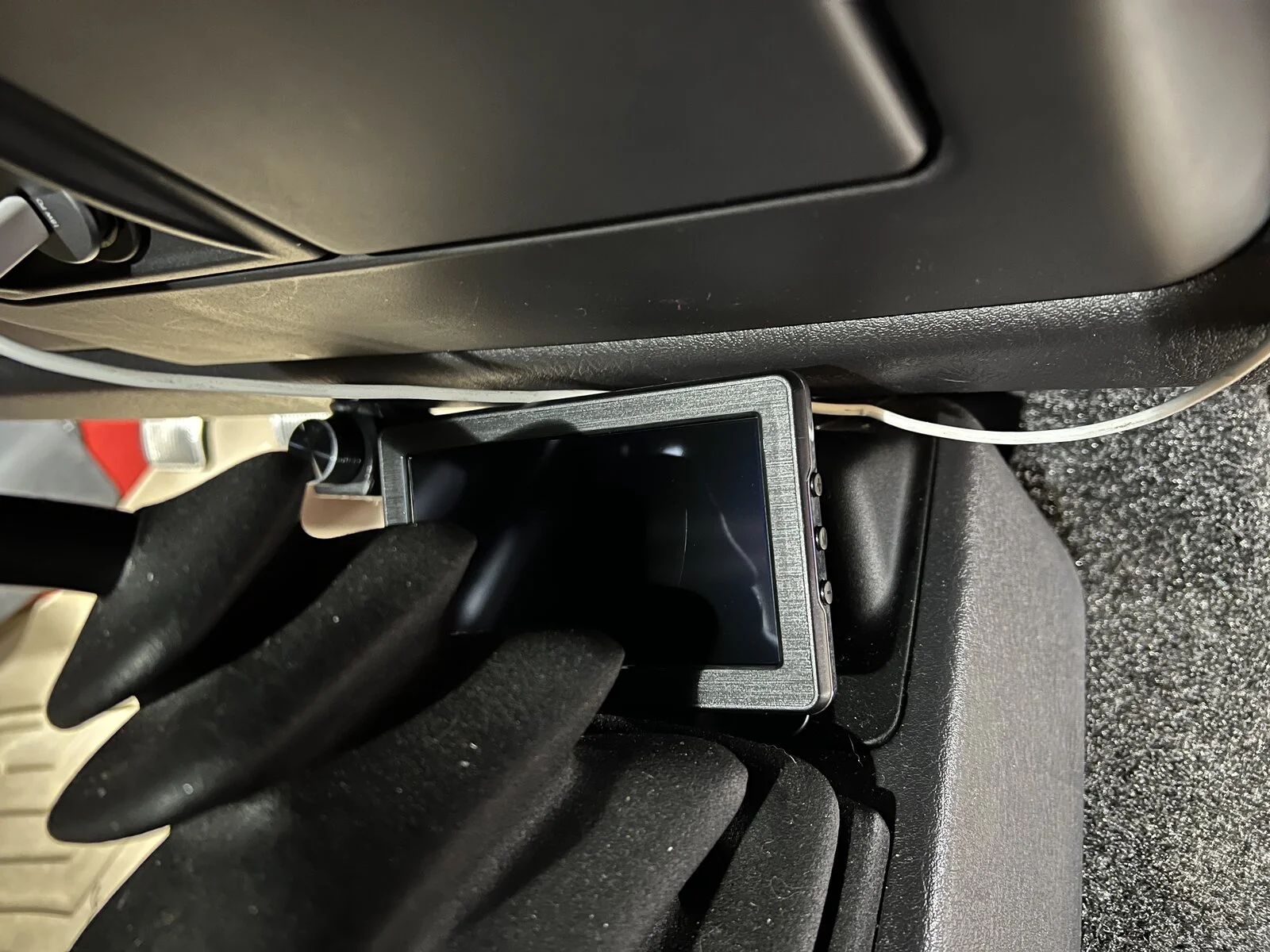

Got the backup camera installed. Not the best pic when in 1st but the monitor fits perfectly in front of the shift bezel and when in R it’s easy to see. Super easy to tap into the Reverse light power and GND from wire bundle just behind the driver side roll bar.

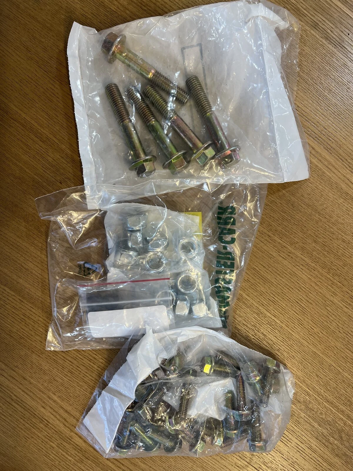

+ found that McMaster-Carr does next day shipping from their ATL warehouse for $8, so I got all my replacement bolts for my lift install.

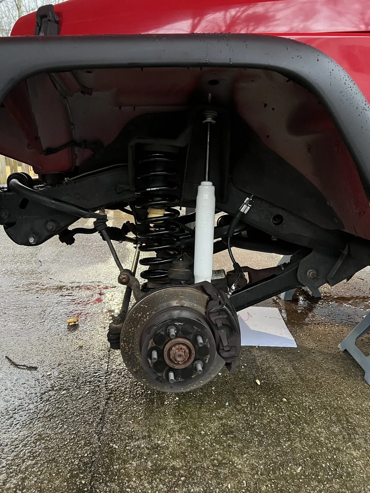

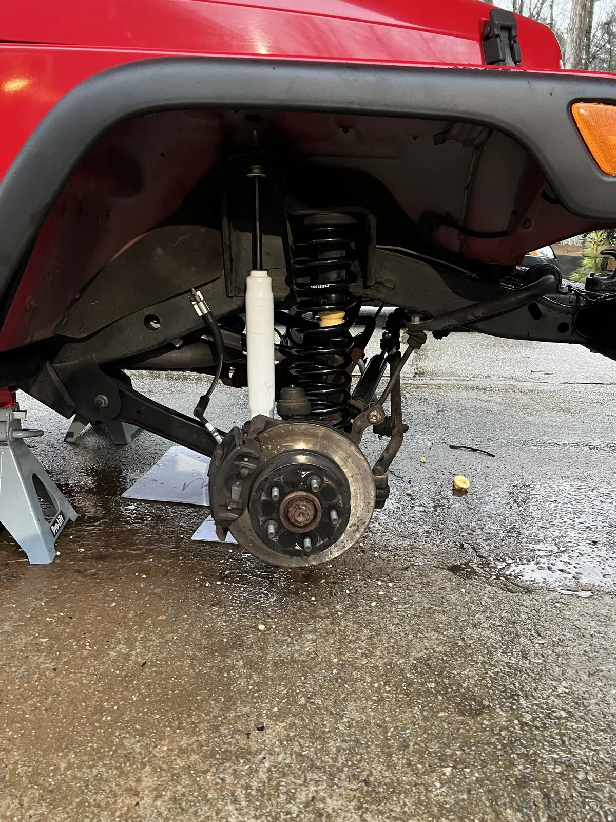

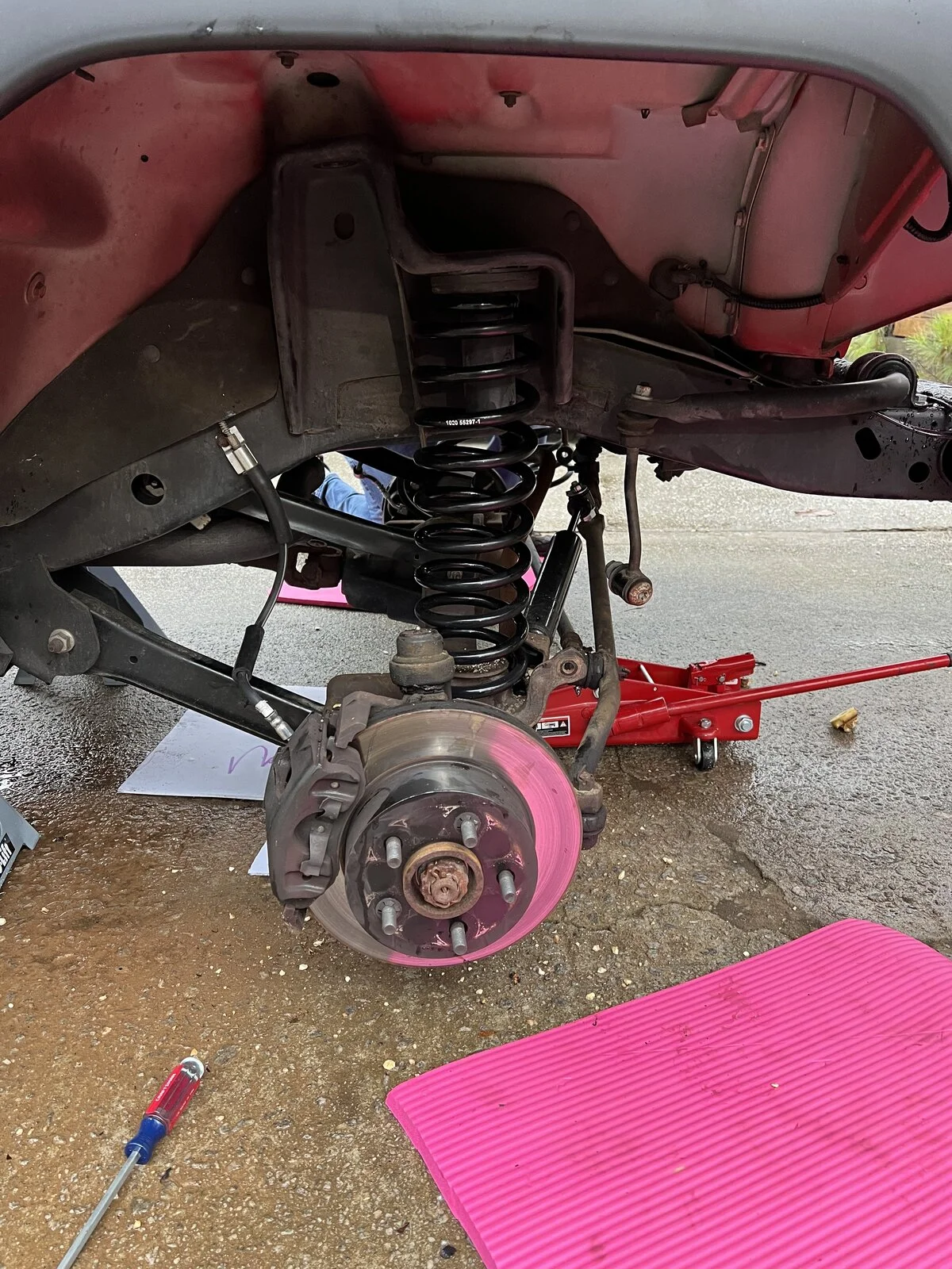

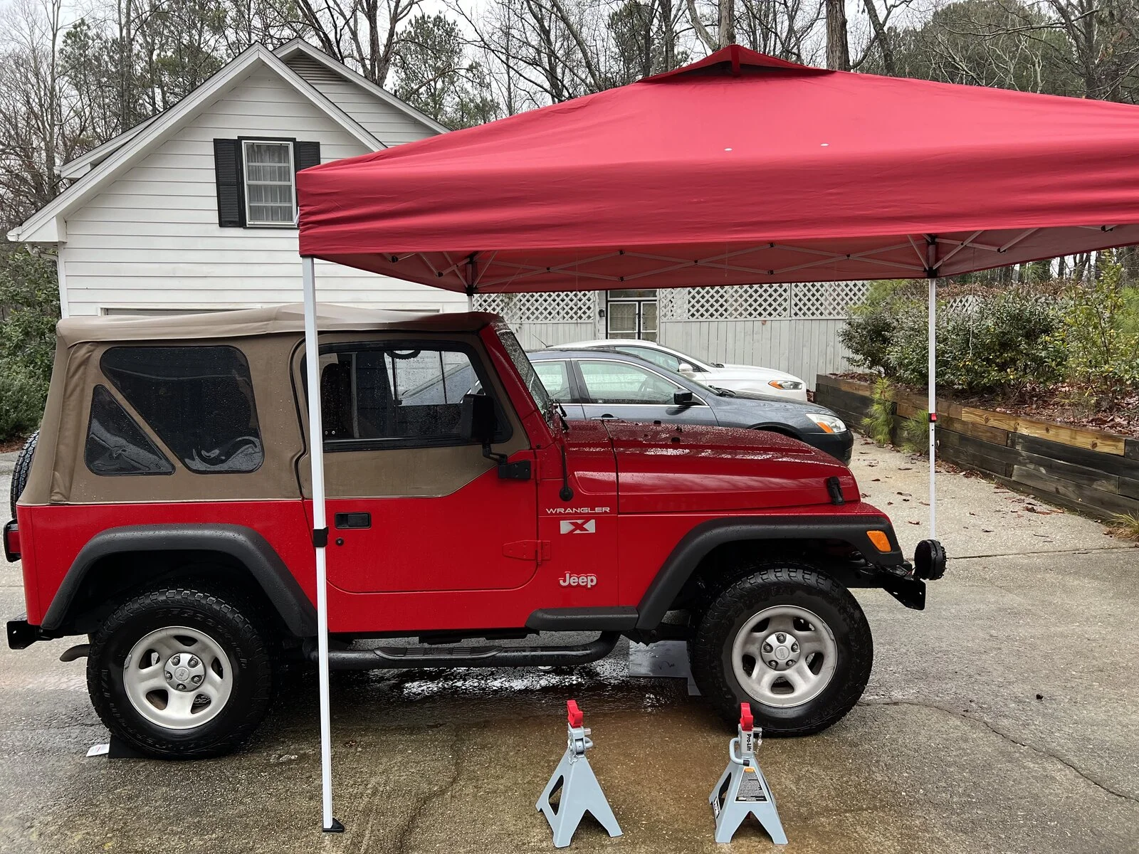

I started this build thread Oct 15 2021, and today I finally started on my lift install. This weekend was the third rescheduled flight for my friend to fly down from Chicago. The last two times were postponed for my surprise family Disney trip, him getting COVID, and then when we finally have this weekend, there is a major snow storm warning in Chicago. Somehow the snow missed the airports but of course it rained all day today and will tomorrow, but this lift was happening no matter what.
I can’t overstate how helpful it is to have another person to hold the wrench, step on the axels, let alone someone who has done this before. (Rust free Southern Jeep didn’t hurt)
It only took us about 2 hours todo the fronts and with no major issues.

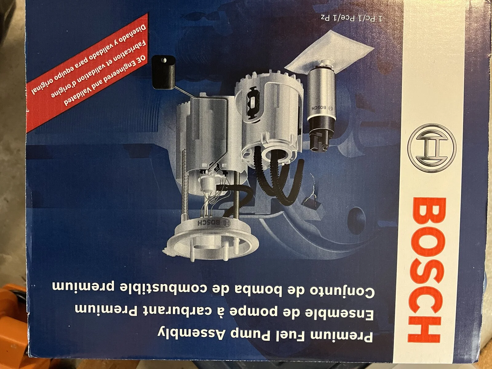

Between tomorrow and Saturday afternoon when he leaves, the plan is to complete 1) rear shocks and springs 2) BOSCH fuel pump 3) rear hitch 4) mount winch.

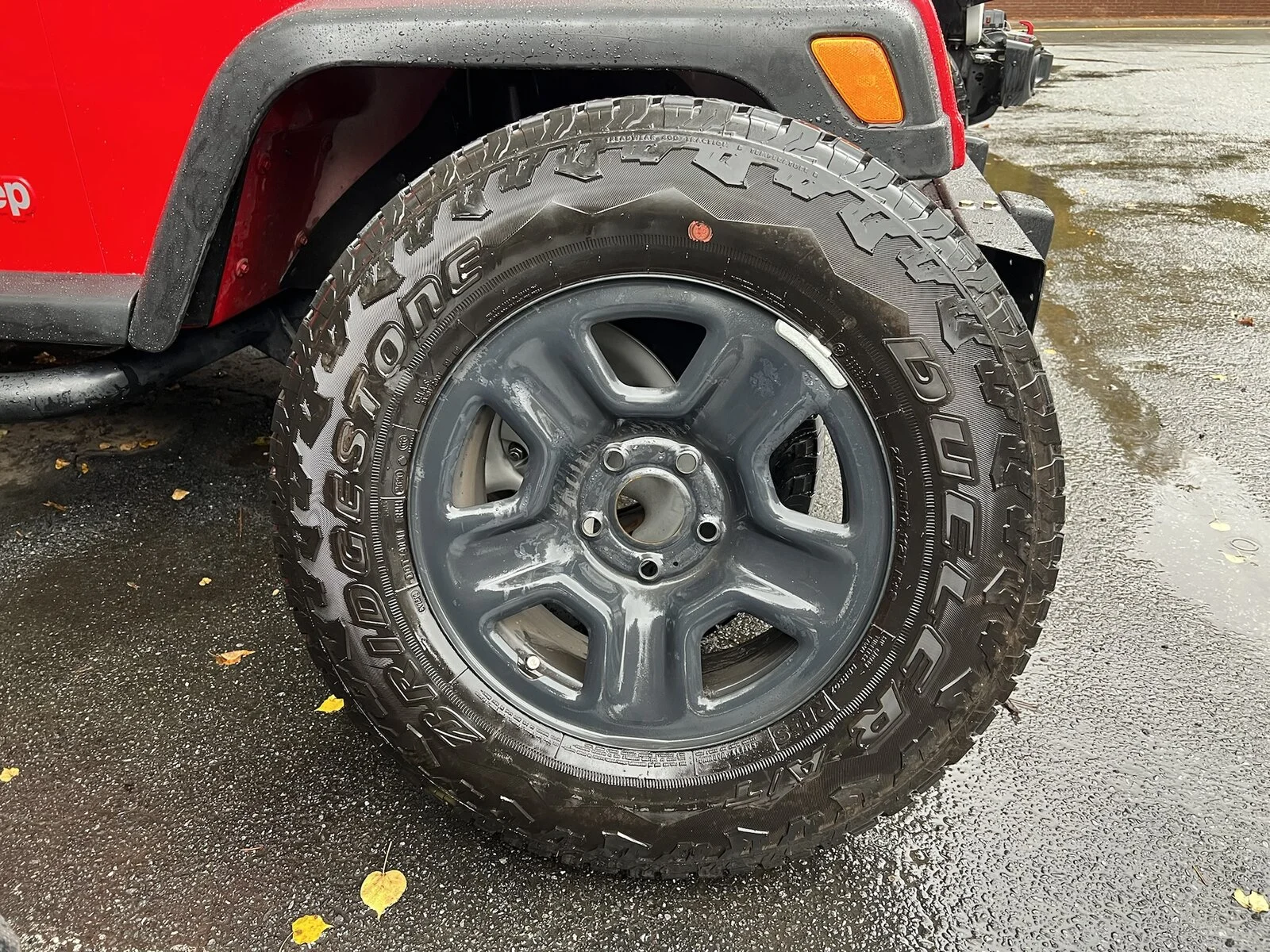

Monday I’ve got an appointment with the local Jeep shop to, align, mount and balance my new wheels and tires.
A few lessons learned
Doing a lift install in the rain sucks
A Neighbor with a tailgate tent is a good thing
Even with the tent, still got soaked.

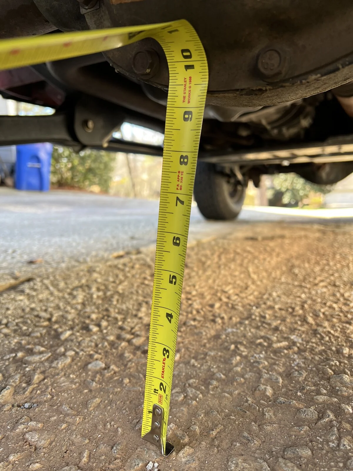

I’m hearing a hollow crunching sound from the rear driver side. I hear it 50% of the time at 25mph when going over a speed hump but not when I jump on any of the bumper corners. I crawled under and the only thing I can see is that the rear drive side spring model number is upside down. I can’t get under far enough to measure the coils and the procomp instructions don’t make any mention of top or bottom.
https://www.quadratec.com/sites/default/files/installation_instructions/13252.pdf
