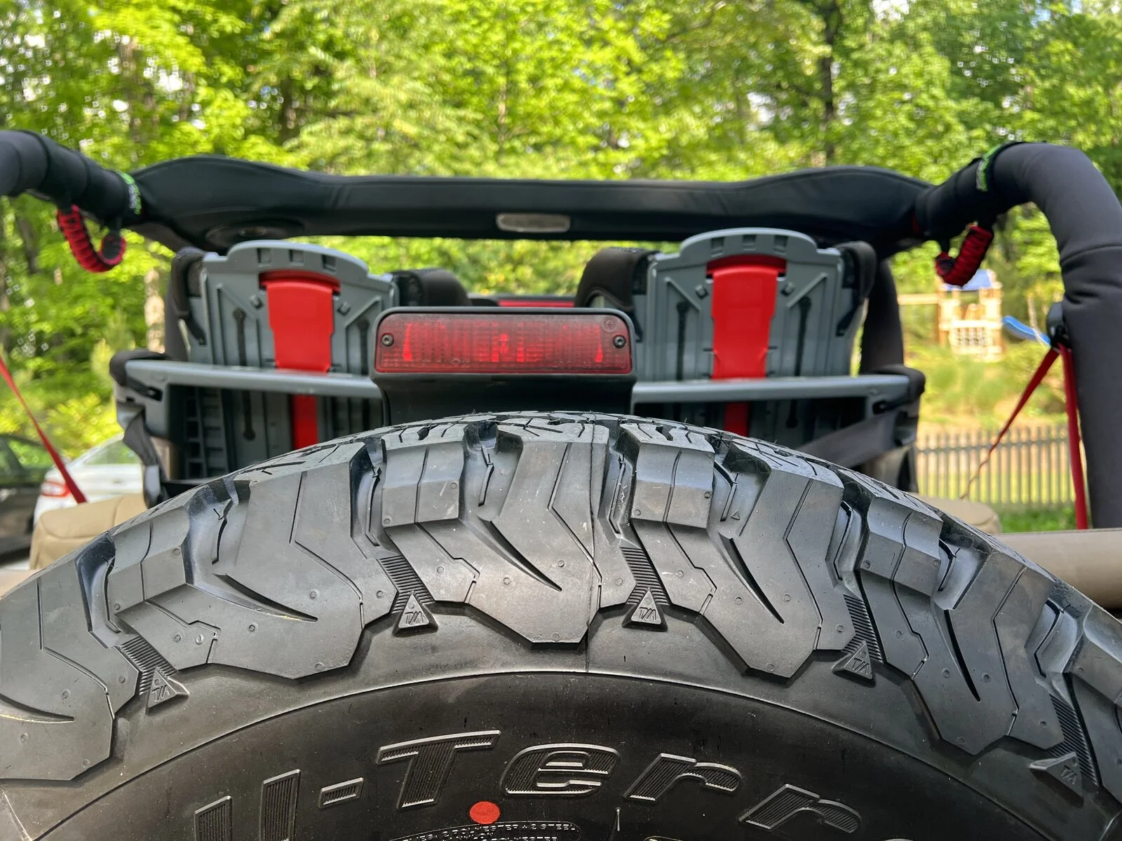

Raised the third taillight, worth the $25 for the warrior kit.

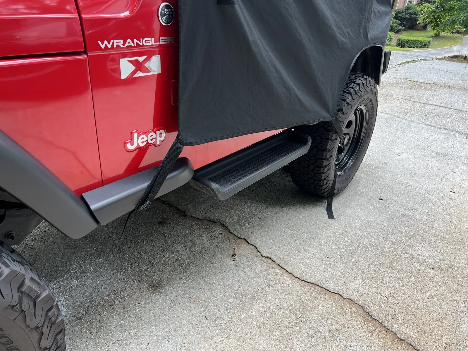

It’s the raingear half cover. Covers everything with the top down and half door windows out. It’s been worth the money.
Reactions: TRE3TOP
Raingear! That’s it I was trying to remember the brand name. They seem to be one of the few that will work with a light bar.

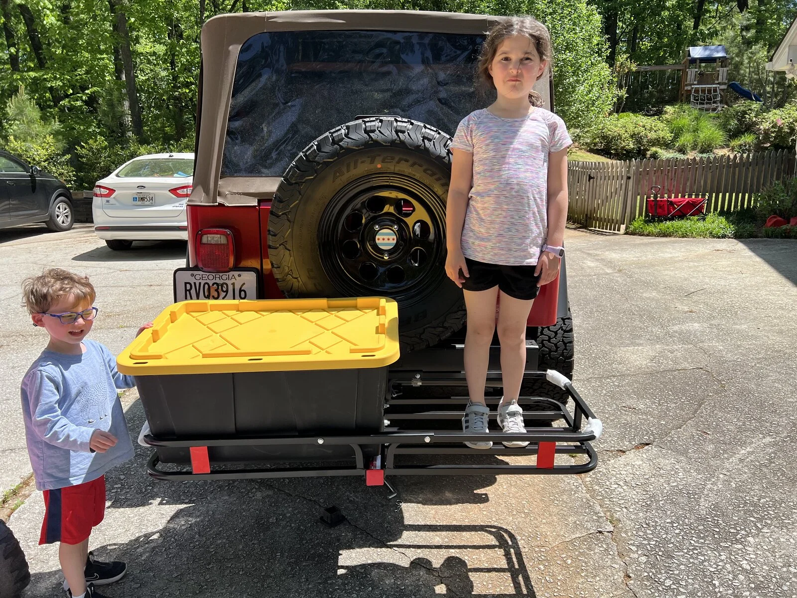

  • HF cargo carrier has paid for its self. Gives me just enough extra space for weekend camping since my kids still ride in back.
