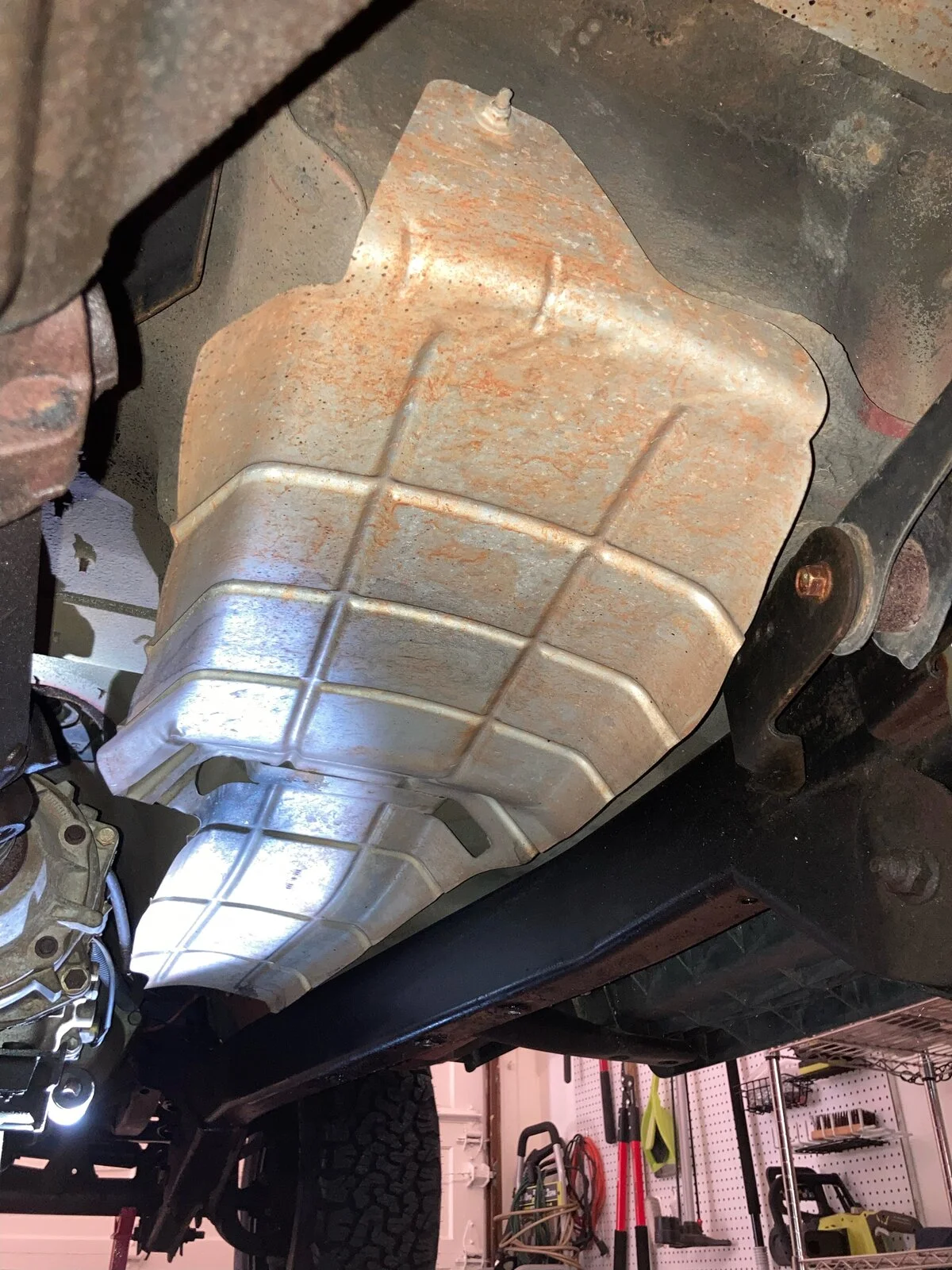

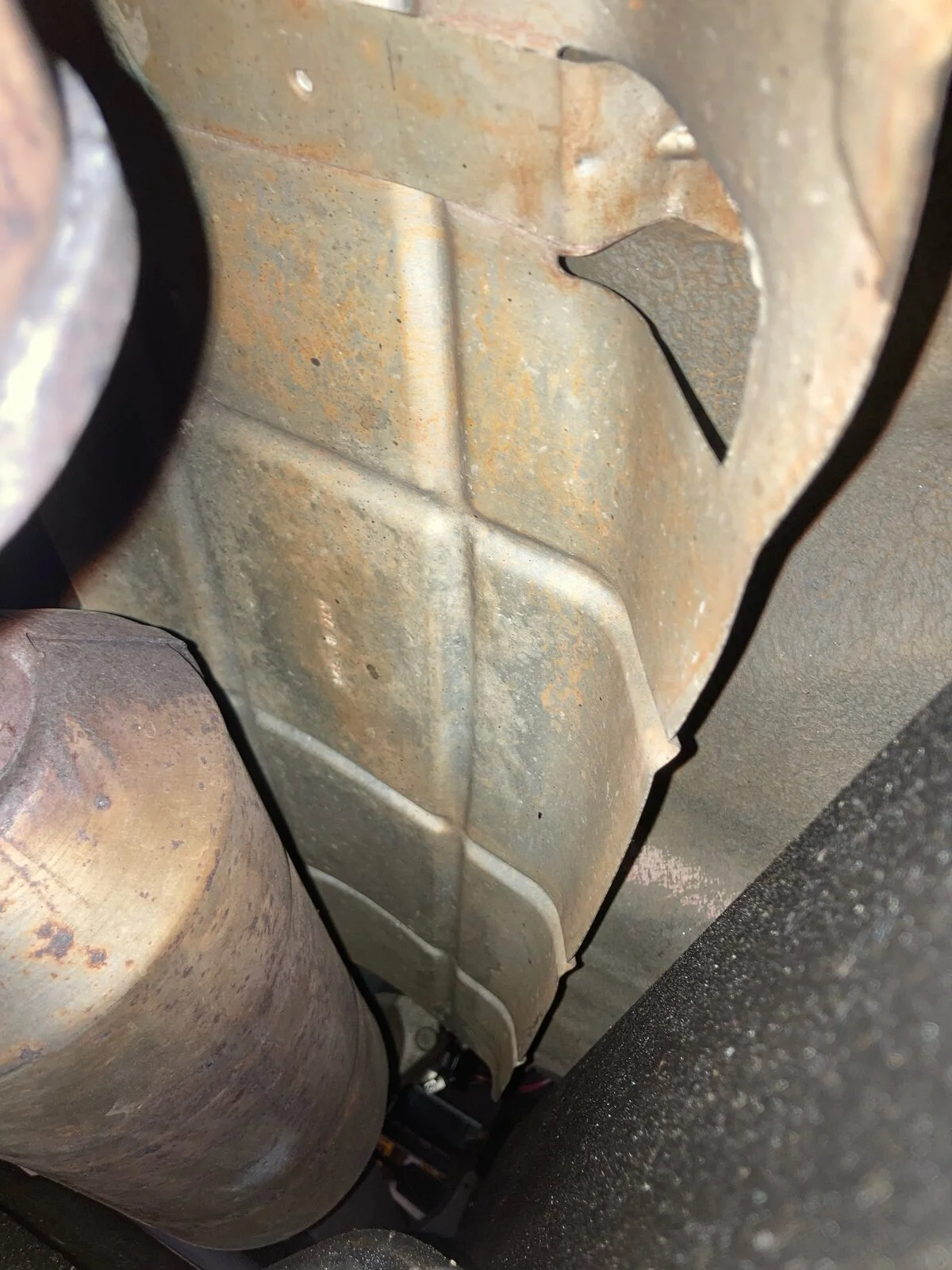

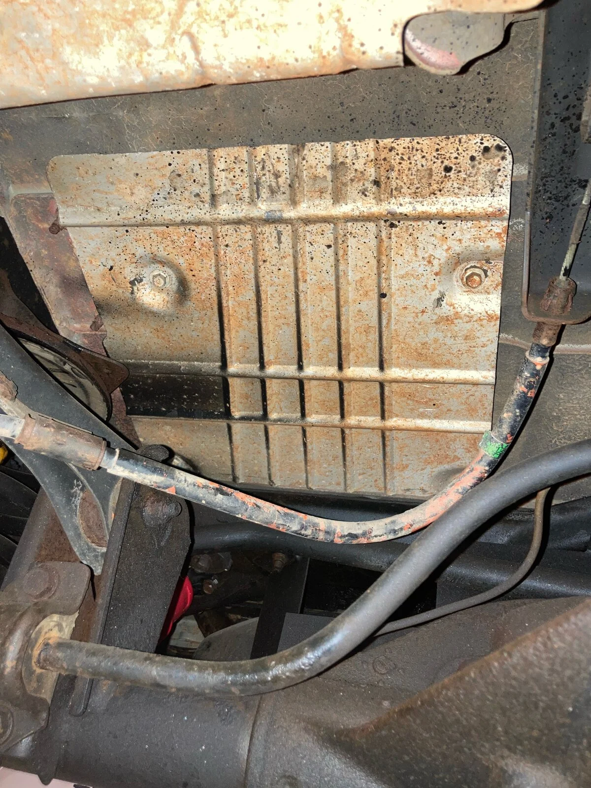

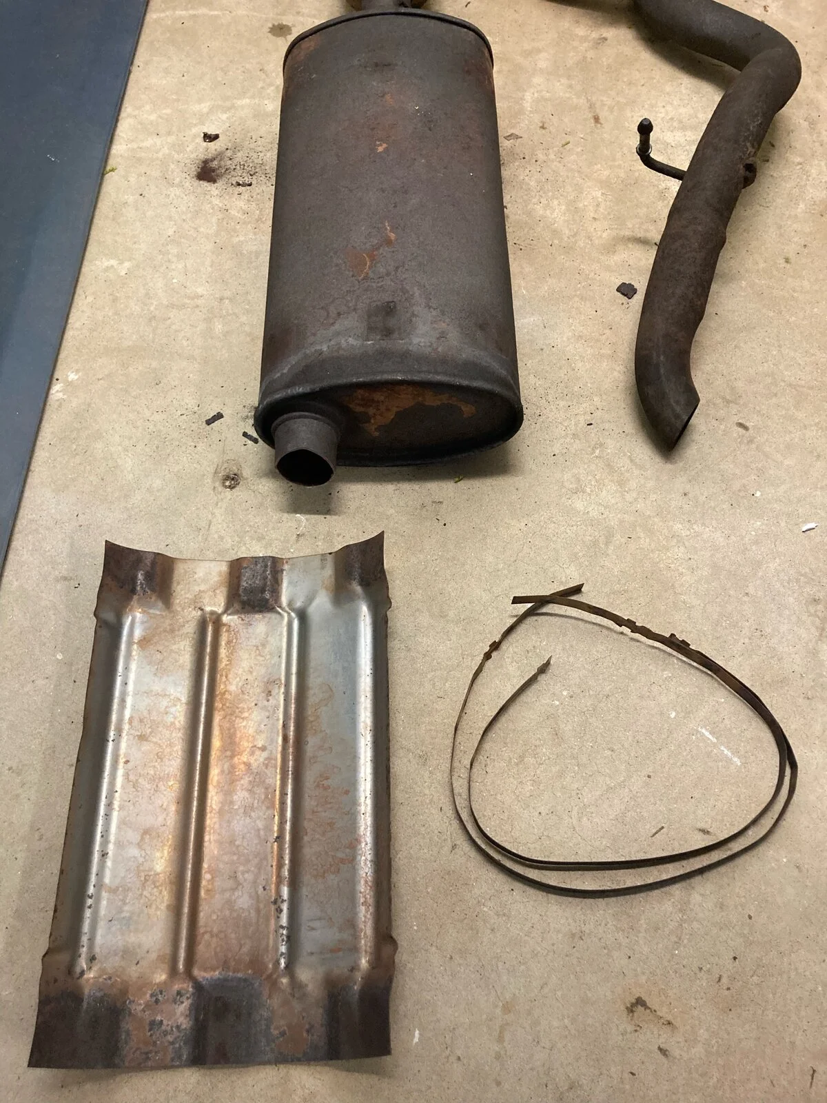

Edit: Learned today that my 97 SE has an impressive set of heat shields on it. The first runs the whole length of the catalytic converter and muffler. The second is in the rear passenger corner, where the tail pipe bends over the rear axle. The third is on the muffler itself. Pics of each are below.
Above CC and Muffler
Above Tail Pipe
On Muffler

The heat shield I'm referring to is only between the main catalytic converter and floor.
Hi @Jerry Bransford
Interesting. Maybe it's a 97 thing, or a 2.5 thing, but mine definitely runs the full length of the catalytic converter and the muffler.
Pic attached. Is this what you had in mind? (Sorry not better pic.)
