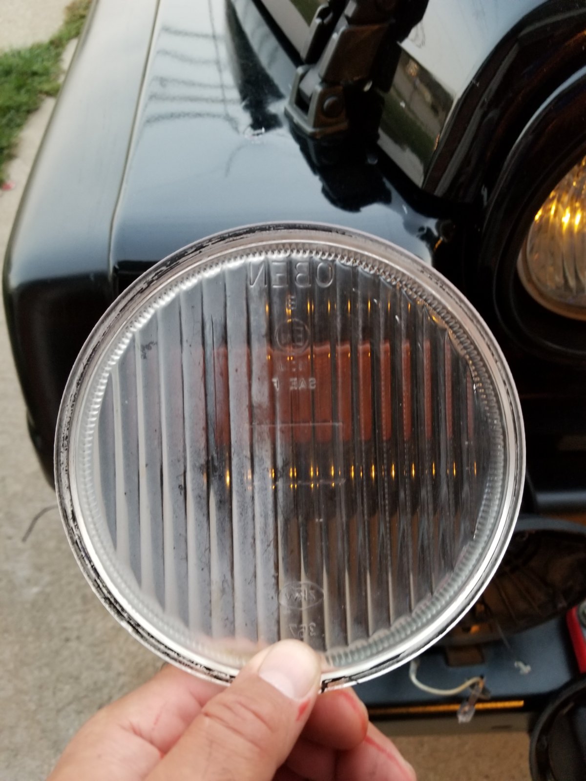

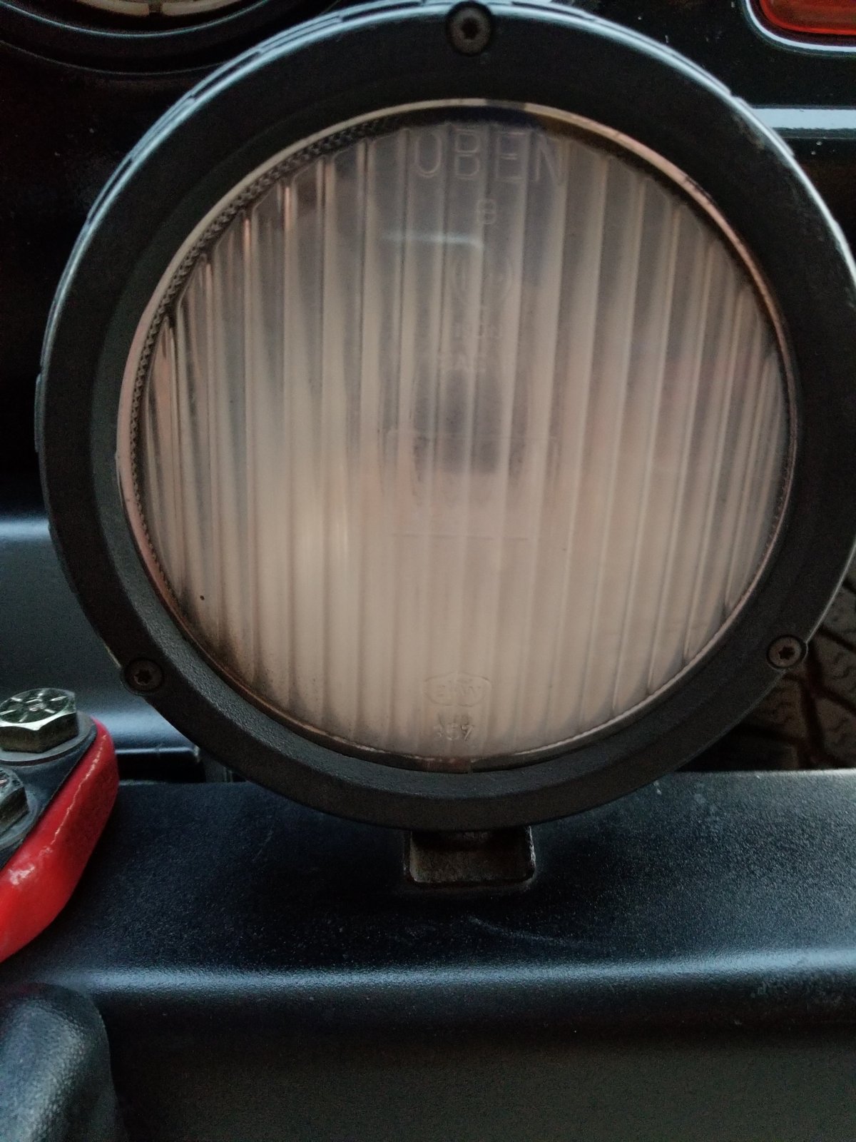

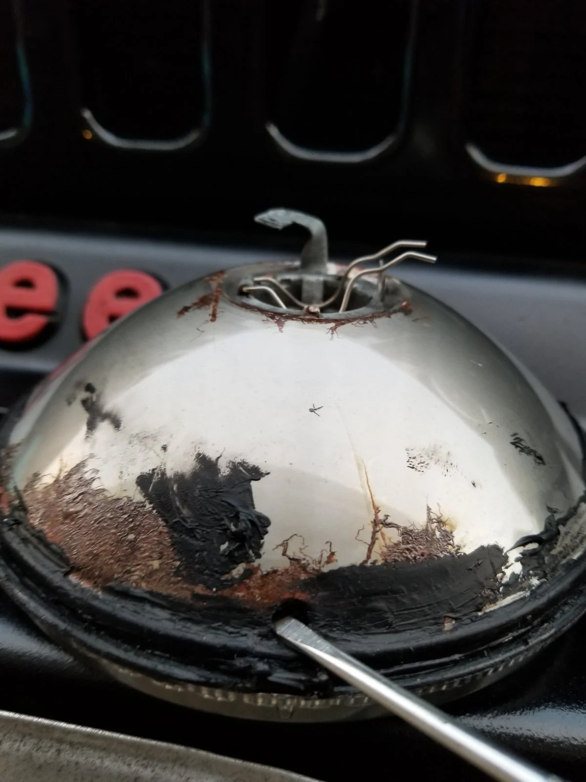

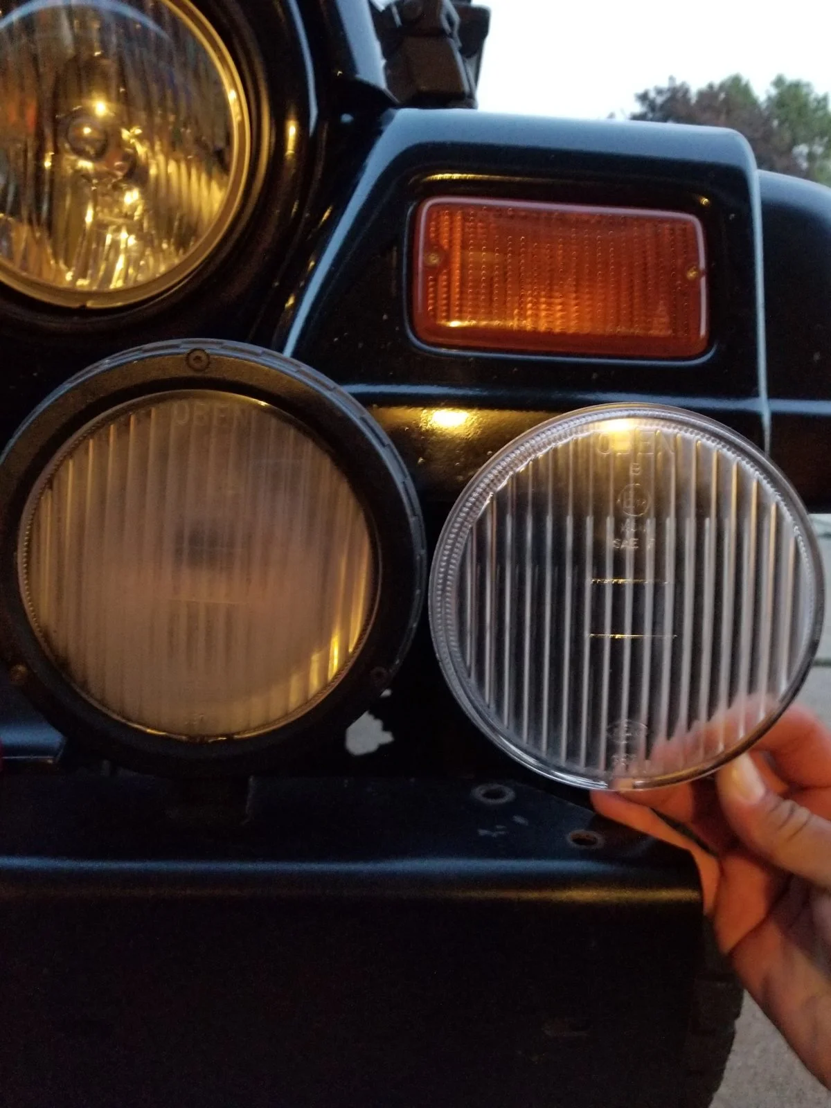

    I finally decided take care of the oxidation on the stock fog lights and the issue was from the inside of the glass. I took the light apart and clean the inside of the glass and what a huge difference it made. If your fogies need some attention follow the steps below.
    Before:
    Steps:

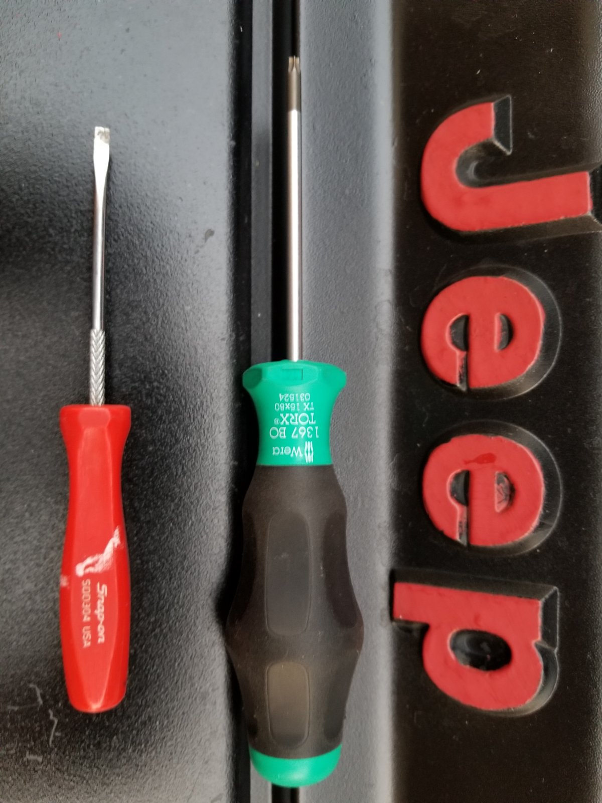

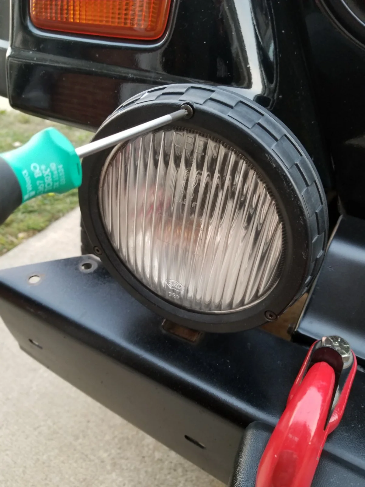

    1. Need torx 15 and small flat screwdriver
    2. Take the 3 screws out that
    3. Remove the bulb and disconnect the negative terminal and pop the light off the front base.

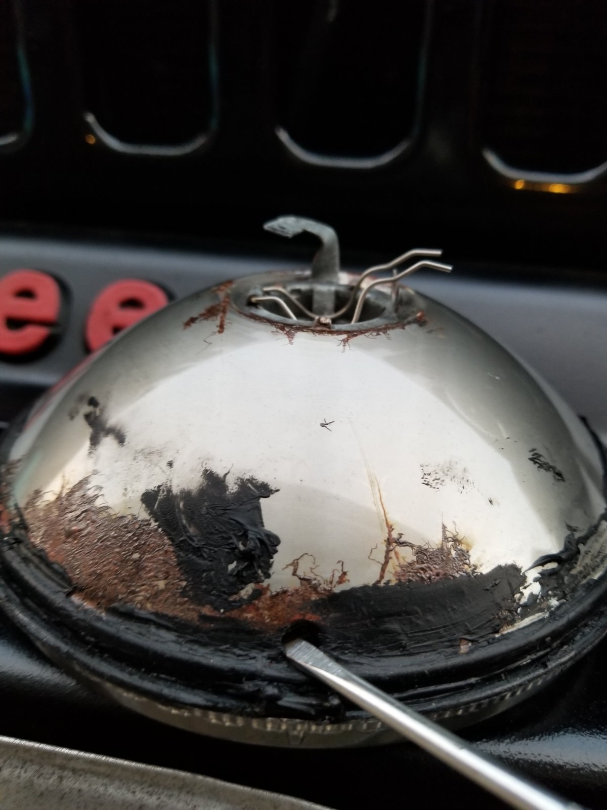

    4. Use the screwdriver to remove the sealant around the base and glass.
    5. Insert the screwdriver in the opening of the base and gently pry it off. You might have to remove excess sealant holding the base and glass together.
    6. Clean glass and internal housing.
    7. Use sealant to seal the base and glass together.
    8. Reassemble the lights back together.

    Wow, those look so much better! Good job, because a new set of fog lights is something like $120 per light! I actually didn't even realize they came apart so that you could clean the lens, so this is news to me as well!

    I was hesitant of taking the glass apart but it turned out that it's very simple to do.

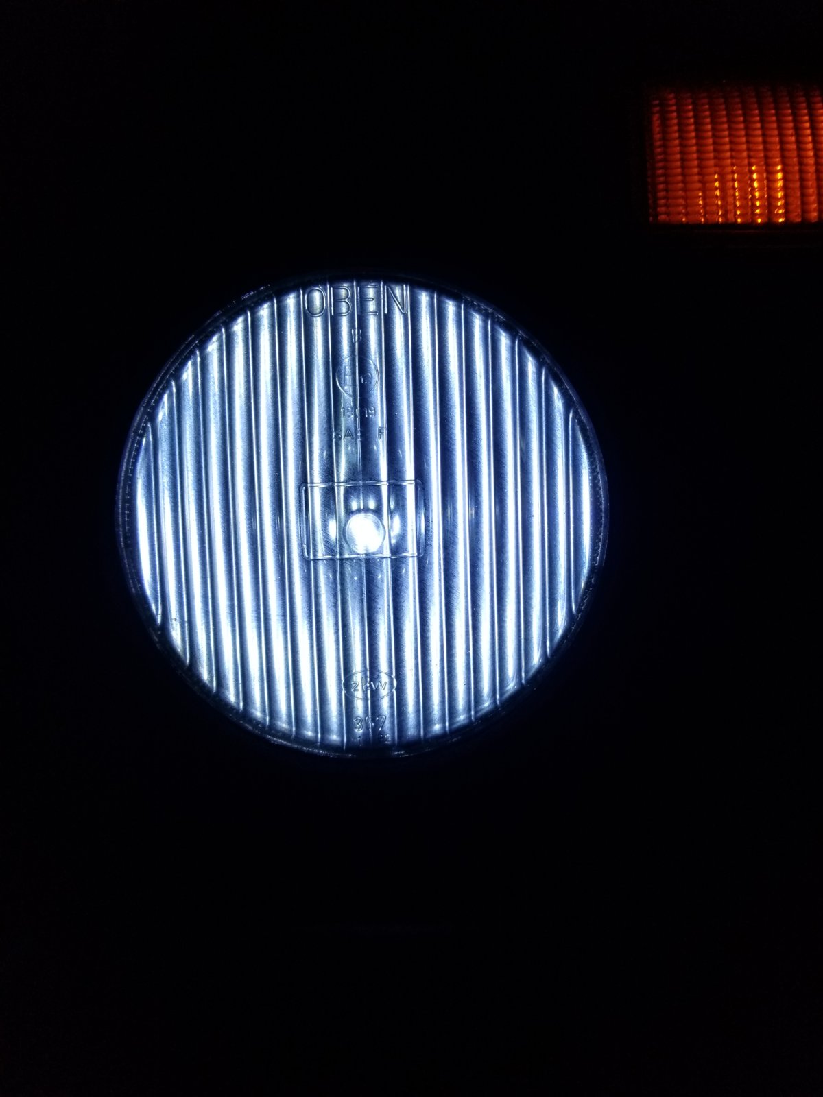

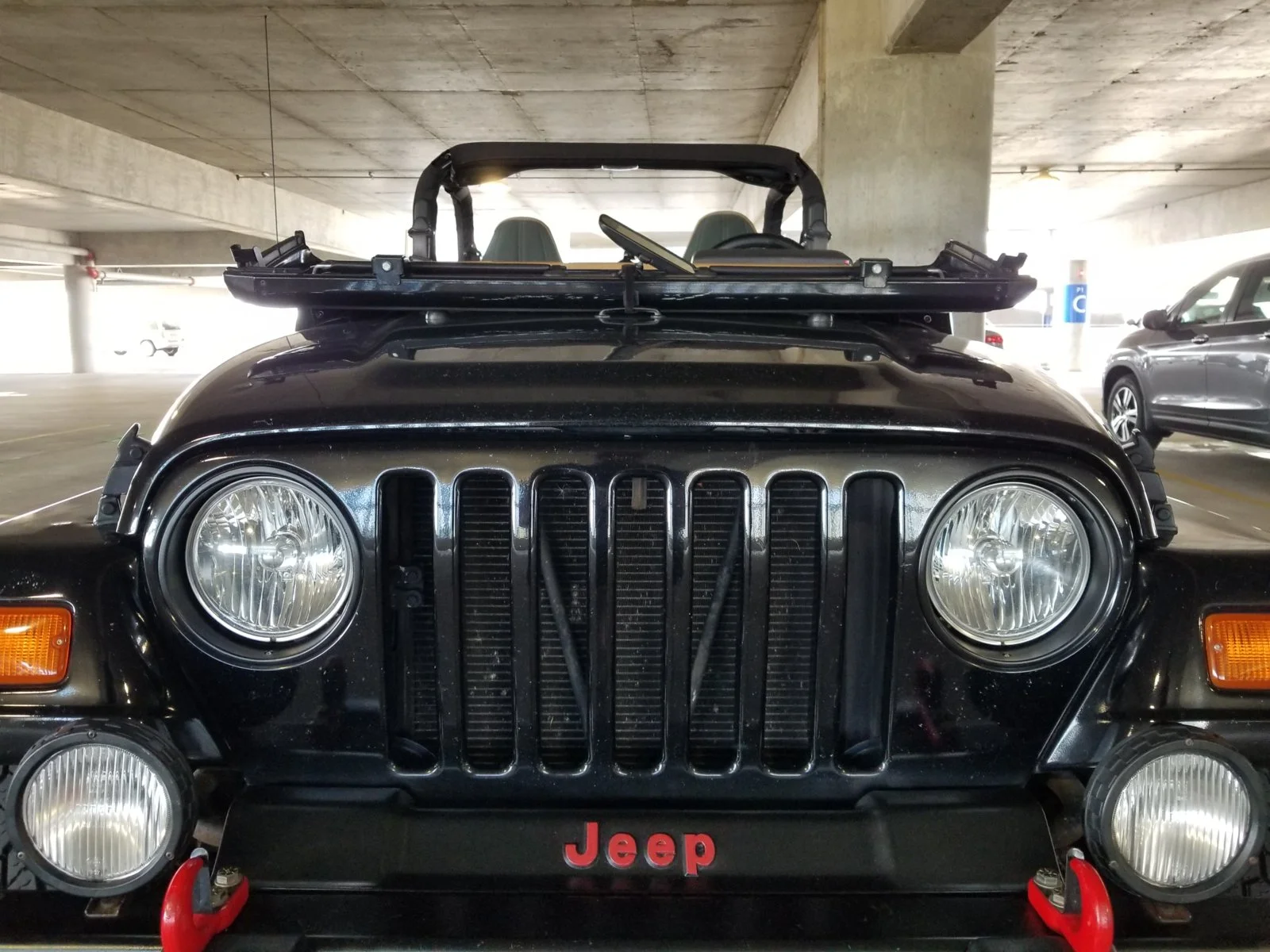

    Yes, I did, wiggled it and broke it off. You don't get that one spot up top that is blacked out anymore. Personally, I like look without the reflector. Hope this pic helps.

    Are those LED bulbs or halogen?
  10. lxxtsy
    lxxtsy TJ Enthusiast
    Thread Starter
    Joined:
    Sep 6, 2016
    Messages:
    793
    Likes Received:
    800
    Location:
    Chicago, IL
    LED, 27 watts. It's not bright cause of the low wattage, but still looks cool. One of these days, I'll upgrade to full LED foggies.

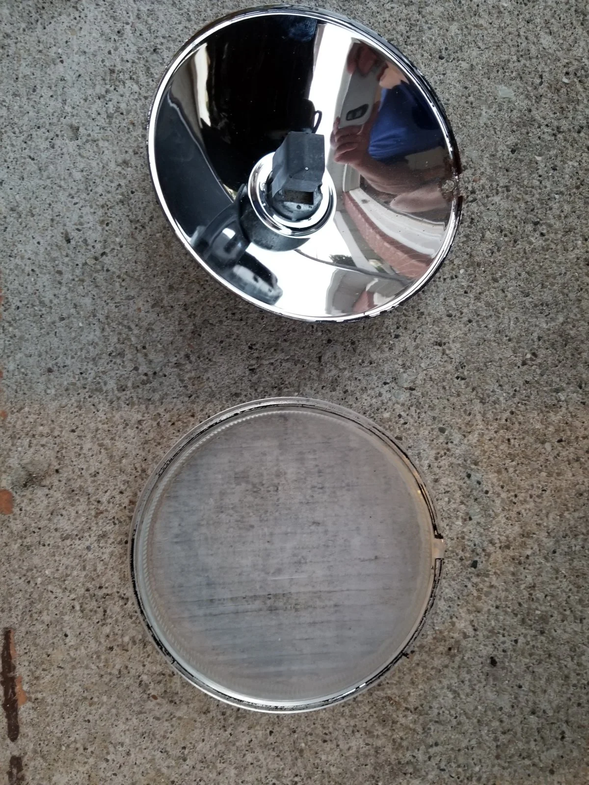

    Ixxtsy ..... thanks for the info here in your thread!
    Used a putty knife to separate the lens from the reflector. Cleaned the old sealant off the glass, and used fine steel wool to 'etch' the seal portion.
    A thin uniform bead of clear silicone Marine Sealer was used on the sealing edge of the glass. This was done by slowly rotating the glass while applying the sealer from a stationary position. Somewhat like a needle on a vinyl LP .....
    A final smoothing -out
    after the reflector was carefully set in place ......
    Also removed the tin reflector inside ....
    Curing time for the Marine Sealer is 12hrs.
    These are a quality light ..... mine are marked Made in Germany.
    Thanks again .....

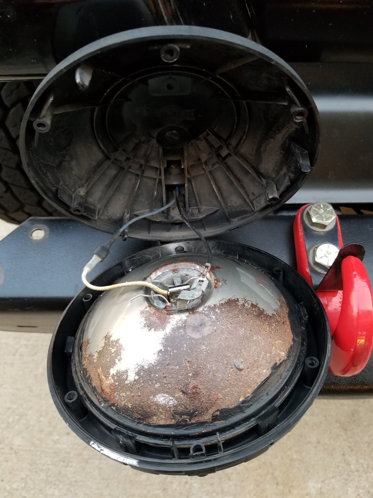

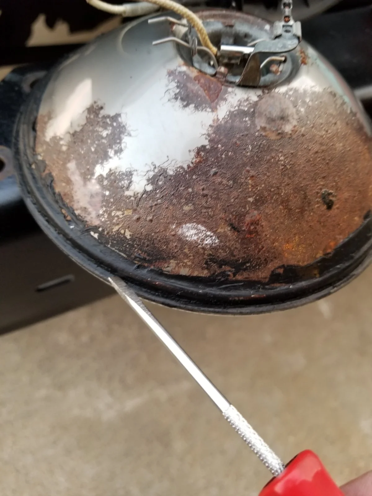

    I too did this "fix" based on your thread. So thank you. Mine was oxidized badly, but looks new now. I removed the entire fog lamp assembly from the Jeep to do this (so I could do it inside in better conditions). I used glass RTV (clear). Came out well. Once I put the fog back on my Jeep, I realized the other one, which does not have a foggy lens. Has a partially rusted reflector, like yours. So it looks different from my newly refurbished one. So I need to figure out what to do about that one. The reflector on the one I fixed was perfect so I left it in. Don't really want to take them both apart to remove both reflectors, so I will likely try to paint over the reflector on the one I still need to work on.

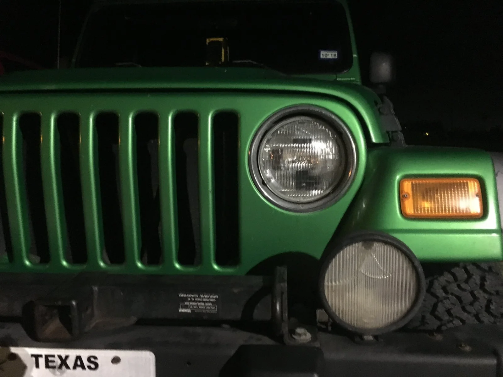

    2E07EF15-7594-4300-8B74-AEE16A9C3B15.jpeg Both of mine look like this. Anybody know where I can get replacement lenses?
