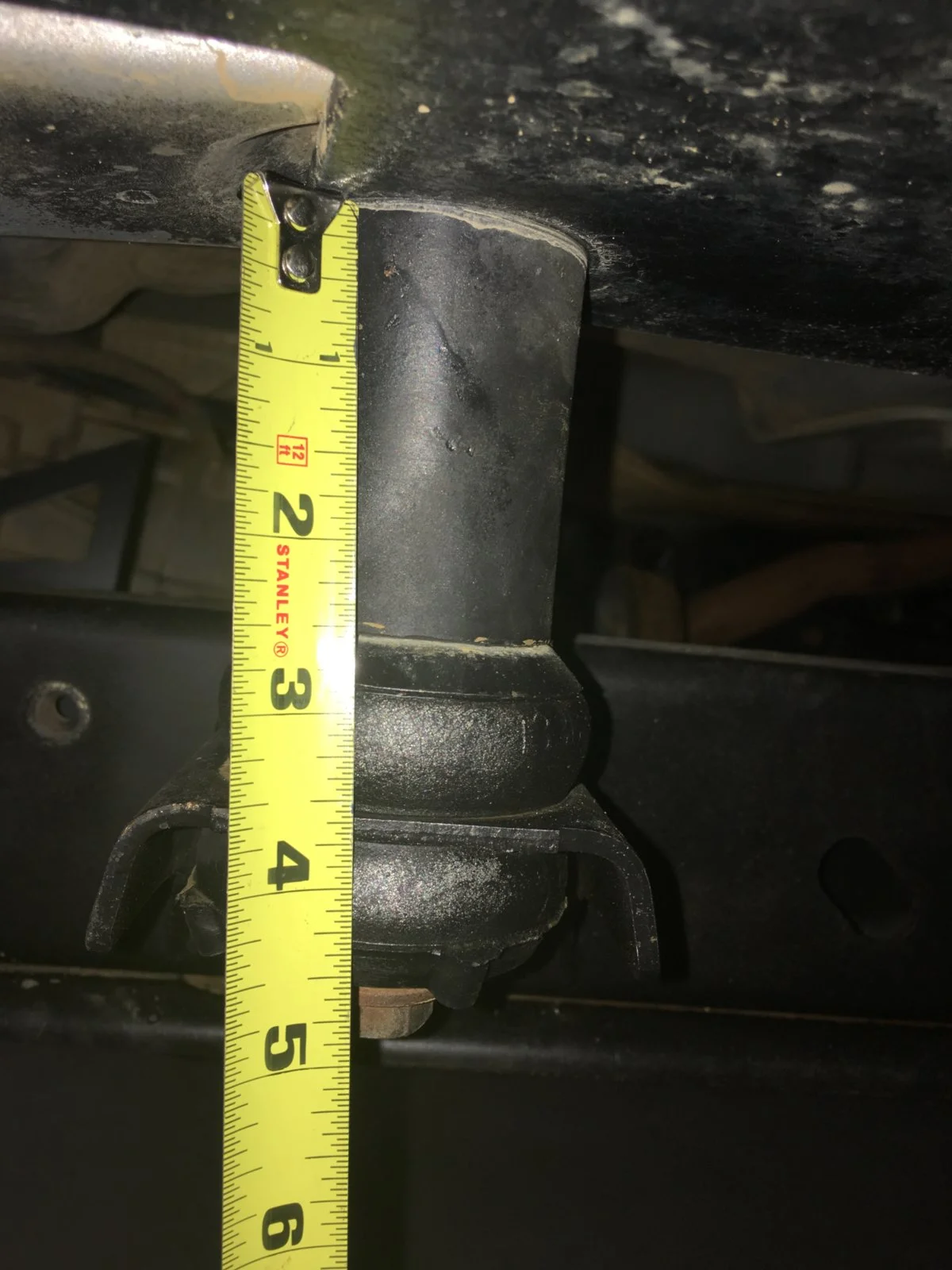

Do you actually have a 2" puck sitting atop your original approx. 1" body mount? Or do you just have a 2" gap between your frame and body?
How about a pic?
Correction. I’m assuming it’s a 2.5” puck not 2”.
Yeah I’d love to either get rid of it all together or cut it down.
Any recommendations on what height and still keep the 35’s with the 2.5” suspension lift?
"They" say that 1-1/4" body lift with 2-1/2" suspension lift is enough for 33's. I thought it was plenty of room for them. It might be enough (with the right bumpstops) for 35's.
