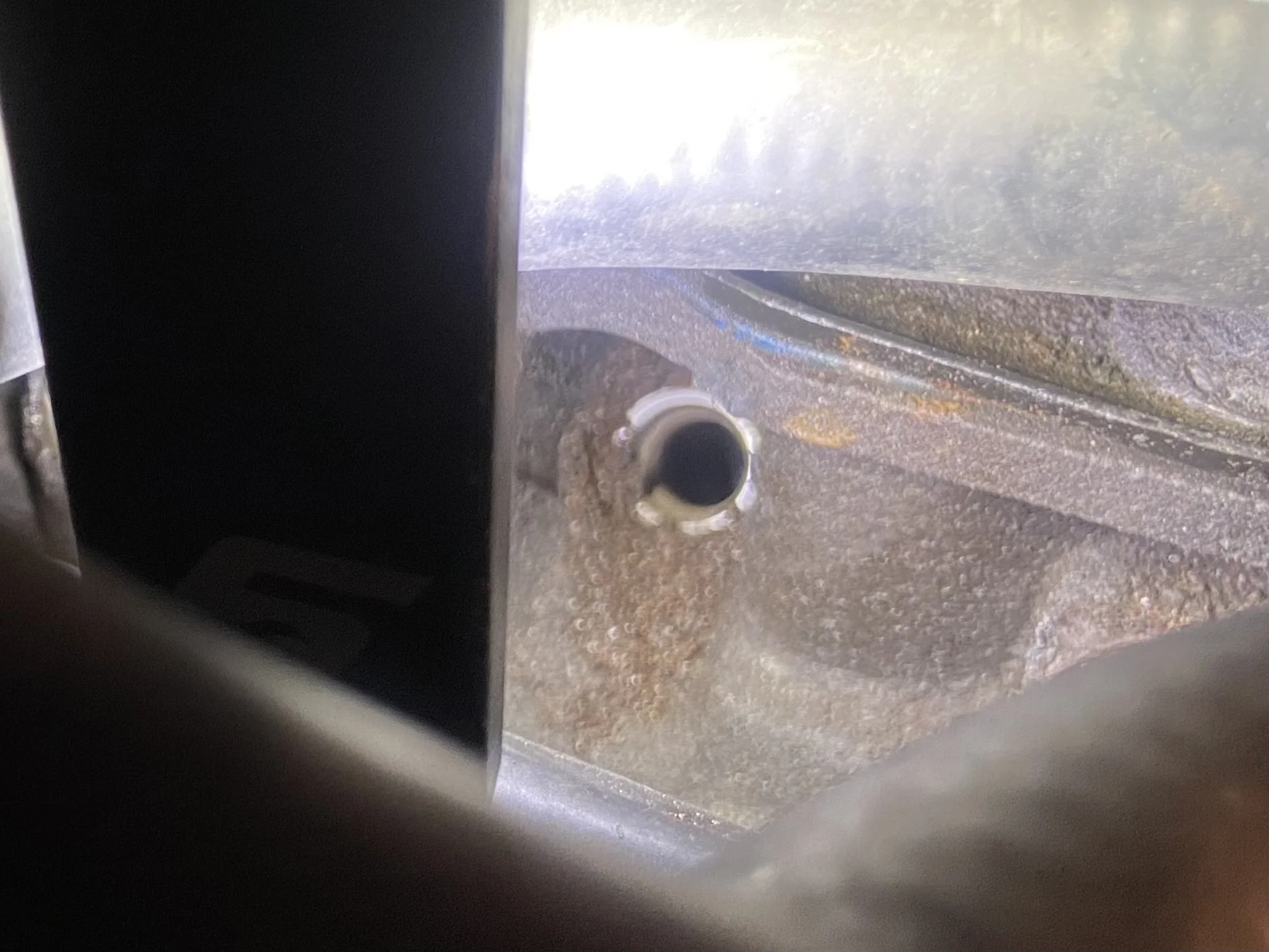

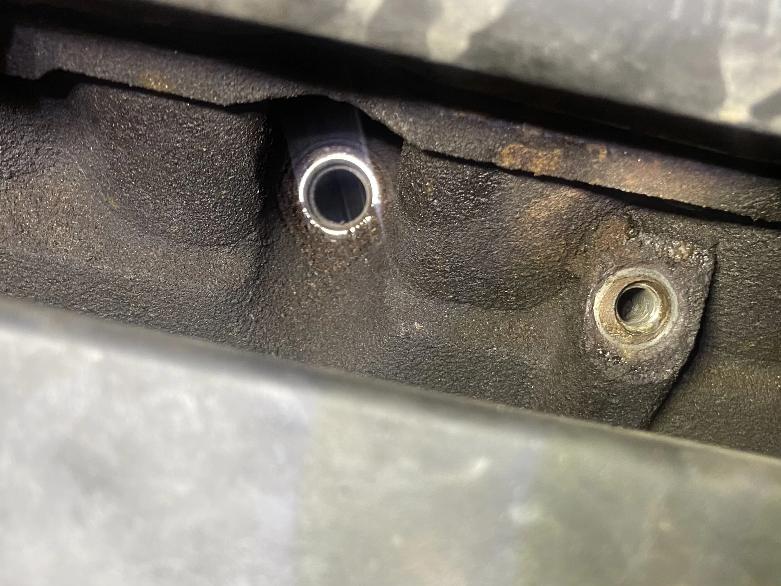

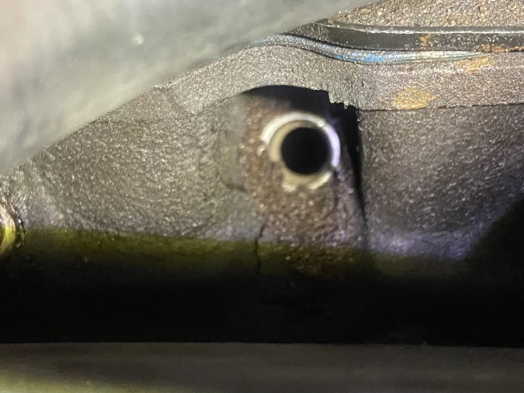

Anyone have any recommendations on how to clear the gunk from the plug holes? Before removing the old plugs I blew out the area with compressed air but clearly, if you look at the crappy photos I took, (very tight area) you can see there's a lot of debris still there, and the last thing I want to do is get that down in my engine.
Thinking a shop vac will do it but maybe there's something better for the job, or a how-to a veteran could recommend?

Get a piece of hose/tubing that is much smaller diameter than the vacuum hose.
Push a few inches into the vacuum hose and then tape the joint to get a better seal.
The reduced diameter will increase the velocity of the air being sucked in, thus improving your chances of getting all of the debris to go into the hose instead of into the engine.

Next time spray a little carb cleaner first. Let it sit a few seconds. Spray with air. I've got a skinny hose i use on my air gun to get into tight places that really helps stuff like this

That's a great idea, actually. Didn't even think of fabbing something up but I've got the perfect piece of small diameter tubing and gaffers tape. Thank you! Will chime back with results.

That would have certainly cleared the area much better than just air. Thank you!

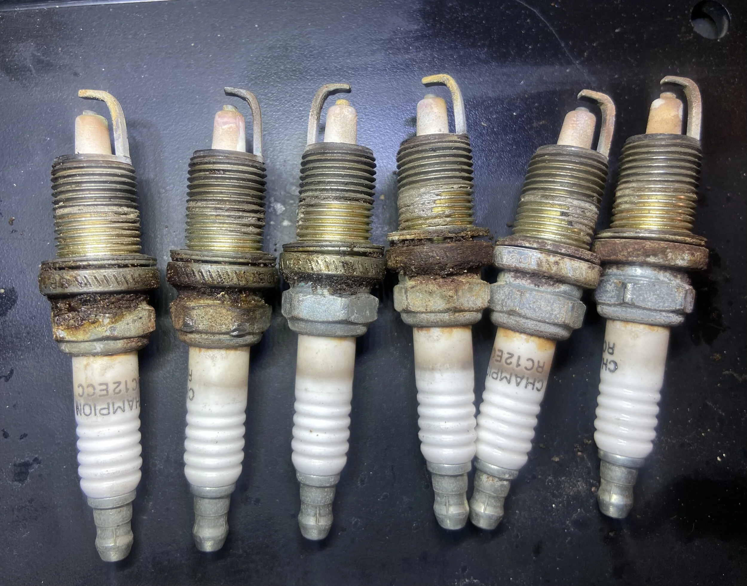

Ya man, I'm behind schedule on my air filter and plug replacement. I've only put approx 3k miles on the Jeep since 2021 because I only use it in the Spring and Summer. Rotations, oil change, transfer case fluid, diff's, etc are all up to speed, though.
As far as cleaning the holes, I tried blowing them out, but didn't think about using a solvent prior. And I offroaded heavy before 2020 and forgot how filthy the engine compartment was after. And thats where a lot of crude collected and I didn't get cleared since those trips. Live n learn.
