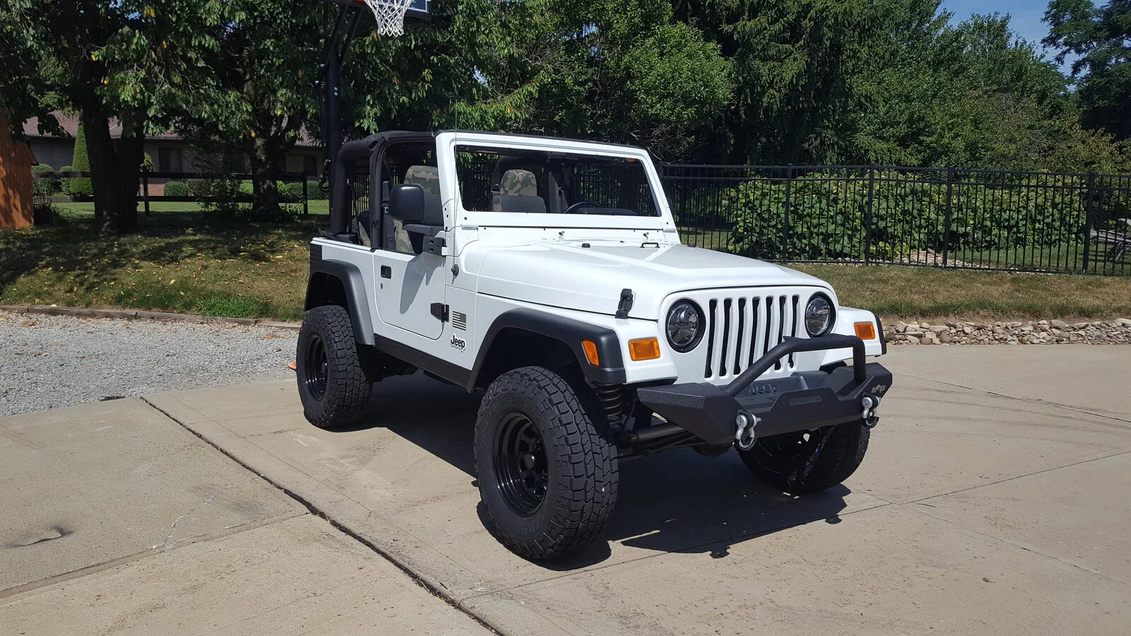

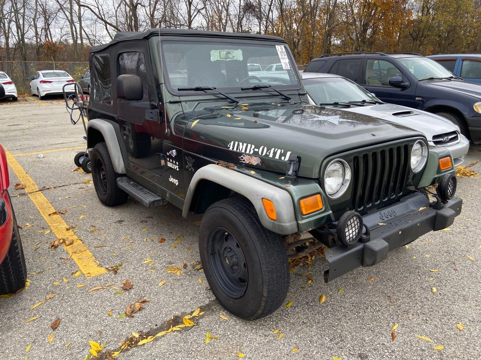

I bought a beat up 2004 Willys at auction last year and ended up having to do a full rebuild (frame / floor pans / rockers / quarters) so I repainted it Chrysler White PW7. Used to be Willys Moss Green - wasn't a fan of the Green and the existing paint was beat. I do like the white / black much much better.

I love white on most any vehicle! I wanted a white TJ but couldn’t find one in decent shape, looks great!

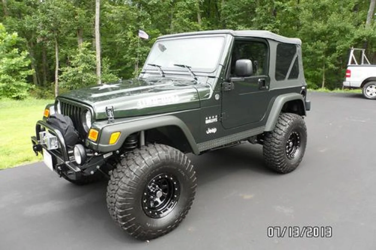

So now it's just a white X model. I've had a few white Jeeps.
p.s. Did you keep the Camo waterproof seats? The Willys edition green top and flares are impossible to find anyway.

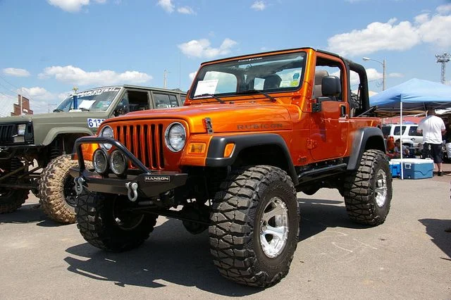

It depends on the painter and what you're having painted. Most of the time, you get what you pay for when it comes to paint and body work. The custom burnt orange TJ posted in post # 49 would prob cost $10k+ easily.

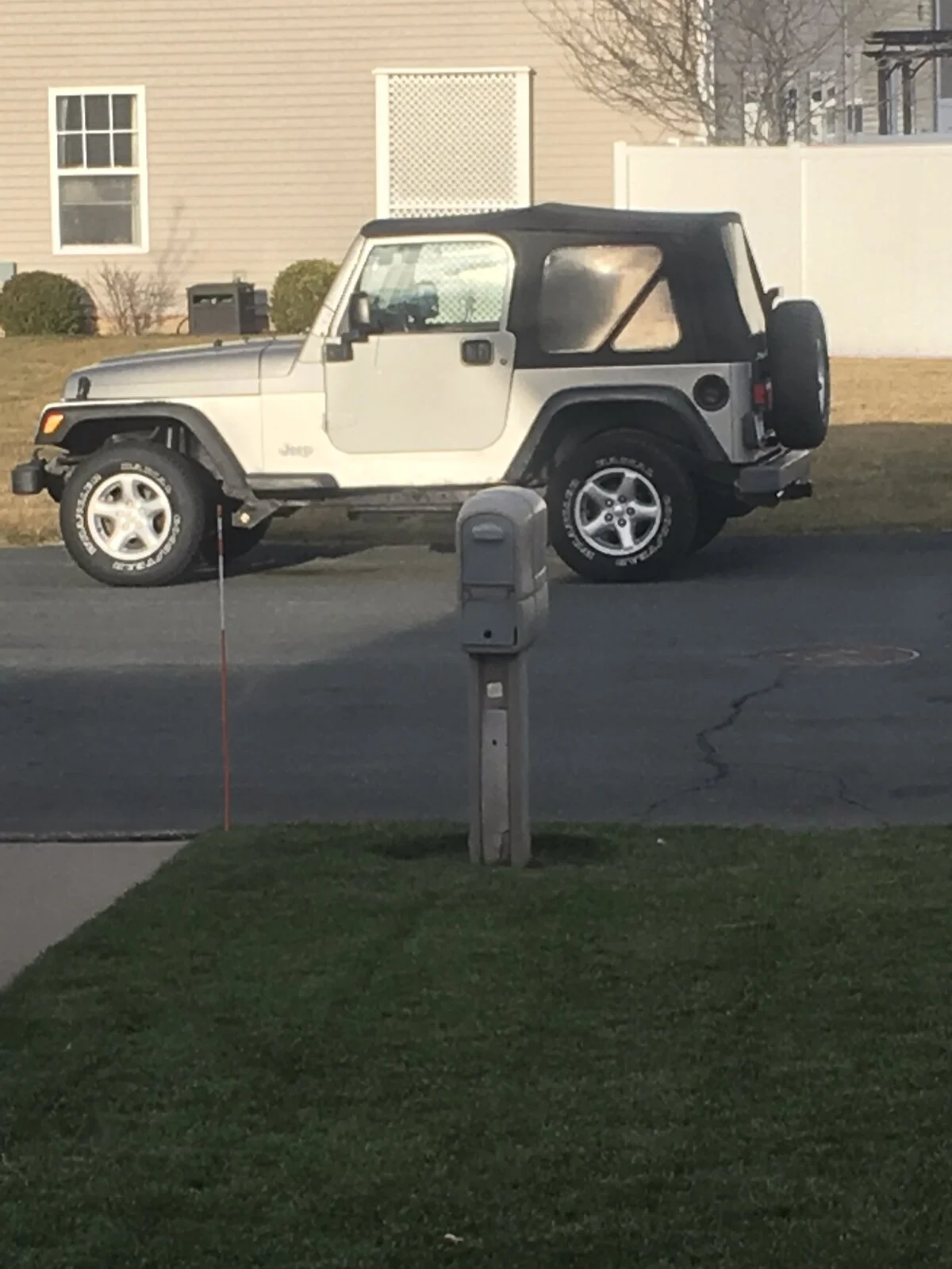

I painted mine a couple years ago. Silverstone metallic PS5 - same as factory but it was Nason brand and not Dupont (that cost a lot more).
I did some half doors and the sides of the Jeep. The match was pretty poor. The metallic can look really crappy depending on the angle of the sun.
The paint is holding up well otherwise. Only bad spots are where I sanded down rust and bondo overtop. It is coming back through. (Rockers). Must cut out rust completely and replace with good metal.
I plan to redo and try again soon. This time I will spray the whole Jeep and make certain the body work is done better.
I think a good wetsanding and polishing might help the matching issue. I’m going to play around with that a little bit when it warms up in the spring. Good practice before I do the respray.
Here’s a couple pics that shows my issue with the sunlight angles. It’s pretty disappointing. Good thing I only spent about $200. Lots of time spent though (and Jeep downtime) but I guess that is the cost of learning.
