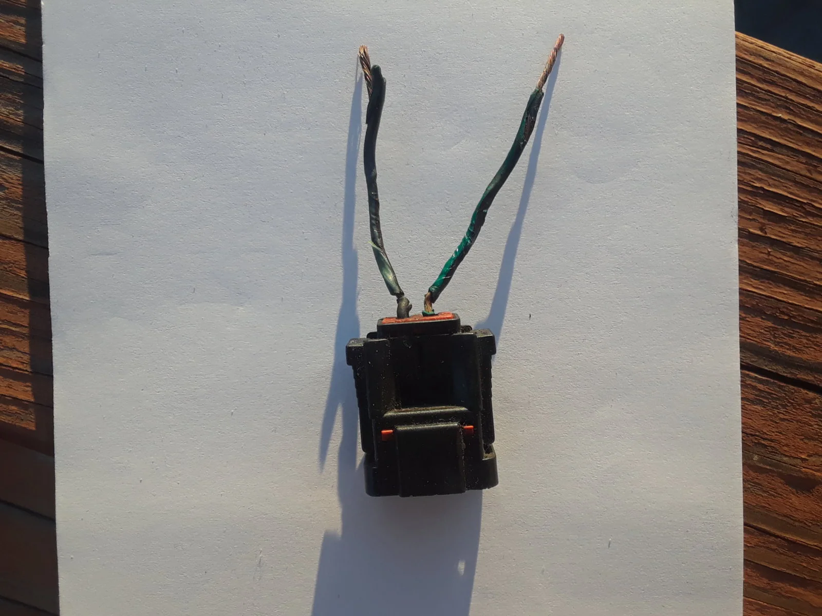

Nice jeep btw, i would carefully examine the wires @ the #1 fuel injector, make sure they are not touching, check condition of the insulation..if it looks like this, it could cause a misfire...
Reactions: Alex0413
