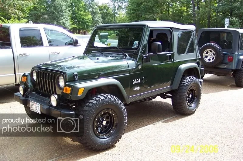

Of course even with the 4 banger I still plan on a lift kit & larger tires along with a re-gear but again it's not my daily driver. Here's a photo I found which is how I hope to see my jeep once it's finished. The perfect amount of lift, not too much empty, unnecessary fender space, just the right amount.
