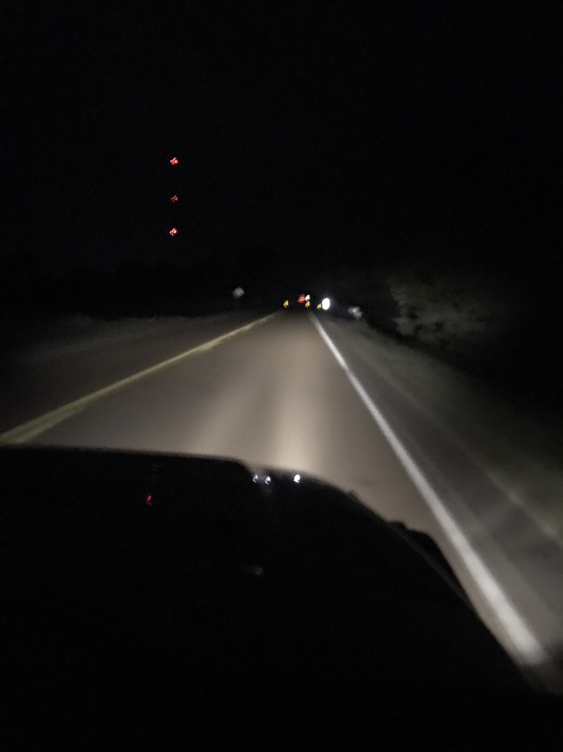

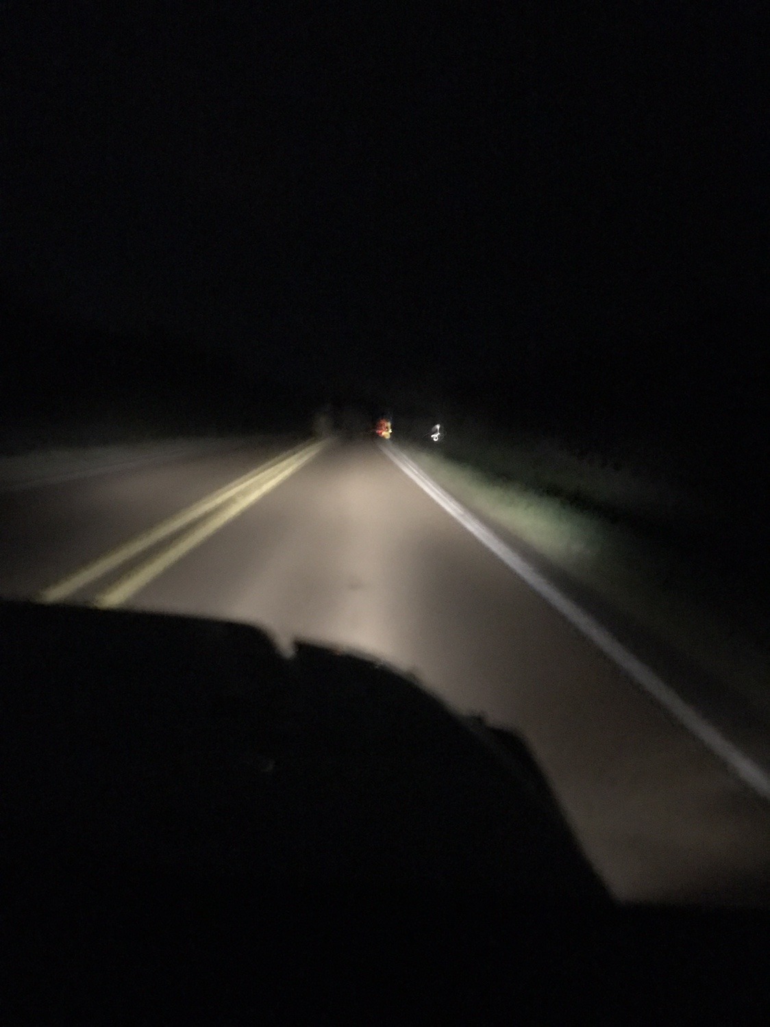

I don't understand the issues with regular lights. Mine look ok I think. What am I missing?
Low beams
High beams
Low beams
High beams
I thought the same thing until I saw the difference first hand. You just have such a brighter light, a whiter light and a lot more peripheral light, in fact, I'll be removing my aux lighting since it's no longer needed.

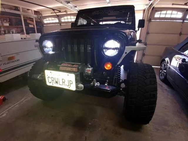

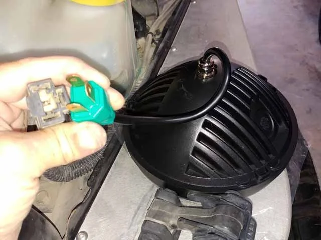

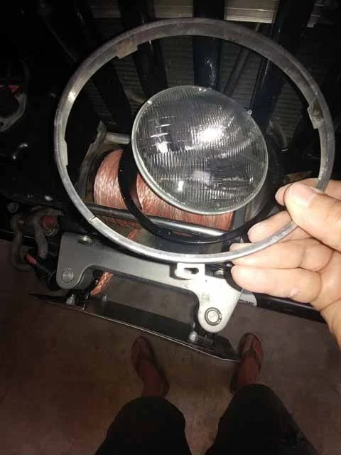

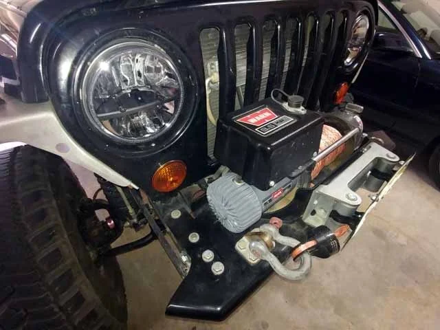

Thank you CodaMan, I received them today and they're installed. It probably took longer to get the packaging opened and the lights out than it did to install them.
The only tool you need is this, a T-15 torx with a long skinny shaft on it to reach the screws. No other tools are needed.
As CodaMan said, they're literally plug and play.
There are 3 screws that hold the bezel in, remove them. Once the bezel is gone, look for the four standard screws with the T-15 heads on them that hold the below ring on which is what holds the headlight in place. The part you don't want to mess up are to remove only those four T-15 screws. There are several headlight aiming adjustment screws that are also in there that you don't want to accidentally unscrew. If you don't touch the adjustment screws, the new LED headlights should be aimed very close if not right on once you get them screwed into place. I'll see how close mine are tonight once it gets dark.
