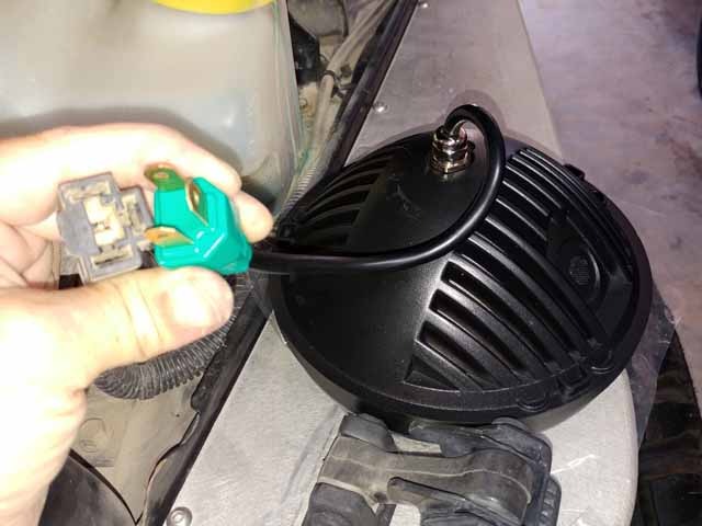

Though for LED headlights like we're talking about above, you don't need to add a wiring harness. They are plug and play, they plug into the OE wiring harness with no modifications needed anywyere. And because LED headlights draw so much less power than the OE headlights did, no relay is needed either.

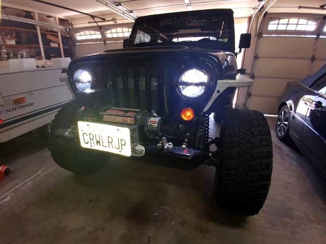

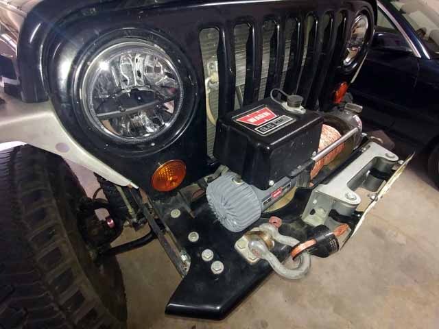

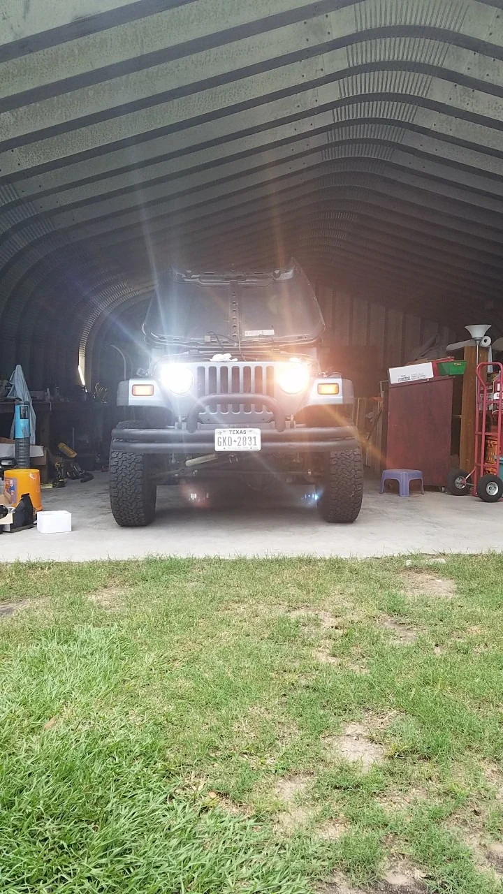

Thank you CodaMan, I received them today and they're installed. It probably took longer to get the packaging opened and the lights out than it did to install them.

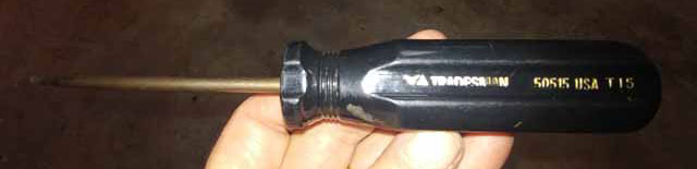

The only tool you need is this, a T-15 torx with a long skinny shaft on it to reach the screws. No other tools are needed.
As CodaMan said, they're literally plug and play.

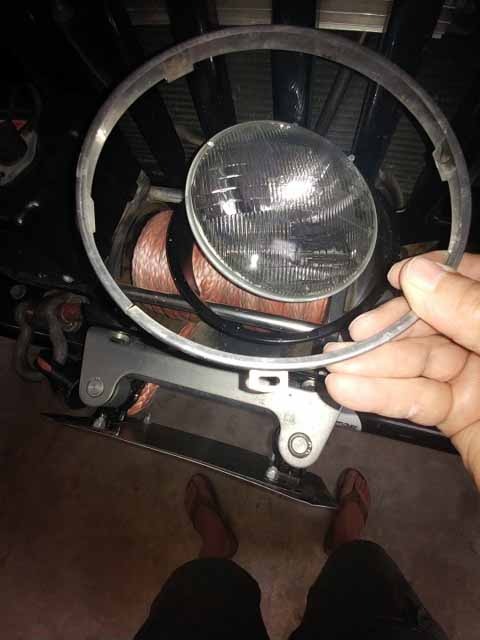

There are 3 screws that hold the bezel in, remove them. Once the bezel is gone, look for the four standard screws with the T-15 heads on them that hold the below ring on which is what holds the headlight in place. The part you don't want to mess up are to remove only those four T-15 screws. There are several headlight aiming adjustment screws that are also in there that you don't want to accidentally unscrew. If you don't touch the adjustment screws, the new LED headlights should be aimed very close if not right on once you get them screwed into place. I'll see how close mine are tonight once it gets dark.

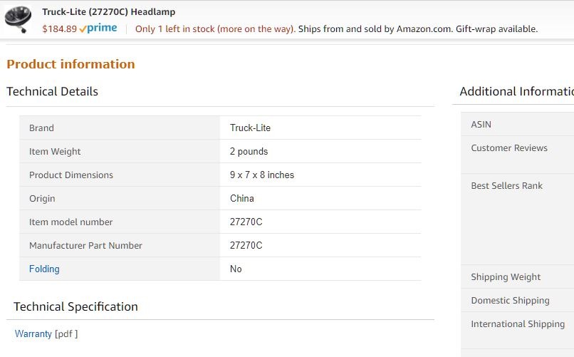

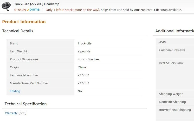

Don't be so sure, Truck-Lite's 27270C is the model that is used in our Jeeps and it's made in China.
Im concerned that you are not understanding my point. Did you even read the post? My major point was counterfeiting and ripping off reputable companies (Truck-lite) that build and design new innovative products for our TJ's/LJ's.
While I am not sure if I would put all my stock in what that Amazon screenshot shows. I can understand why one would.
But what would the difference be if I showed a reputable website (http://www.truck-lite.com/content/about/locations) that stated they design, engineer, and manufacture in the USA? What would make your screen shot more correct than one of mine that countered yours?
Like Chris said it becomes "political," talk. As we have no definitive proof of what or if manufacturering happens in China for Truck lite.
The Truck-lite website list thier manufacturing plants on their website,(http://www.truck-lite.com/content/about/locations) which never mentions China. And then there is your amazon screenshot that counters their website and states it's origin is, China. Not sure why one would hold more weight in truthfullness than the other.
While this does not rule out the fact some of their stuff COULD be made or sourced in China. Posting a screenshot? I like to believe the Truck Lite/Rigid website is truthful. But like anyone I don't just trust, I like to VERIFY. I admit that would be hard to do for a lot of products. Search TruckLite China and you will find plenty of "TruckLite," LED's, real cheap. That doesn't mean they are orginal and true. I'm not sure anyone can say 100% that Truck Lite is not manufactured in the USA. A statement like that is spreading a rumor. Walk into their Penn plant.
