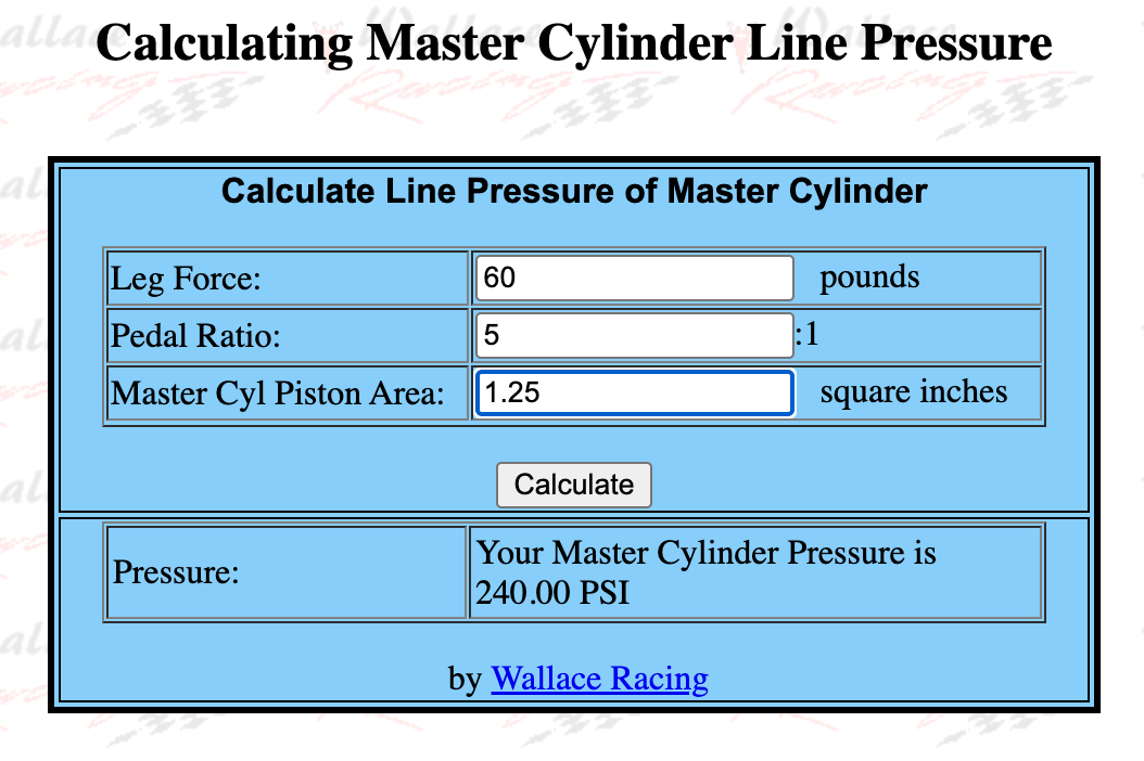

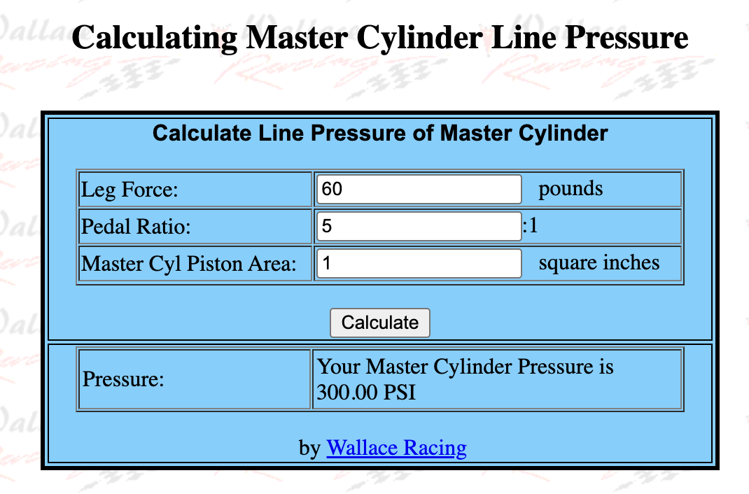

There is something wrong with the one from Wallace. There is no way a 50% increase in piston area only reduces the line pressure by 60 psi.
Please correct me if the following info is wrong for determining brake line pressure.
1" bore master cylinder (area = 0.785375)
60 psi pedal force
5:1 pedal force ratio
—> 60 * 5 / .785375 = 381.9831 (rounded down)
1.25" bore master cylinder (area = 1.22714844)
60 psi pedal force
—> 60 * 5 / 1.22714844 = 244.4692 (rounded down)
_ _
244.4692 * 1.5 = 366.7038, which means a MC with 1" bore provides more than a 50% increase in brake pressure than a MC with 1.25" bore.
