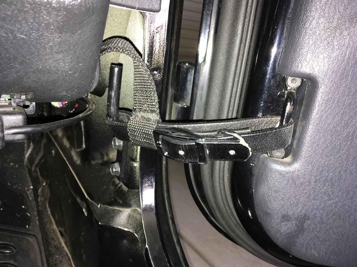

Replacement door straps that can be installed without taking off metal door bracket
I use small dog collars, you can adjust them so the door opens as far as you want. I've had these on my TJ for several years. You can see the original strap, I've threaded the dog collars through them, just so I know where they are if I ever need them again.
You can use paracord loop. Pass it through the door opening and then over the body post.
