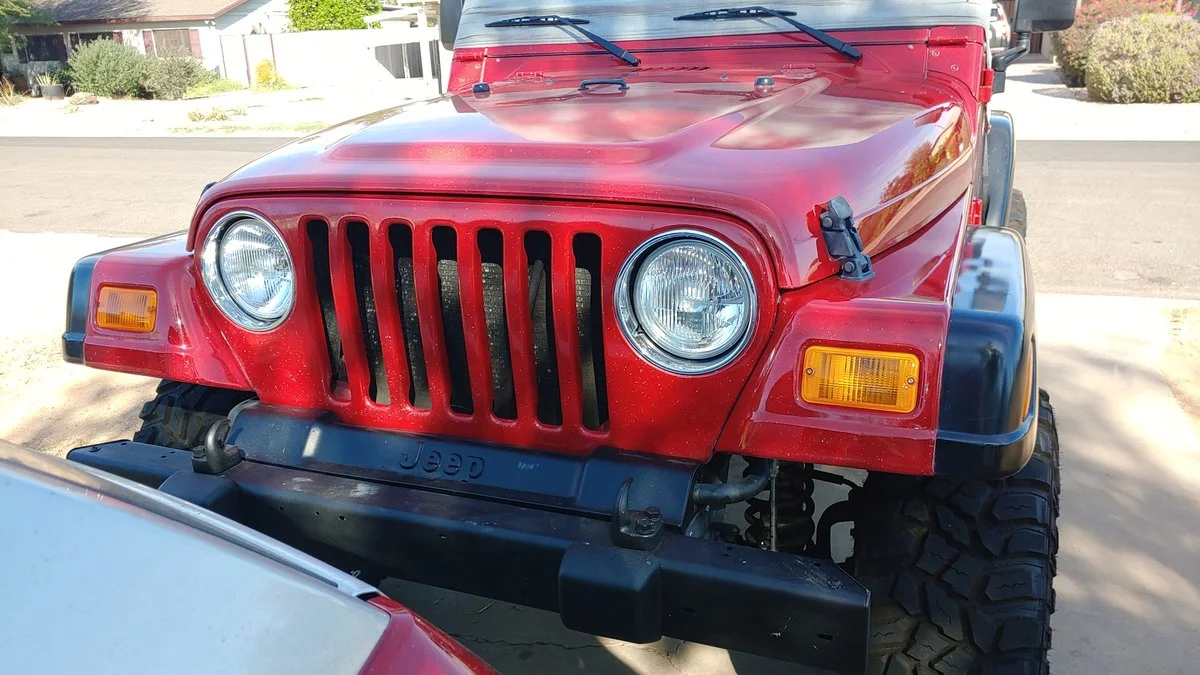

I just went outside and took a quick pic so you can judge for yourself, but they look pretty much stock to me and is the reason I choose them. I don't like the funky looking LED's.

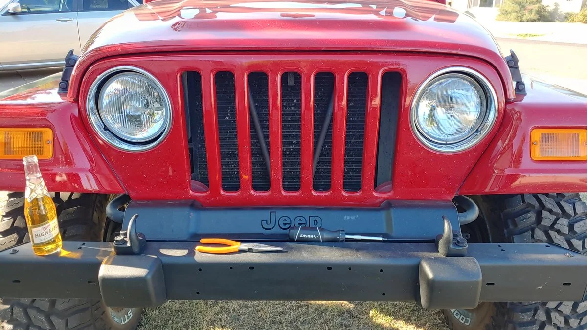

Here is another pic I took while installing them so you can compare them side by side. Hella E-code on the left (passenger side) and stock light on the right.
They look great. We share the same taste. I could never get into the plastic LED look.

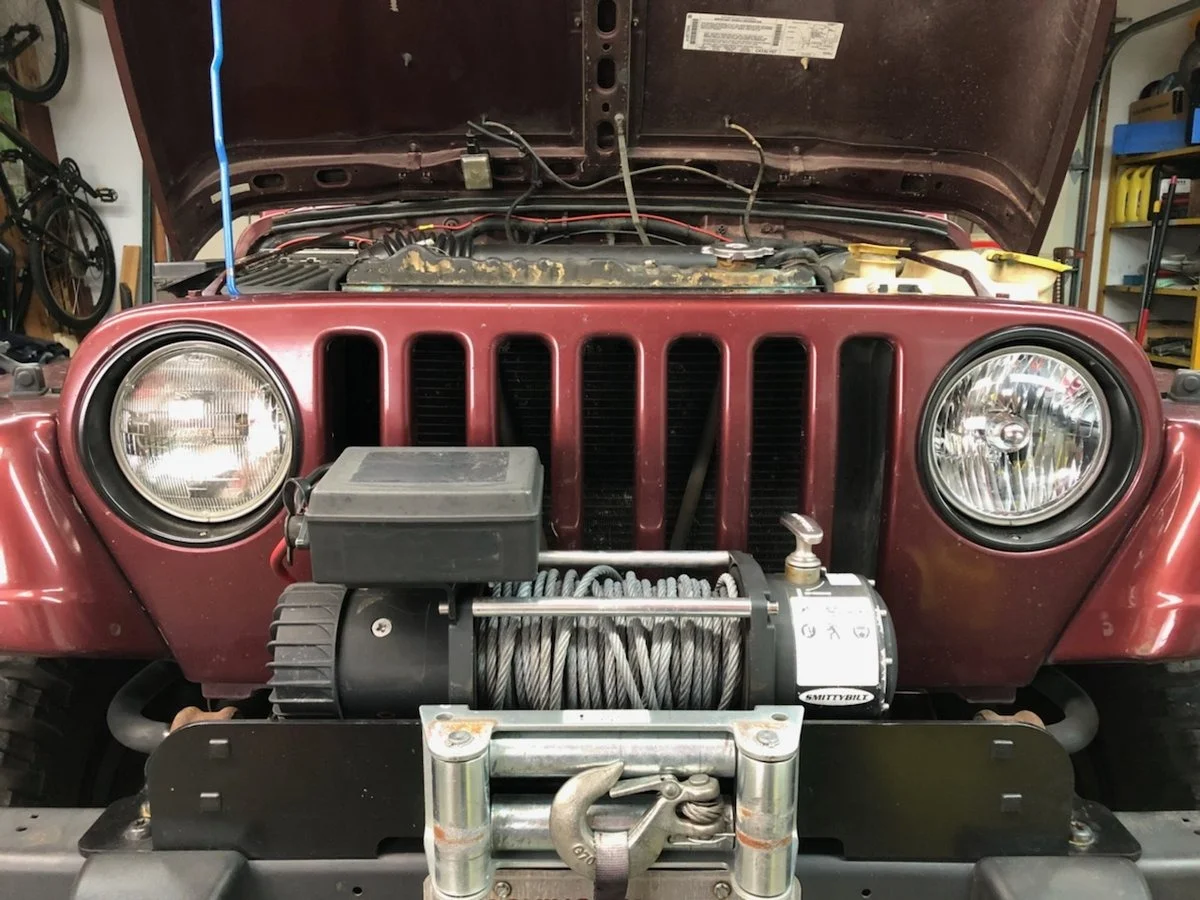

Original sealed beam on the left, JK housing on the right.

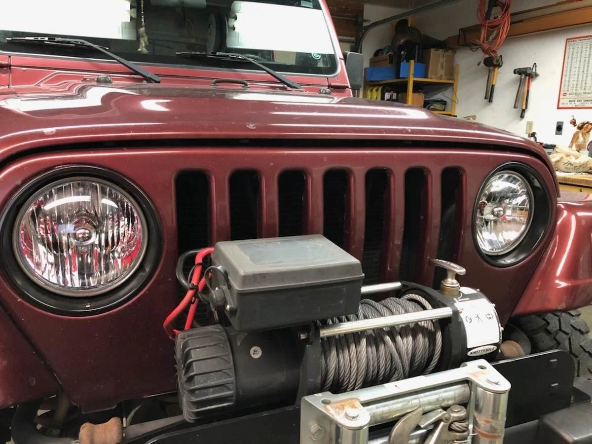

And below is with both JK housings in.
