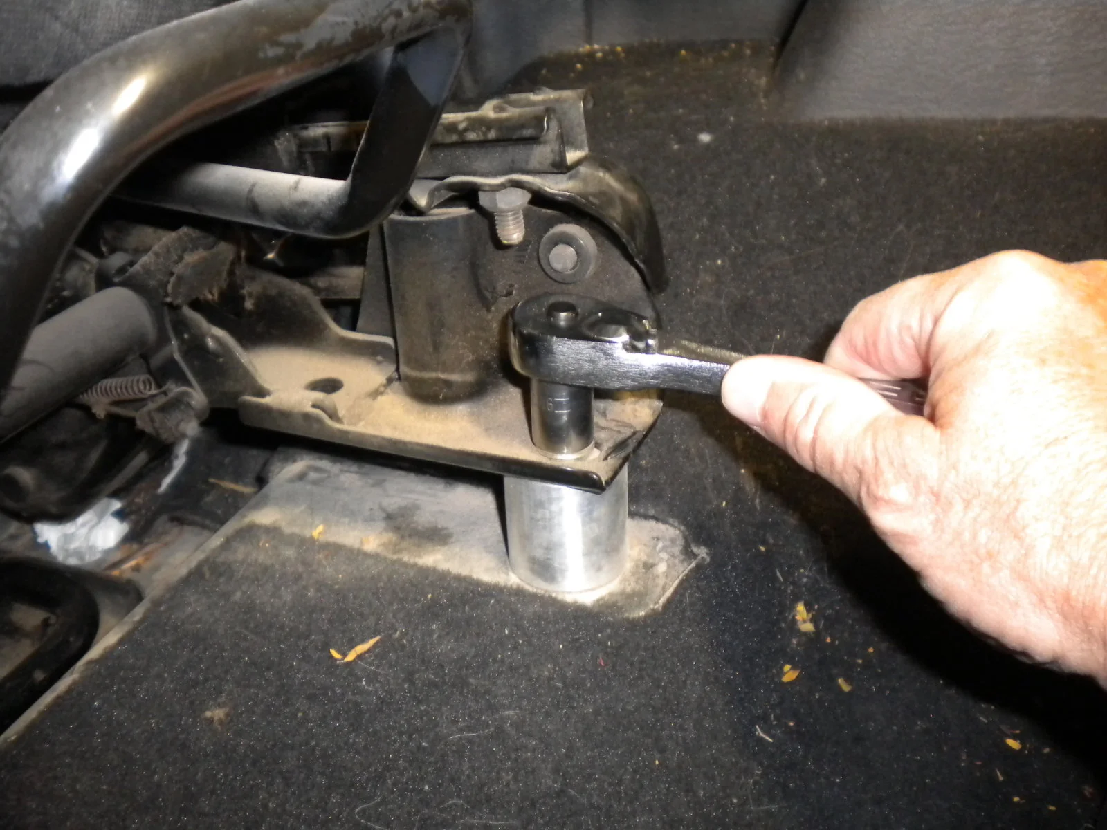

My PRP seats with their taller seat bolsters raised the 'entry' height over where it used to be for me to get in with the previous OE seats. I definitely sit higher with my PRC seats with the seat base spacers than I did with my OE seats did with the same seat base spacers installed.
I'm thinking/hoping removing my aftermarket seat spacers will lower my PRP seat height to more like your OE seat height and like my factory seats with the spacers used to be. Sometimes I struggle to get my legs and butt in between the steering wheel and PRP seats with the seat base spacers. This is the case with pretty much any suspension seat with higher bolsters designed to secure you in the seat more.
You can see the spacers I intend to remove here...

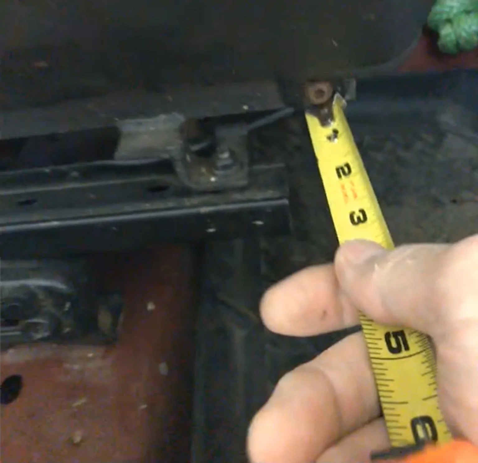

figured out why some people have issues with the height of Corbeau seats, and it’s the way they mount to the adapter bracket. My father has the Baja XP mounted to the drivers side in his ‘99 with an adapter bracket to his fold and tumble mount and the height has never been an issue when I drive it. The base on that seat is 5” (vs 4.5” on the Sport seat). The adapter bracket for that seat only increases height by about 1/2” because it bolts flush to the bottom of the seat through a flat adapter bracket.
His passenger seat is the Baja SS, which mounts via tabs on the sides and requires an adapter bracket like the one above, but the horizontal flat stock shown above is on edge, adding additional height. This is a crappy picture of the adapter bracket, but it was taken with my iPad during our FaceTime. You can see the tabs coming down from the seat, and why the adapter bracket ends up increasing the height.
Additionally, when I got back into town I measured my seat base and it’s actually 6” thick (with a 7” front bolster) vs 4.5” for the Corbeau.
So in closing, it should work out fine just like Jerry said above. :)

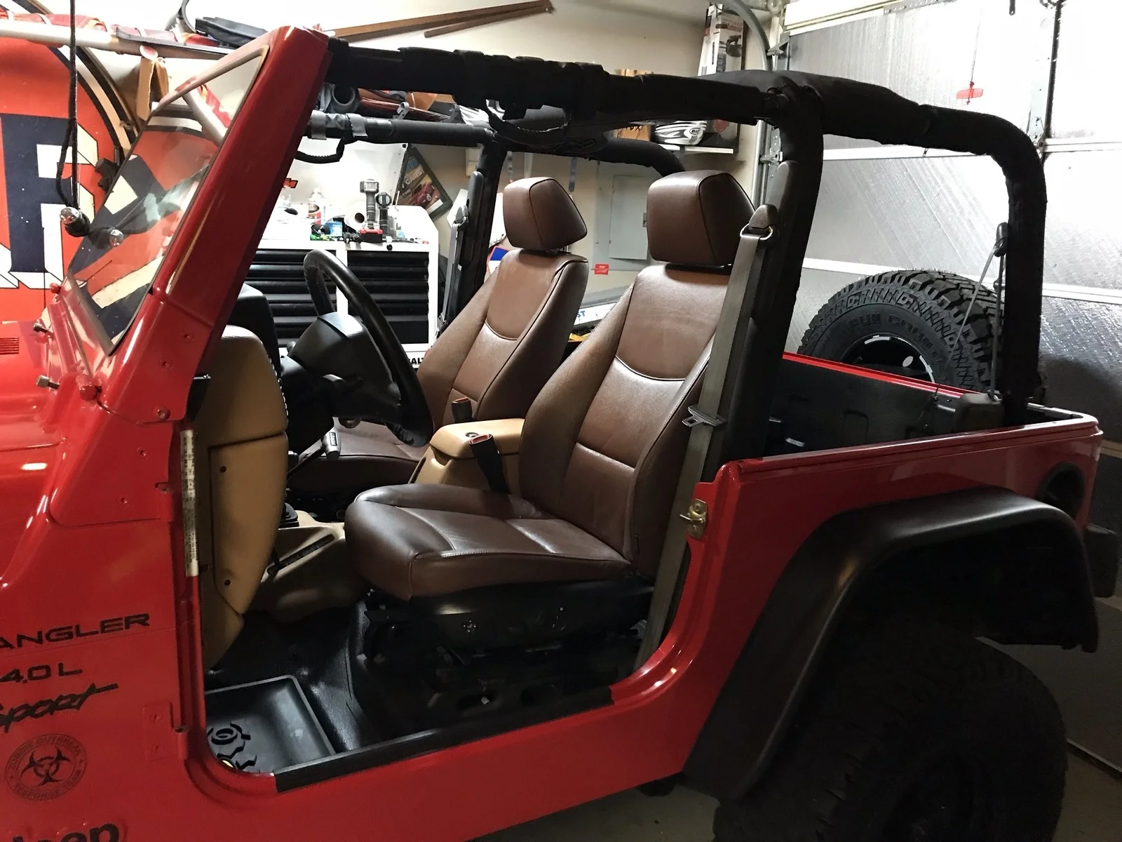

I just finished installing BWM E90 seats- brown leather. Always thought BMWs had one of the most comfortable seats. $300 on Craigslist. Another $75!in metal and supplies to mount them up. Had to fab a plate and retained the tumble forward pass seat plus all the functions of the BMW seat.
Wow those look awesome, love leather seats!!
Those look really comfy. They also look fantastic.
