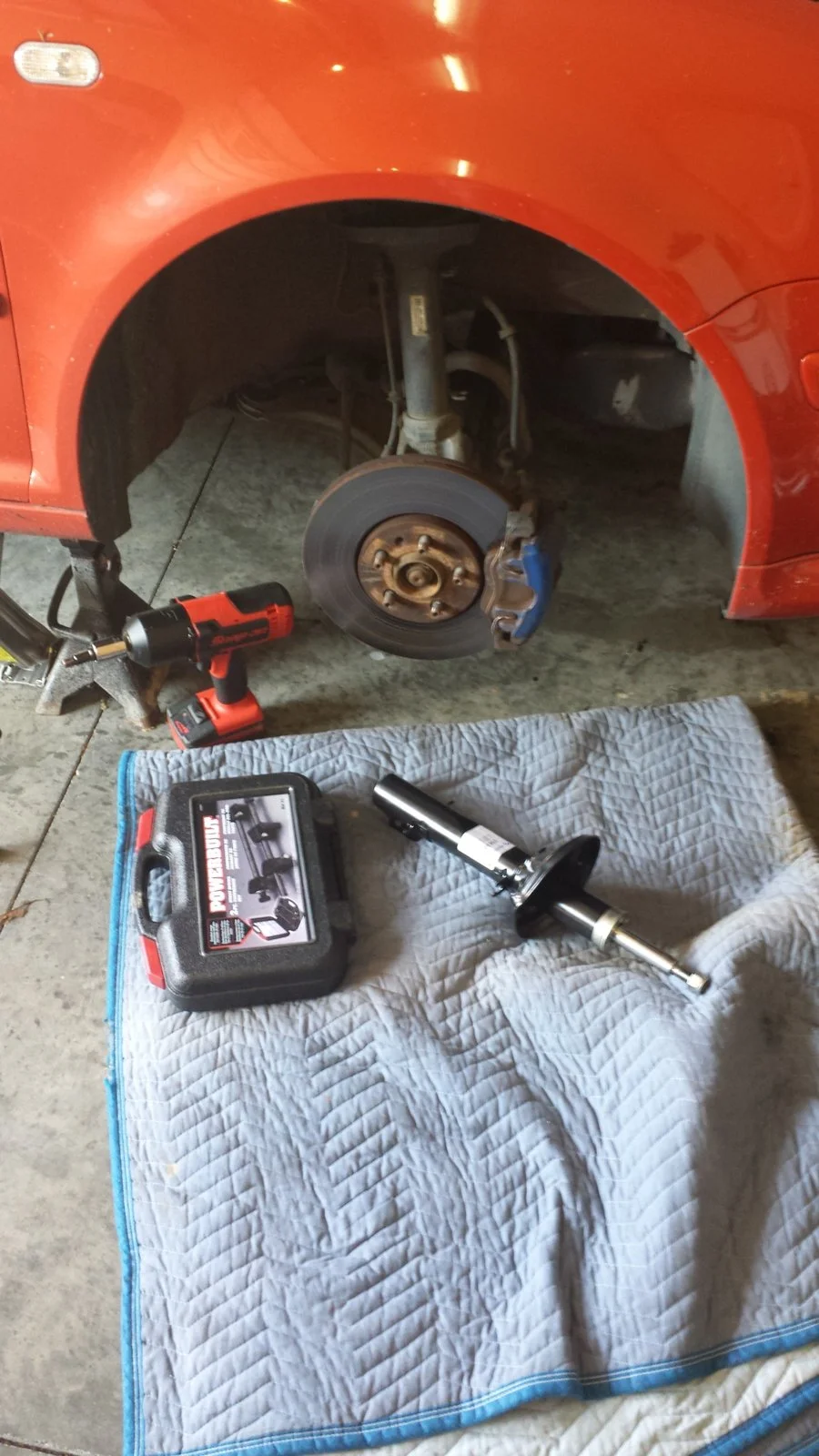

Struts were shot in my boys GTI, so we replaced those a couple of months ago....borrowed the spring compressor from Advance Auto and mucked with all that jazz.
The car was my best friends BEFORE it was my sons. My buddy bought it new and put 2" Eibach lowering springs on it and a slight body kit so it's not that easy to get a jack under or lift in any way.....and here I am use to trucks, 4x4's, SUV's...so yeah...that was a nightmare (for me) to deal with all that suspension crap so low to the ground.
