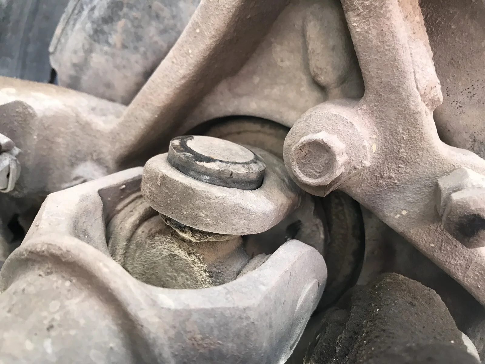

I had a lucky catch on a axle ujoint which had lost a keeper. We were in the San Juans when I found it. I tapped the protruding cup down and got back to the campground. I installed a keeper from an off brand ujoint. That got the Rubicon home to Arkansas with frequent inspections.

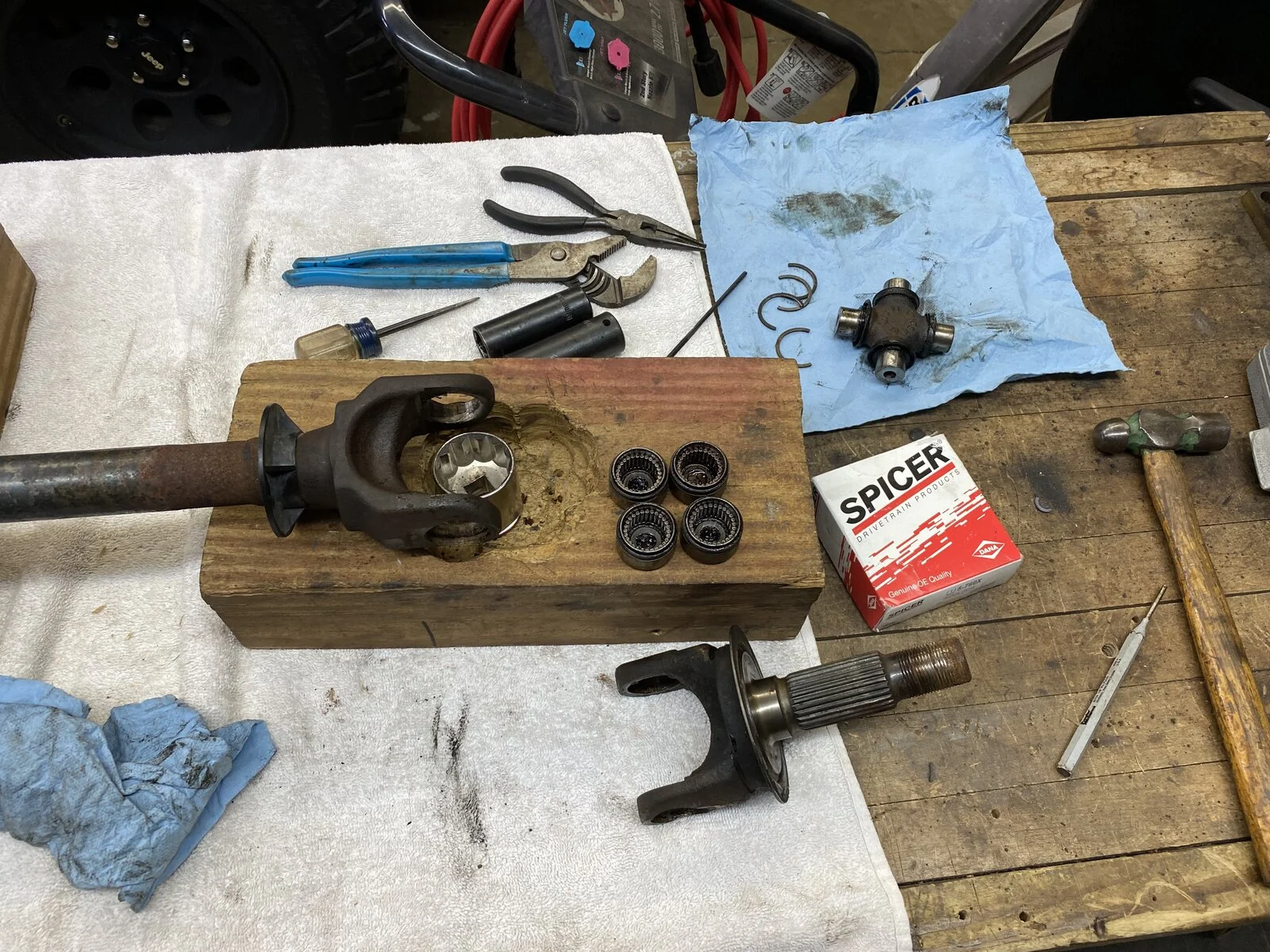

I am preparing to pull both front axles for new spicer ujoints. I will check the ball joints, suspension and steering. What should I consider replacing with those axles out?

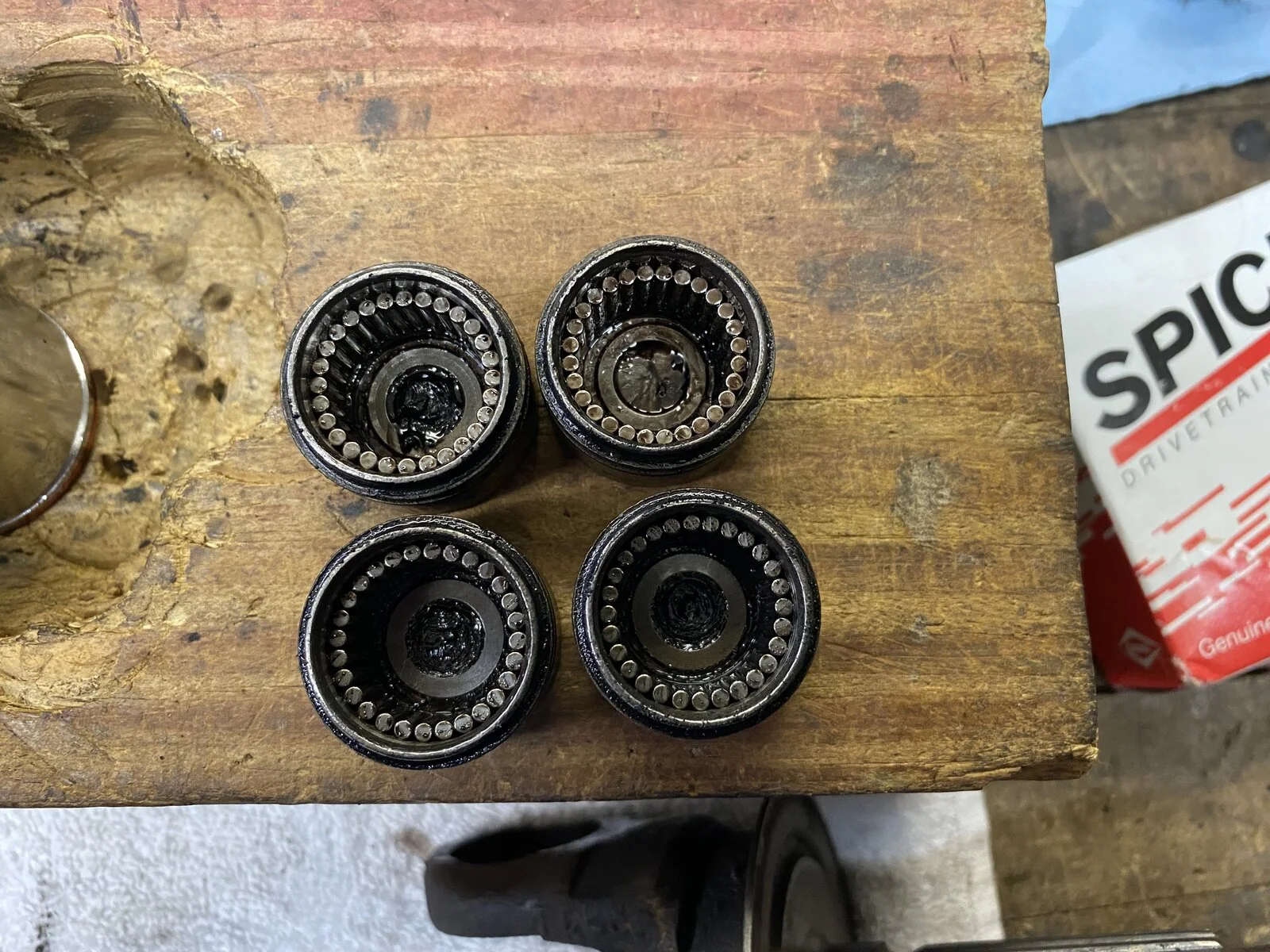

I thought I had an axle U-joint going out. Popping sound while turning. (Turned out to be my engine skid had loosened up where it mates to the transfer case skid. 🤦‍♂️) Anyway, the point of this post is that I had 125,000 miles on these original (I'm assuming) U-joints, so at 65,000, you may not need them. These are the driver's side, but both sides looked the same. For the record, I'm not upset that I replaced them though, my Jeep is getting more off-road time now than it used to.
View attachment 292495View attachment 292494
I do not trust the one I caught at all. I felt fortunate to get it home.
