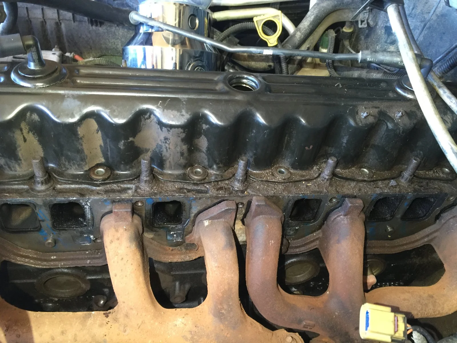

I am replacing the head gasket on my 2002 Sahara. It has 130,000 and has run strong up until a traffic overheat and now a misfire in cyl. 1 w/ code. I changed plugs, O2 sensors and checked coil rail and injectors. I cleaned the engine, ran it a couple of days, and checked and noticed a seep leak on the engine case on passenger side cyl. 1. I also have the intermittent strong smell of gasoline and steaming coolant at various times under load.
I have rebuilt engines before, but never on a jeep, so I am asking this forum for help in anticipating any bumps in the road or other things I should be looking at while I have the engine opened. Also, not sure what the PO did, so I was wondering how to identify if this head is the infamous crack prone 0331 or if it has been replaced.
My plan is to purchase the Fel-Pro gasket kit, the head bolts, thermostat and the exhaust gaskets. I pulled the valve cover and injectors off and the rockers and springs look good.

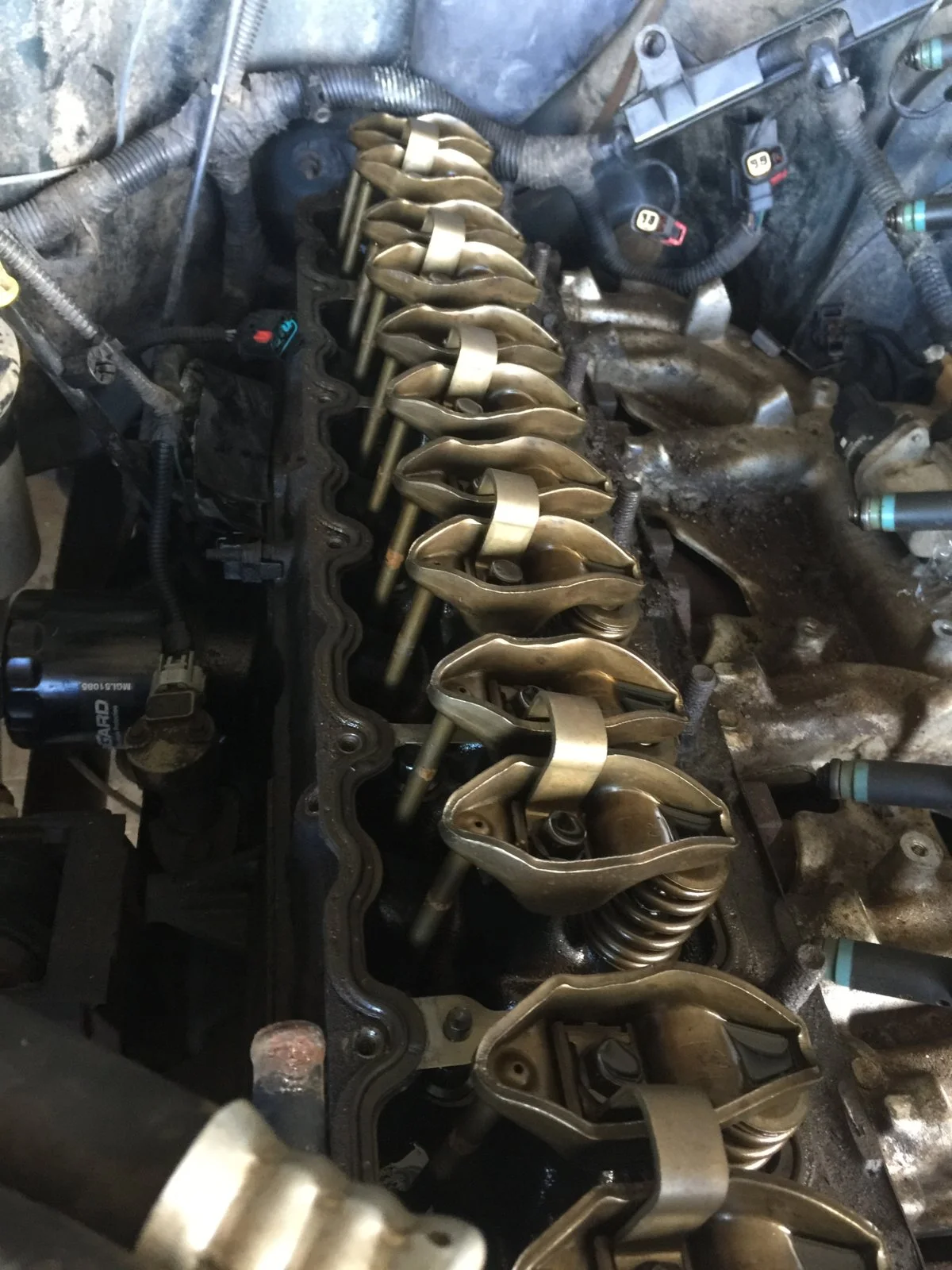

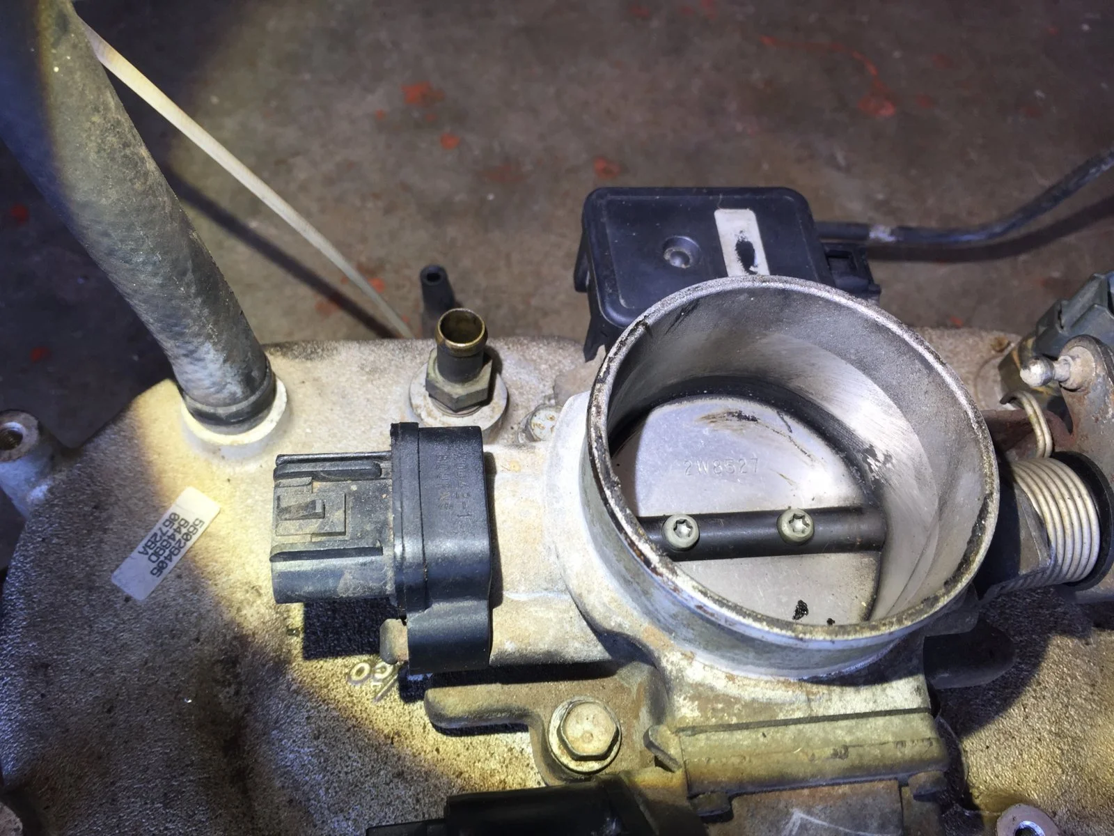

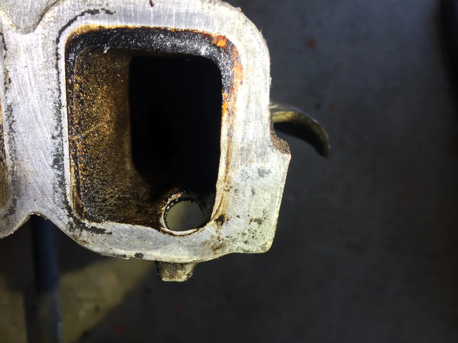

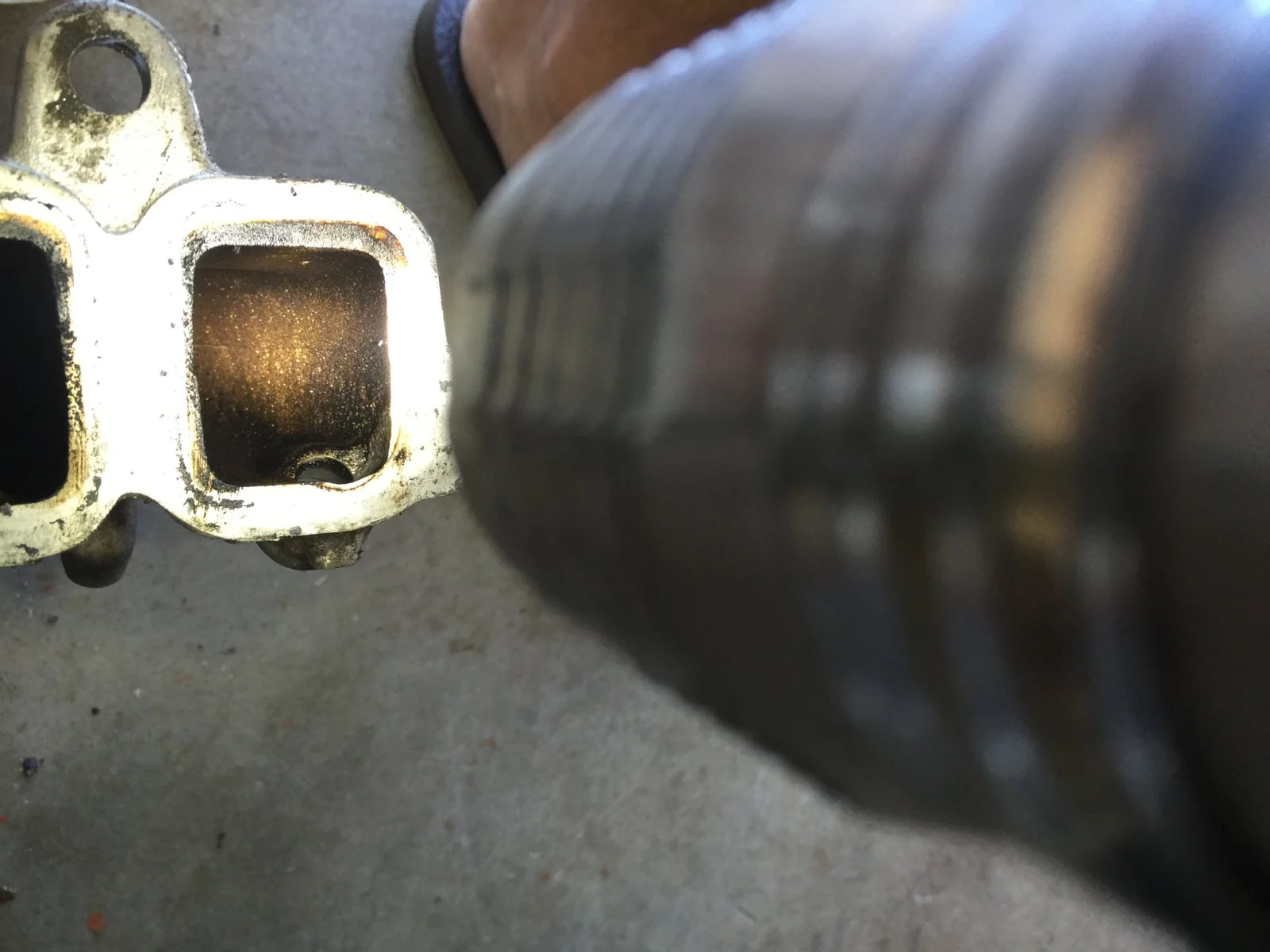

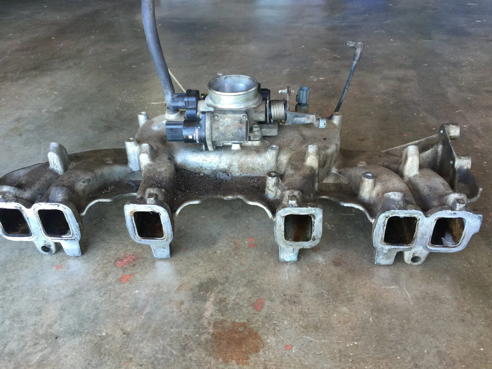

Quick update. Been slowly and methodically taking the top of this engine apart. Here are some pics. Any comments are greatly appreciated.
So the first set of pics is the intake. Looks so grimy. When I bought the car it had the stock air box, and I have not changed it. Why is there so much crap getting in there? Bad gas?
had to continue on another post to ad more pics.

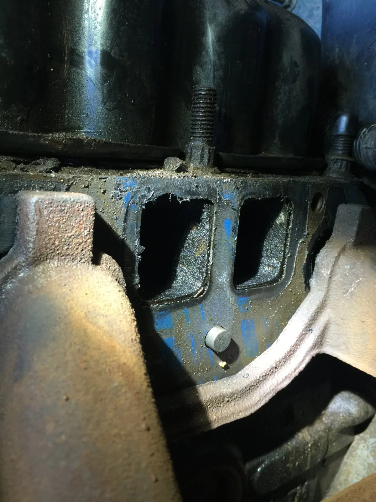

These pics are of the ports. Cyl. 1 is the misfire port.
So, what brand cleaning product should I use to remove all the junk off the intake?

The grimy-ness, is just carbon. It looks nasty but it'll happen over time, regardless of what air intake or filter you have. That's why we have to periodically clean out the IAC valve to get our Jeeps to idle normal once they get dirty with carbon. You can get a good amount of that gone by using throttle body cleaner. 3M supposedly makes a great throttle body cleaner called "system intake cleaner" but I haven't found it by itself anywhere, at any of the different parts stores I've looked at or Amazon without it being in a kit that requires a special spray nozzle. I just use CRC from O'Reilly and it seems to work reasonably well.
Due to how dirty everything is, I would take off your IAC ( the sensor on the throttle body at the very bottom of the picture of your throttle body, it's cropped out of the pic) and take it off and give it a good cleaning (with throttle body cleaner) and also clean out the inside of the IAC housing inside the hope throttle body cleaner and an old tooth brush or whatever you can get in there to scrub it clean. Probably wouldn't hurt at least.

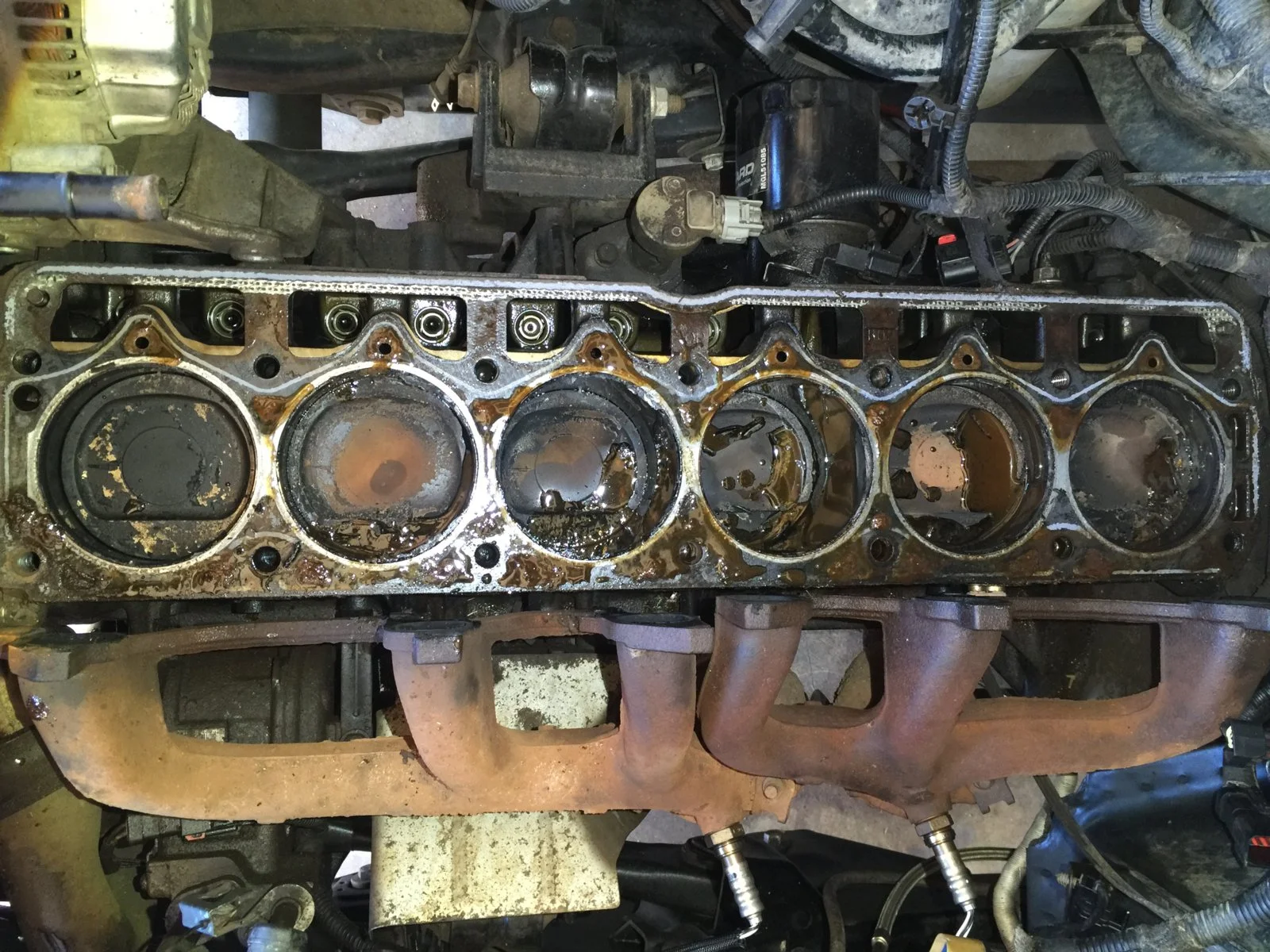

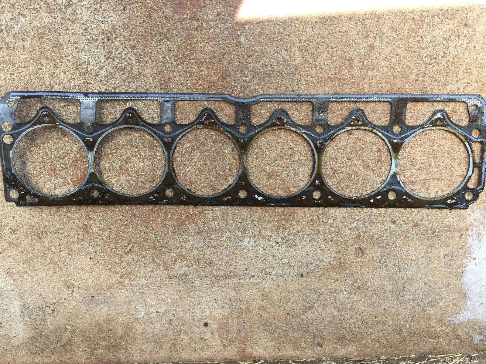

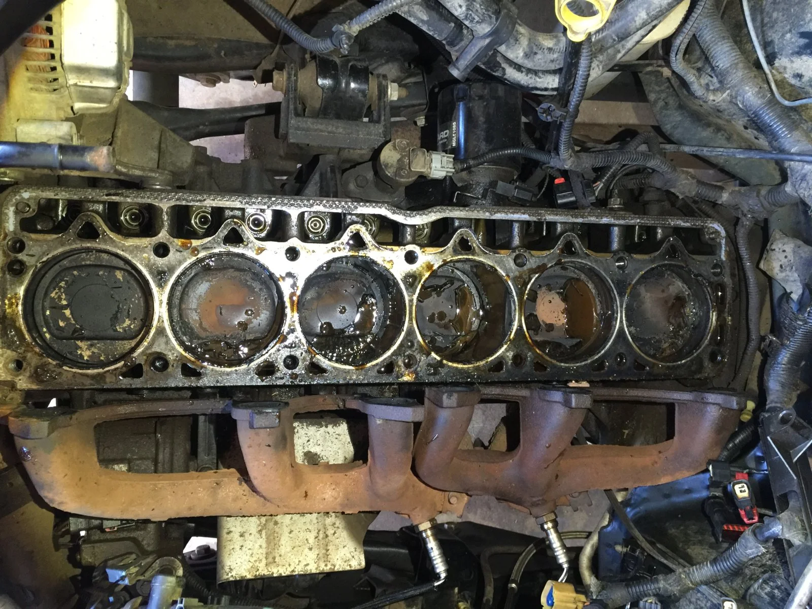

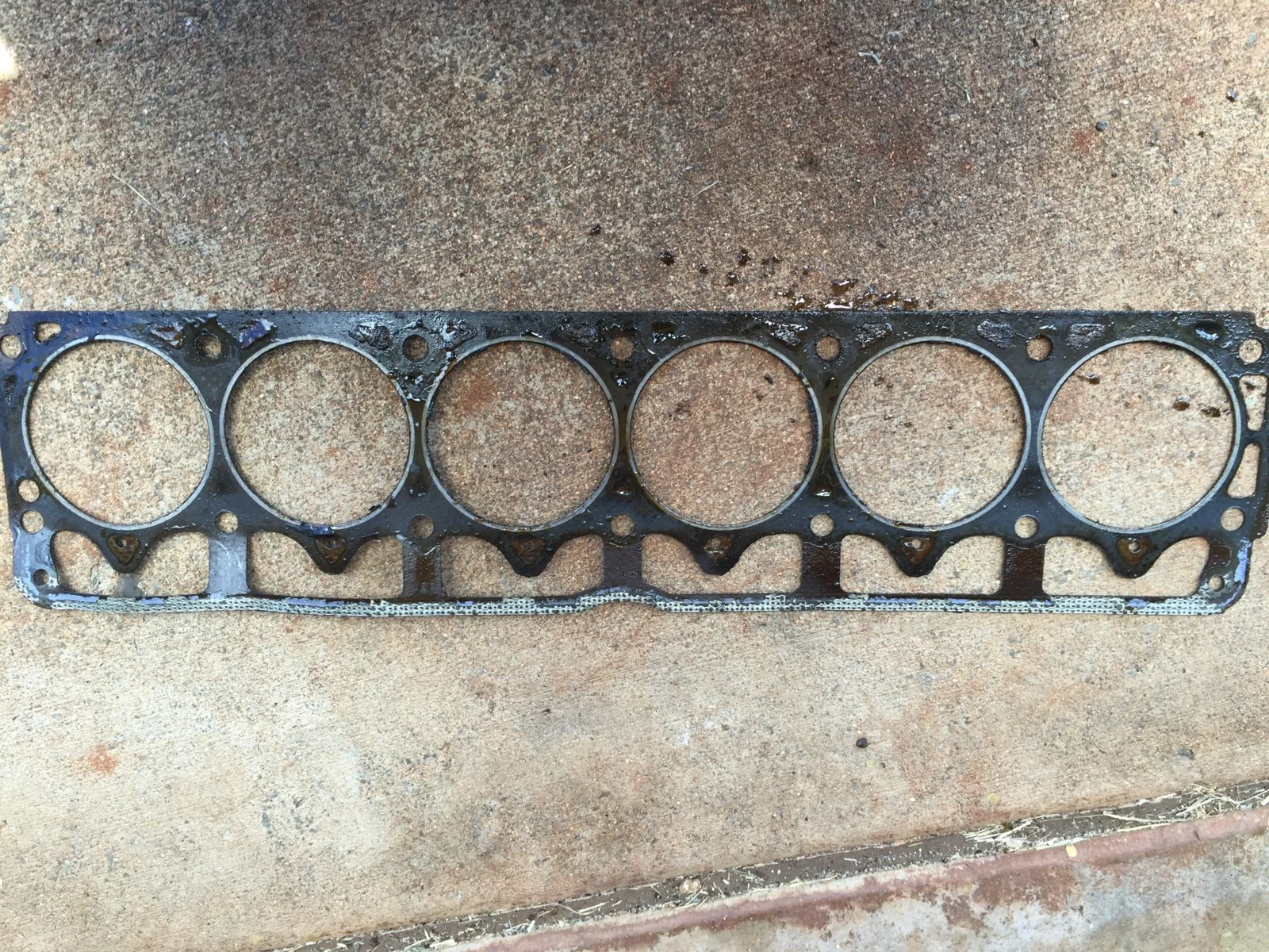

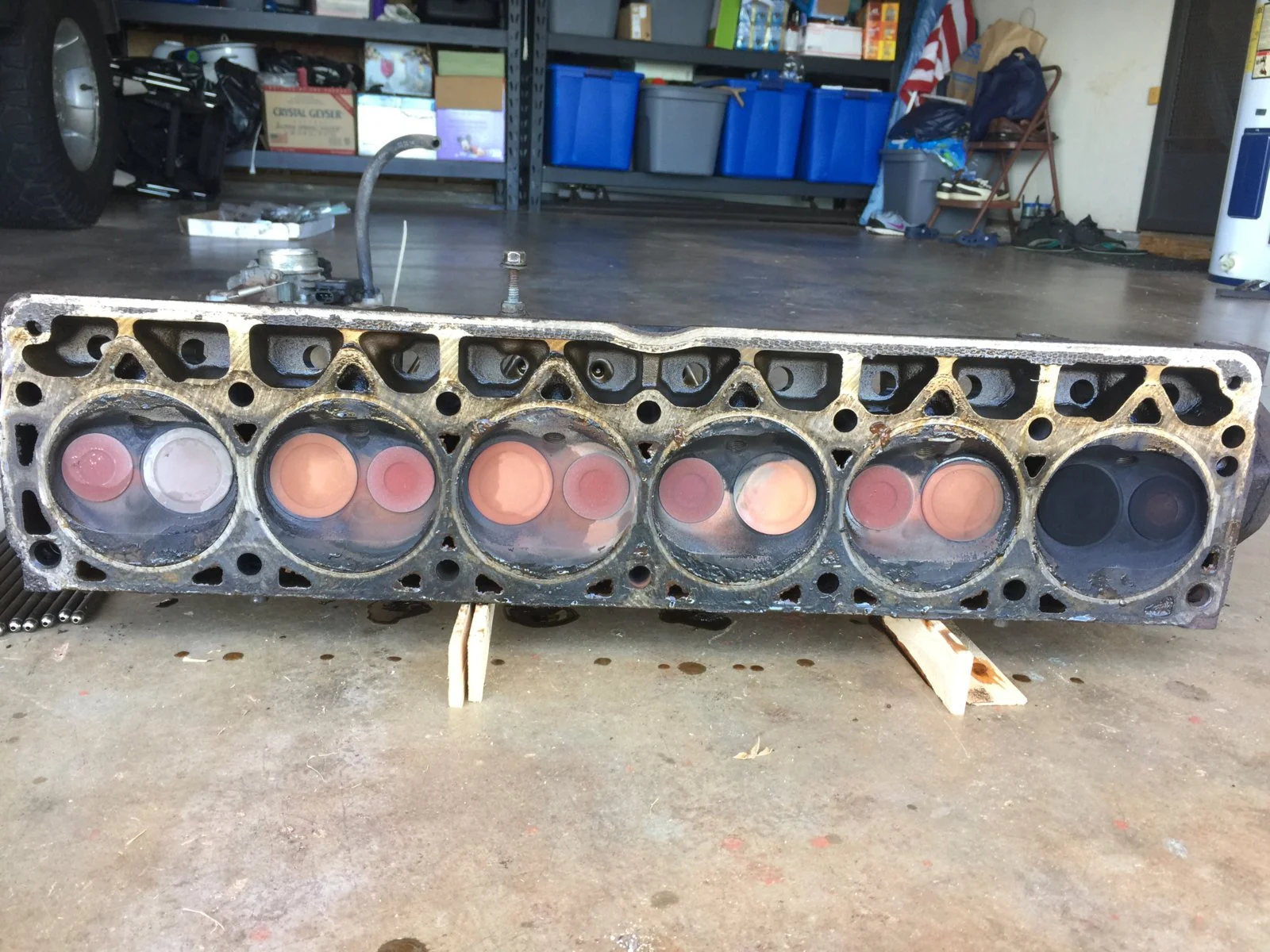

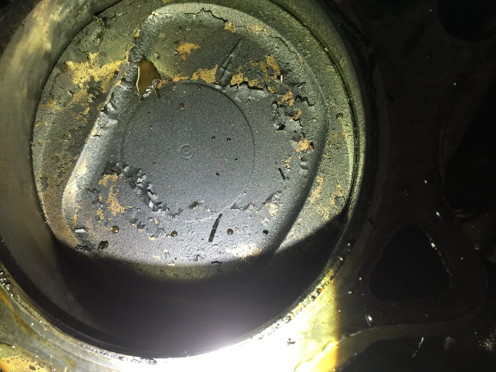

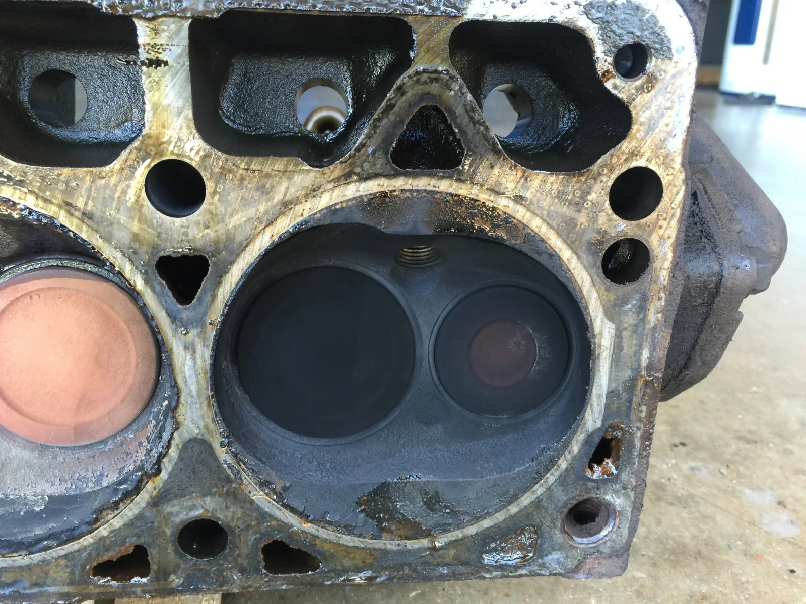

OK. Head is off. Below are the pics. All that liquid on the deck (coolant, it seems) was internal. The outside of the engine was dry. The liquid got shook-out of the head as I was pulling it out.
I took a photo of the valves. When you experienced guys see that, what's your reaction? The spark plugs, I should have taken a photo, looked brand new except for the one. The plug was just as black as the valves.
Interestingly, or maybe not to you all, the top of the piston of the corresponding cylinder didn't have any more carbon build up than the other five, but the valves were distinctly different. Is there an explanation for that?

not sure why nobody replied and I know it's long past but for anyone who stumbles across this thread in the future, it looks like you had coolant leaking into all cylinders except the one. (the black one)
