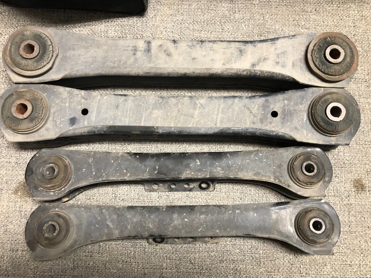

Looking for tips to replace these components myself on a stock 2005 LJ (53,000 miles). Did some research and it seems pretty straightforward (4 arms, 2 bolts each, mind the e-brake cables). Also looks like you can just do this on the ground. But it appears there's one tricky bit: the axle is likely to shift enough to make it difficult to get the second bolt in for each control arm. The two suggestions to address this were:
- Use a ratchet strap to pull it back into place
- Use a "porta-power" ... no idea what this ... to pull/push it back into place
Questions:
- Couldn't you just put a couple of straps on the axle to begin with to keep it from shifting in the first place?
- Any other tips to make sure this goes smoothly? (is thread lock or anti-seize recommended, easier done on jacks with the wheels off, etc.)
Background:
Bad clunk when going from forward<->reverse. The right rear upper control arm bushing is shot, all the rest are cracking, but otherwise fine. Local shop quoted $450 to replace the upper and lower passenger side rear control arms. I'd prefer to do both sides ($900). Found a new set of 4 for less than $100. Though new to vehicle DIY, I've already replaced the shocks, drag link, tie rod and all sway bar end links. Some swearing was involved. I found enough YouTube videos to understand these other repairs pretty well before tackling them. When it comes to stock rear control arms, the resources are sparse and are mostly composed of "how to install adjustable control arms" and only focus on setting the length.

UPDATE
Thanks to all that provided suggestions. This went very smoothly. This LJ spent its entire life in sunny SoCal, so removing bolts was a breeze.
There was zero axle shift for the upper control arms (CA). The first lower CA shifted quite a bit and lifting the bumper didn't help in my case. A ratchet strap got it close enough to screw the bolt in. On the second lower CA, I added the ratchet strap first and the axle held in place... so well, in fact, that the bolt went straight in.
The only thing I wasn't entirely sure about was the bolts on the axle side of the upper control arms. When I tried to take them out, the springs blocked them. I was able to use a mallet and screwdriver to coax the bolt head over and past the spring, but it didn't seem like I'd be able to put them back in while trying to line up the CA. After inspecting the CA mount, it doesn't appear that it matters if the bolt is on the inside (stock) or outside (easier to install without lifting the Jeep and removing the wheel). I went with the easy route.
They haven't fallen off yet, but I'll post a warning if they do. :cool:
Another note: I replaced these while trying to chase down a "clunk" in the rear passenger side. It only happens once after changing from forward<->reverse and then applying the brakes with some gusto. The CAs looked a little cracked, but didn't really feel too loose. A local shop claimed that the upper CA was "torn up". Pulled them all out and they look just fine. BUT, the clunk is STILL THERE! 😖 Still happy I did the replacement, but a little bummed that I can't trust the shop anymore. Very happy I did the job myself for $100, instead of paying them $900-1,000...
